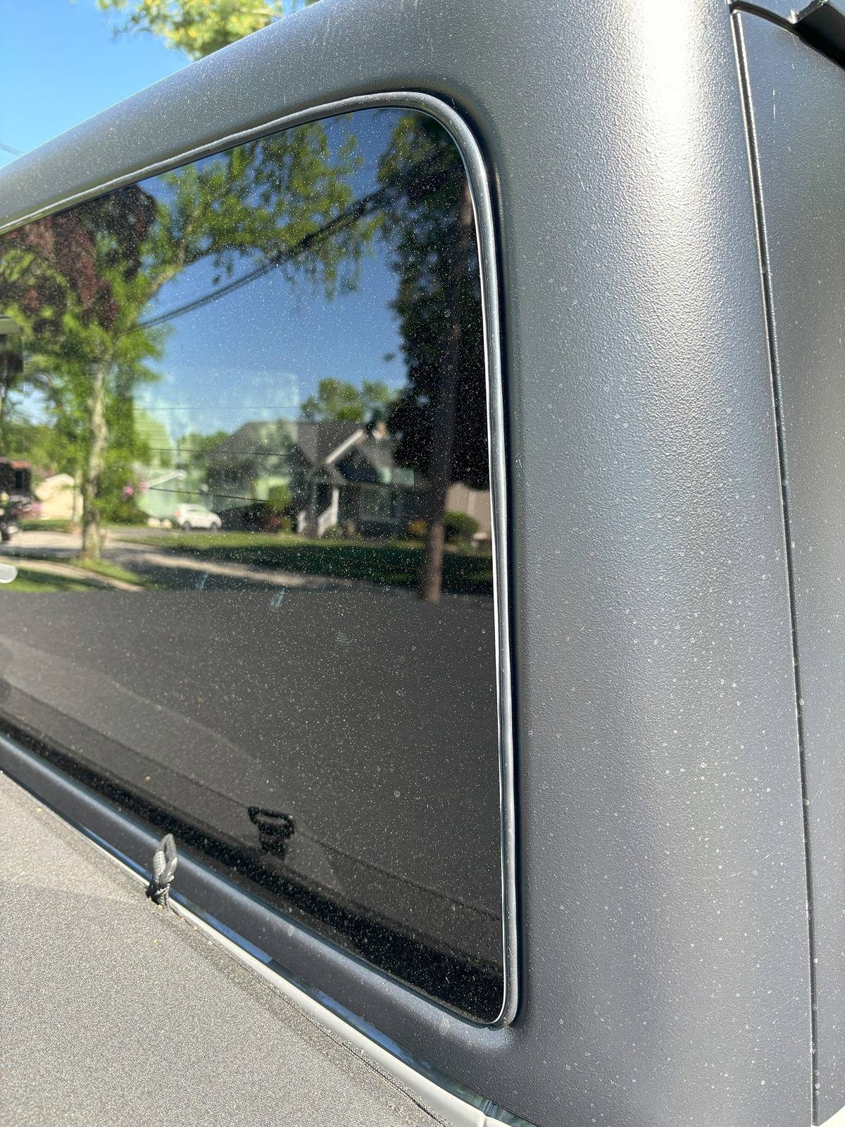

Mine started leaking at around 6k miles and after reading all of the horror stories there was only one option for me and that was DIY. No way I was having them break the glass or eff up my hardtop.
Bought the exact same stuff in this post:
https://www.jeepgladiatorforum.com/...e-their-top-scratched-seats-ripped-etc.66403/
Did it myself in about 20 min. I didn't use any kind of special tools, did it by hand with some water/alcohol spray as lube and it honestly couldn't have been easier to do.
Over a year later and another 5k miles - Fix is still good as new, stuff has not moved and never had another leak. I'll replace as needed going forward and couldn't be happier (well I could be happier since it shouldn't be leaking in the first place.:))

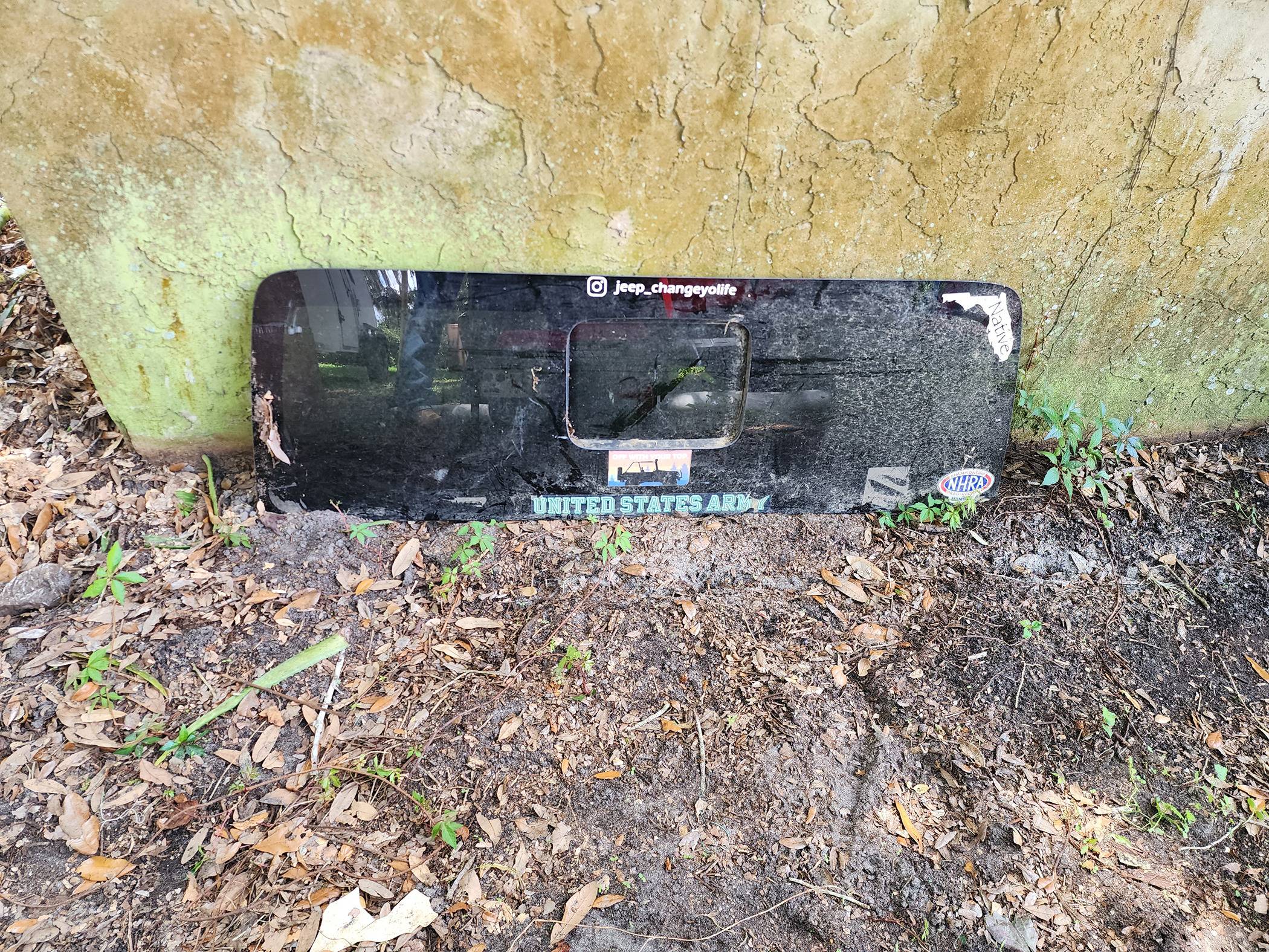

A good installer can remove the rear window without shattering it. I had my rear window replaced about a year and a half ago in San Antonio, TX. I had it replaced with a Breezer one piece removable window. Nothing was wrong with it, I just wanted something different.
The installer removed mine without damage. I still have it. Fully intact. Dirty as hell from sitting outside though. šŸ˜‚ šŸ˜‚

I can't speak for any other company anywhere else, but East End Glass Company in San Antonio, TX can remove it without damaging it.
