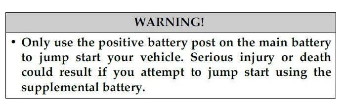

No it is not the normal routine. Owners manual actually gives a serious injury or death warning and advises against jumping off the Aux battery which the N1 cable goes directly to.

There is a thread on the JL side that references putting a jumper wire between the main battery + and N1 and then jump from the main battery. This eliminates the risk of jumping purely off the aux battery and N1 only.
https://www.jlwranglerforums.com/forum/threads/ess-jumpstarting-main-battery-vs-n1-terminal.87726/
Edit: This is another reason why I did my aux battery delete mod. That extra battery adds this layer of complication for what should be a simple jump start.
