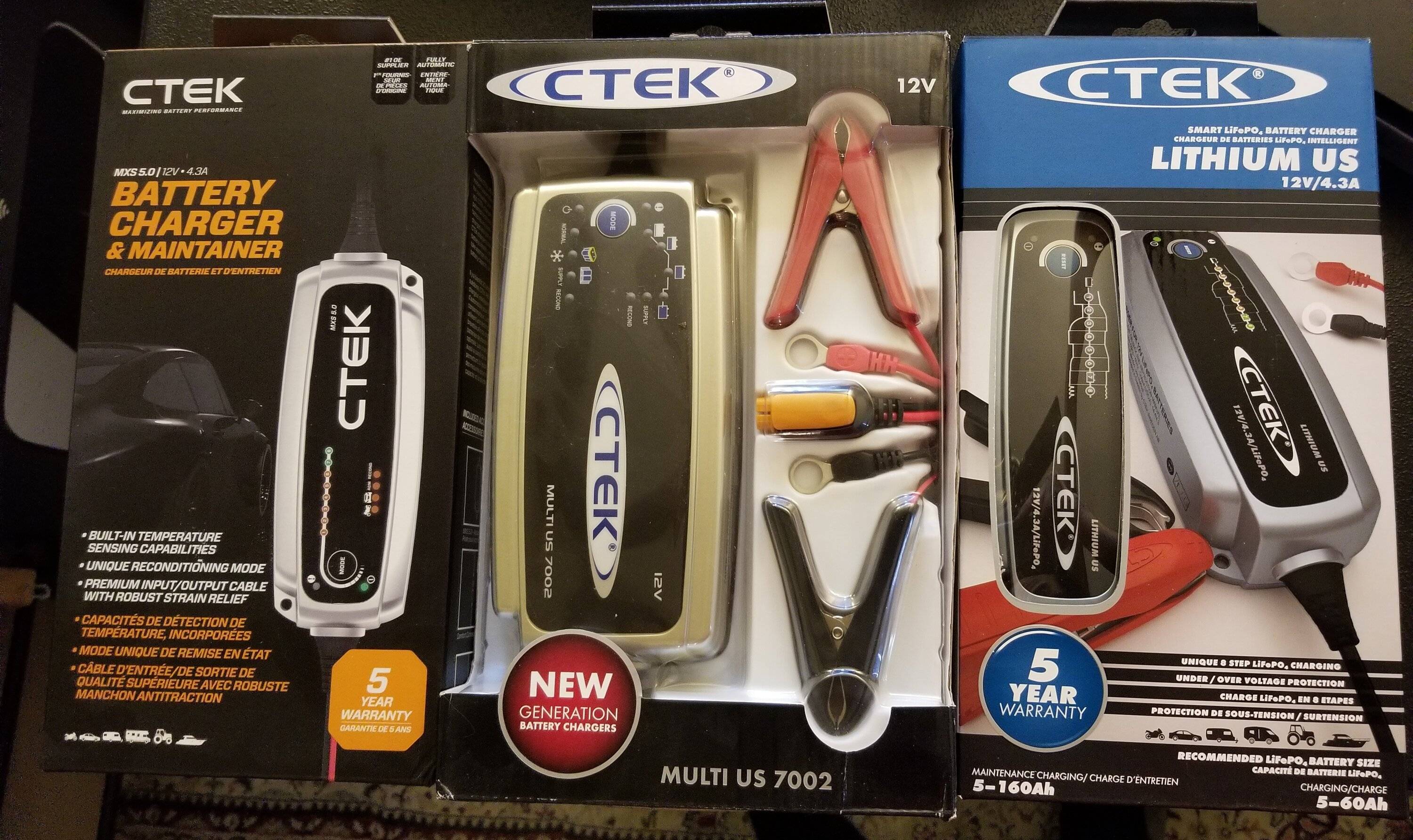

Hi for anyone in the market for a battery tender, I have these for sale in multiple quantities. I got them from a business liquidation. I will be posting in the market place but thought this thread was appropriate. Dm if you are interested, will be sold cheaper than any price online. Thanks.
I don't think they would work correctly for an AGM battery, plus you would need to follow forum rules for posting items for sale.
It will be posted in the market place according to admin rules. The 2 models will work with an agm battery, the other one is for a lithium battery.
I saw the lithium one, but the other 2 didn't say AGM. I downloaded the manuals, and of course you knew that you were right.
