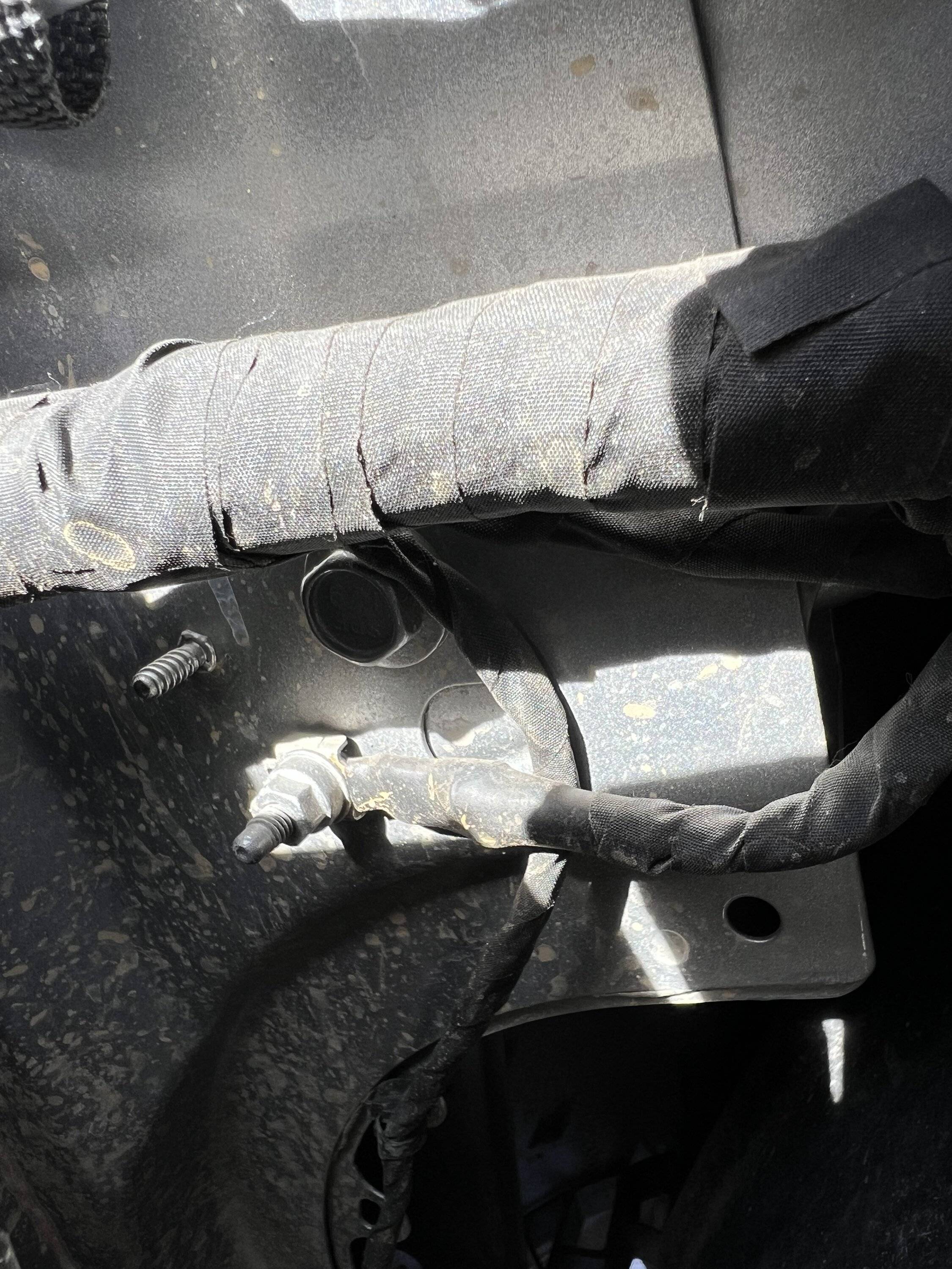

Ground G907a has a service bulletin on it for u0121. It is the ground for the ABS module and the PDC. There is also another service bulletin on ground G907a for multiple U type codes.​
S2208000025​
S2208000085​
I checked this out. The diagram shows this ground connects on driver side body behind the driver side front fender. This connection was tight with no corrosion or fraying.
