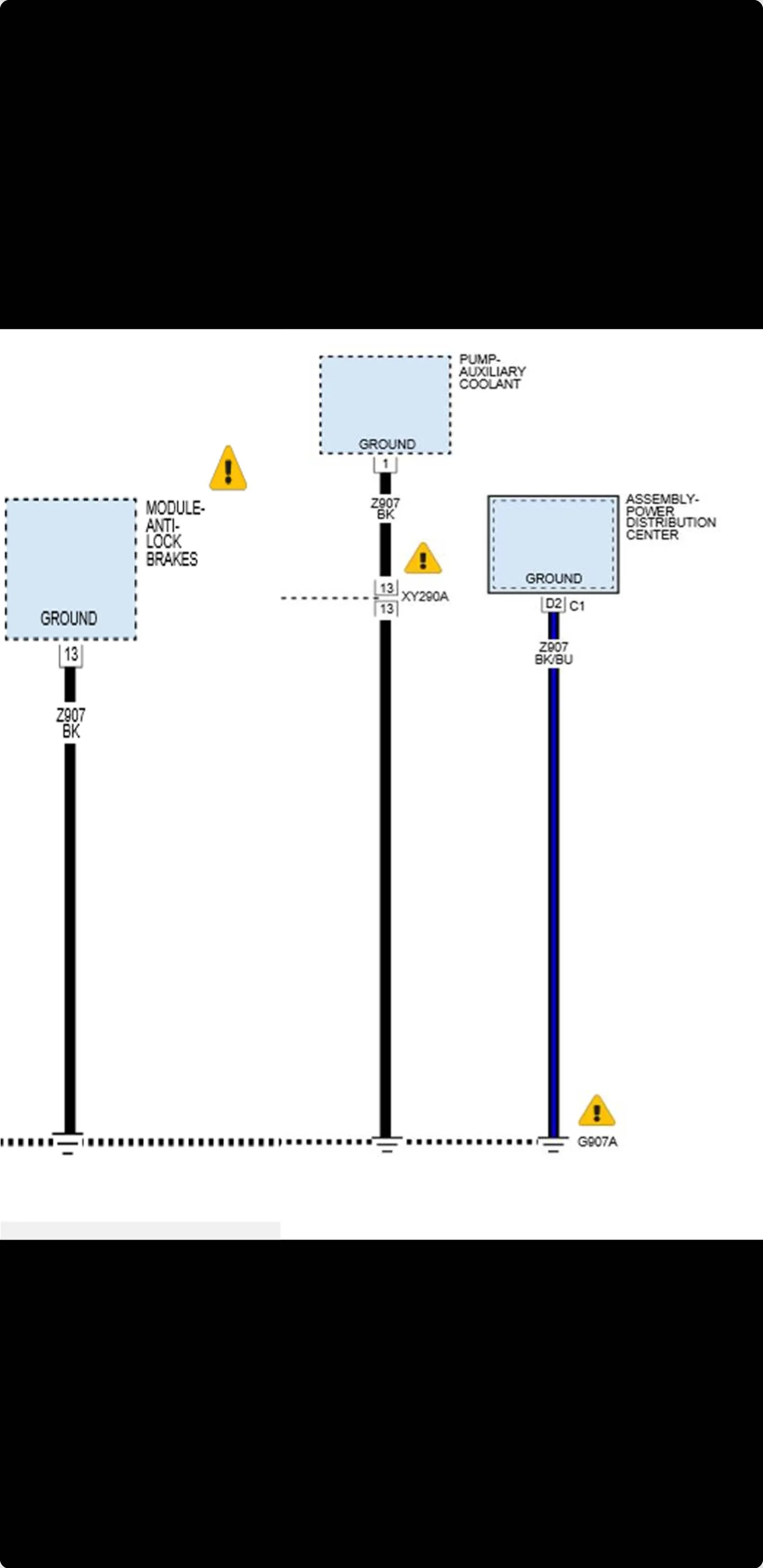

Anyone had to replace any ABS sensors or the vacuum pump yet? Very curious to see if the symptoms you experienced prior to doing so mimicked any part of what I am describing.
The auxiliary battery is where most of the advice I received pointed me towards but having swapped both batteries and still having the same electrical catastrophe as before, it clearly wasn’t the batteries.
Another source recommended I take a look at the CAN Bus star: I did a visual inspection but nothing looked out of place and the vehicle functioned perfectly until about 5 months ago when the aforementioned dash lights and behavior of the Jeep became a regular occurrence.
Now I literally cannot drive the truck without this happening at least once per trip and it’s usually much more. Today alone it has acted up 3 separate times in the course of 14 miles. Ridiculous and I feel like I’m chasing my tail. No one seems to have the same exact problem as mine and therefore no definitive answer has come to light. I’m gonna keep holding out that this will reach the right JT/JL owner who knows what I’m dealing with and more importantly, how to rectify the problem.

The code they seems to always be present during and after is U0121 and P0415.
U0121 ALWAYS present during problem.

ABS Module faults are commonly associated with low battery voltage. I'm still thinking along the line of the battery power or ground connections. Maybe there is another ground on the engine or transmission that is loose.
Lost1wing
Tim
Dec 22, 2020
2,614
2,881
West Georgia
Retired AMT
Ground G907a has a service bulletin on it for u0121. It is the ground for the ABS module and the PDC. There is also another service bulletin on ground G907a for multiple U type codes.​
S2208000025​
S2208000085​
