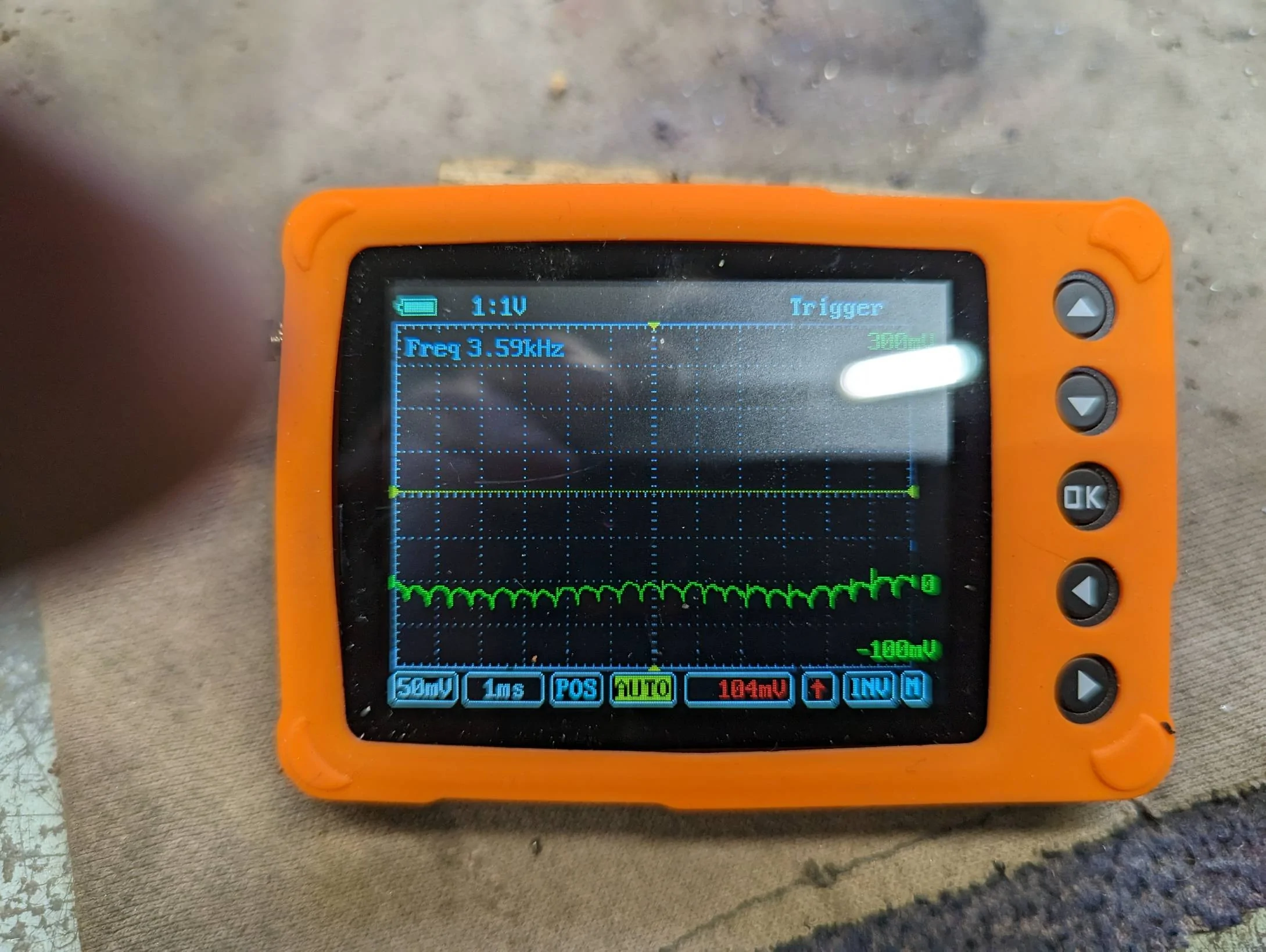

And - you can use a scope on the output line...........that can check the alternator.

Checking output on a 1970 alternator.............

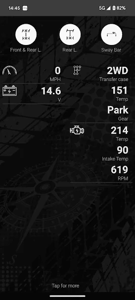

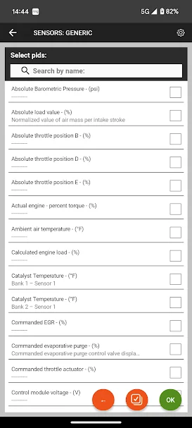

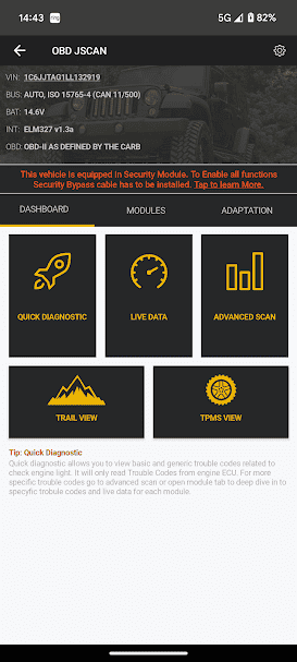

So my guess is I need to get my security module cable to get those screens on JSCAN ? With just the BT adapter I only see these -

So as reference took everything apart again this morning. Charged both main battery and aux battery. After both were charged (separately) I reassembled everything. Hooked up my BT adapter on the OBD port and fired it up. voltage went to 14.6 from 13.2 on screen. Drove to DQ (25 miles each way) with headlights on and heater fan and it stayed at 14.4-6 the entire trip.
I'll have the wife drive it again tomorrow but keep to main roads where she can get help if needed. I also changed screen back to MPG so we don't get frantic over it. Need to dig more into JSCAN next week after I get my cable back from a friend.

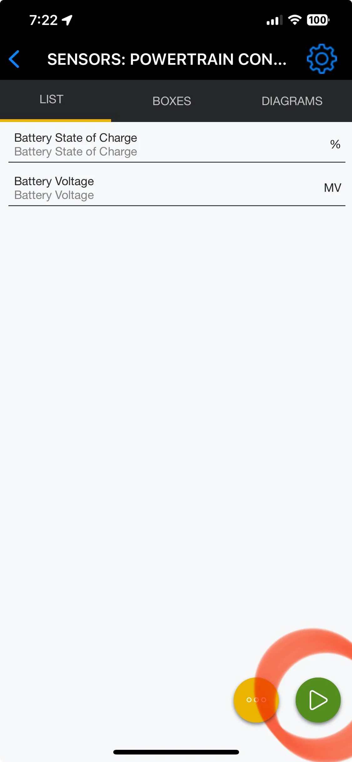

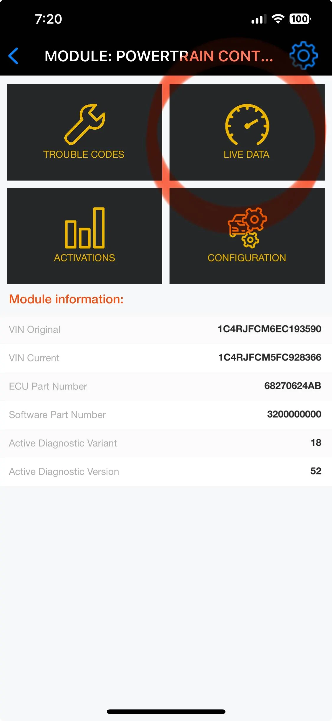

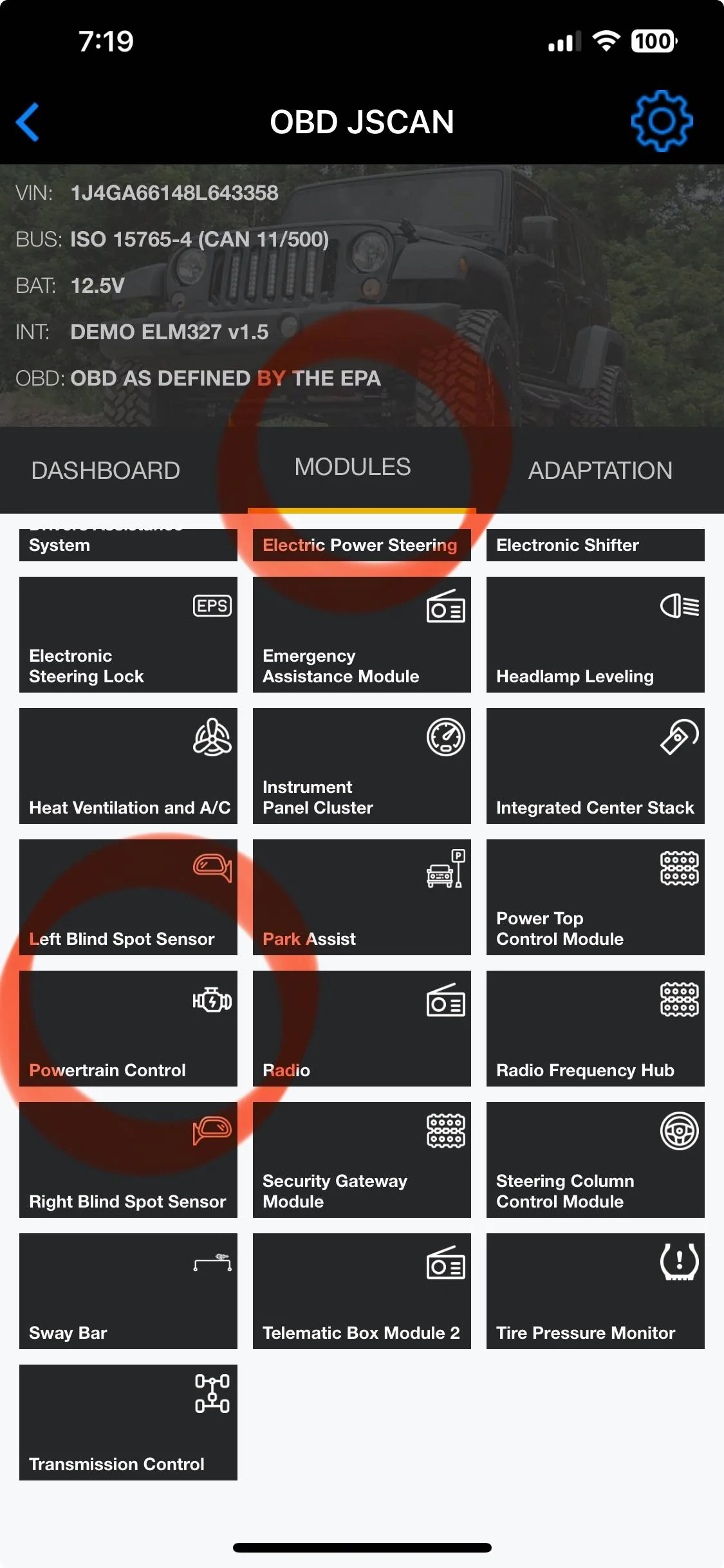

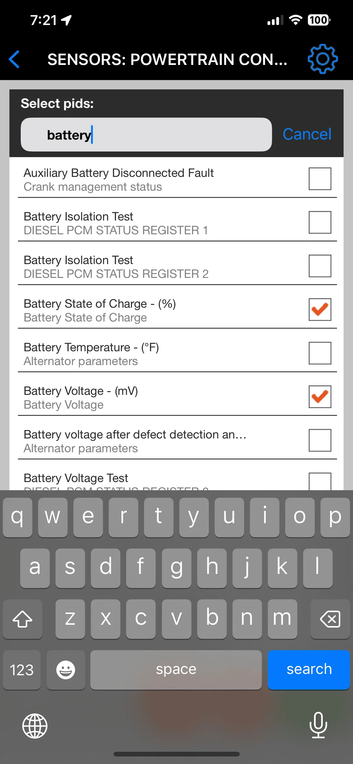

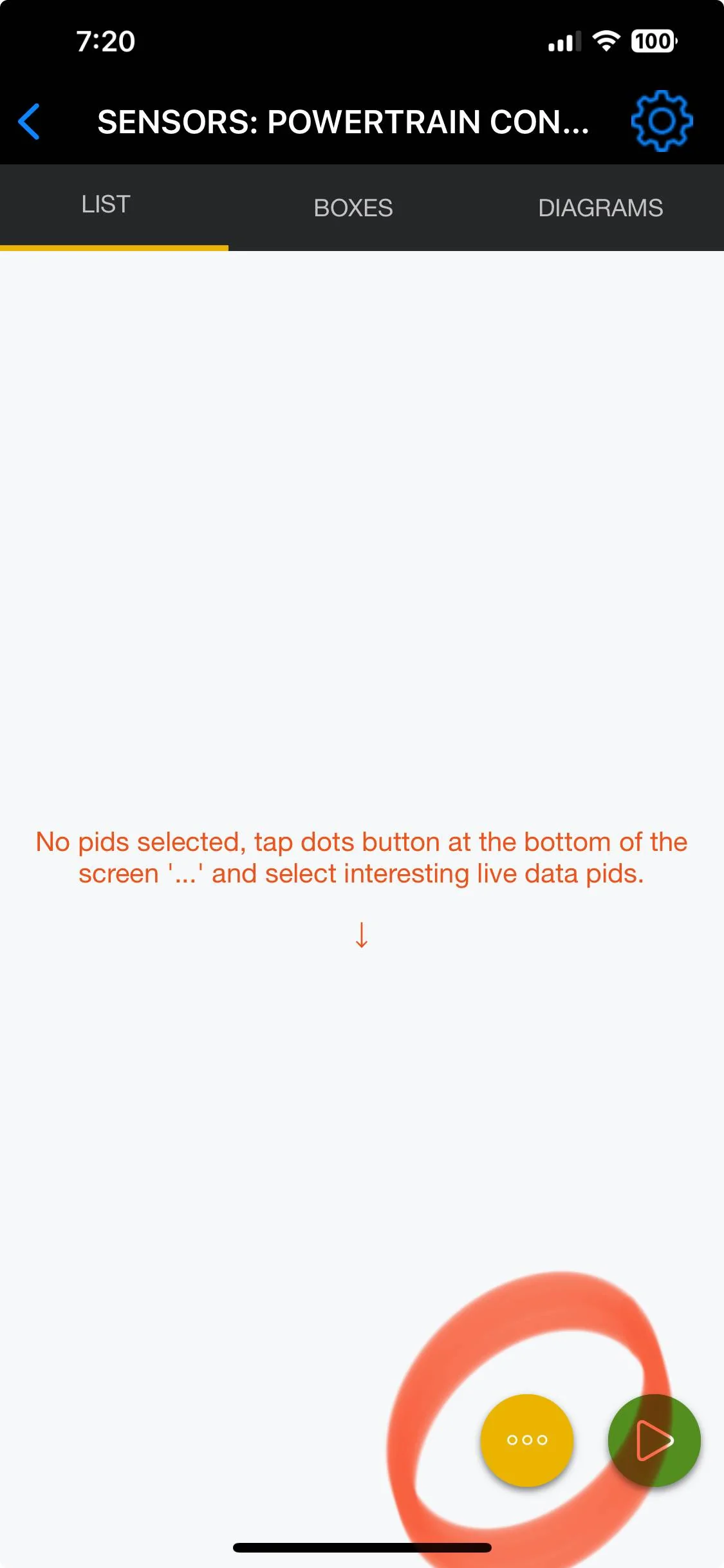

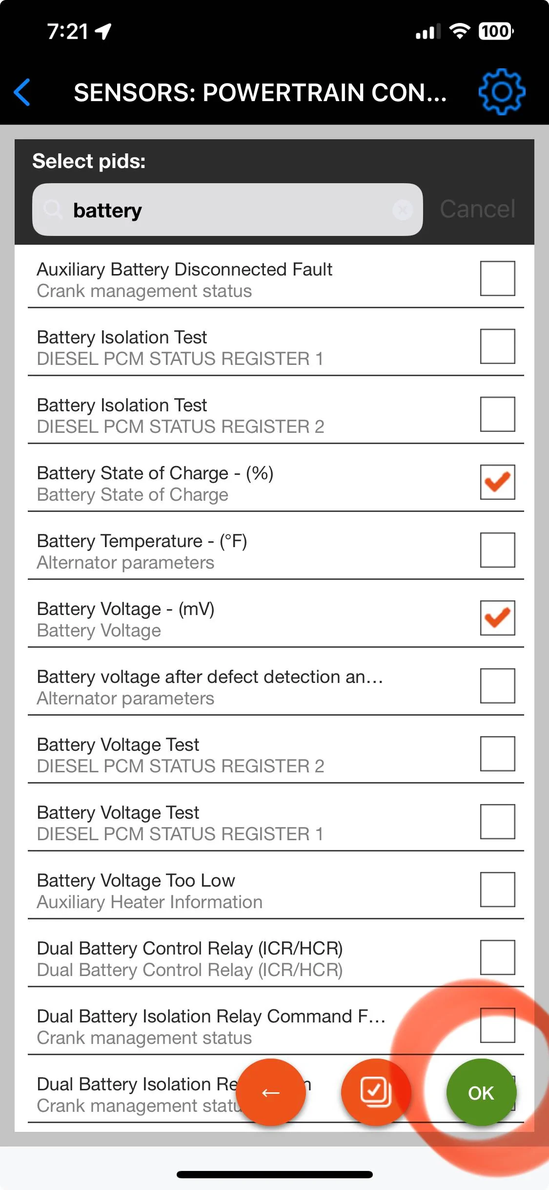

You need to go into the modules section, scroll down to powertrain control, then the yellow dot and select what you would like to view. There is seriously a ton of things to weed through in each module… ? so I think it helps if people post screen shots of what they are reviewing…. Some of these settings/views are algorithms and some are live feeds of sensors- so keep that in mind.
As seen in last post my app definitely doesn't look like yours. I think you use IOS. I'm android so not sure.
Those were shots I grabbed from another fellow looking at his Jeep - I've not been in my shop or garage to do much lately with my headache/dizzy/balance issues as of late.

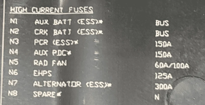

No one has seen the 60a Z5 on any Gladiator yet. I didnt have tow or aux and had 54AA factory. 100a Z5.
I don't believe 53AA is on any Gladiator. 180a JLs yes. Check what you have. The one linked has a 60a Z5.
Z5 is the only difference and is the fan fuse. Z7 is the alt fuse and is 300a on both parts.
Looks to be different 2020 vs. later.
The fuse cover legend clearly indicates N5 is 60/100 and someone who had a 2020 did find the smaller N5 60 amp in theirs - now, to recall who that was. They found different part numbers.
Looks like they used the 100 as the default in years after 2020.
(you confused me with the Z5 - what the heck is fuse Z5?? Then I realized - N5....... ok.
My 2020 pdc legend -

I just checked my 2022 - has the same exact legend! odd......... and yet I'm sure someone found a difference. Maybe it wasn't cost effective to redesign a piece of paper no one ever looked at anyway?
I can’t help with the android deal- though the video I just watched on android jscan looks the same as it does on iOS…. ??‍♂
app looks like this right:
has “demo” mode too so you can use with it when away from the house, in order to better use it when sitting in the cab.
