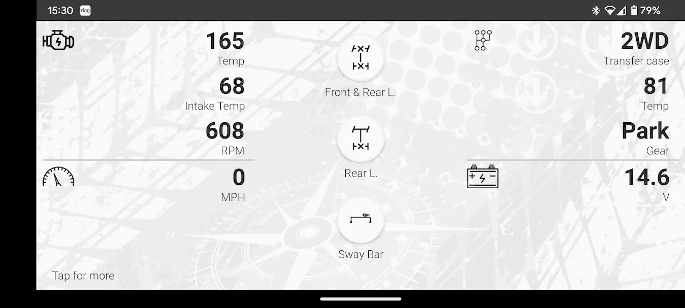

So, I was just out playing with Jscan looking for IBS %….
anyways, my jeeps batteries are a couple months old and regularly show 12.2-12.4v resting voltage….
Jscan shows the battery life at almost 87%.
I am saying the table below is gospel… but it seems to be pretty close
OP- Jscan is fairly simple to navigate for the basics of reading codes and what not. This won’t help you at all now. But might be worth downloading the app- same for your wife and keeping this in the center console:
https://a.co/d/fCBMkU4
Where did you find this screen in JSCAN ? I looked for it under them odules but only ever found battery voltage.
You need to go into the modules section, scroll down to powertrain control, then the yellow dot and select what you would like to view. There is seriously a ton of things to weed through in each module… ? so I think it helps if people post screen shots of what they are reviewing…. Some of these settings/views are algorithms and some are live feeds of sensors- so keep that in mind.
