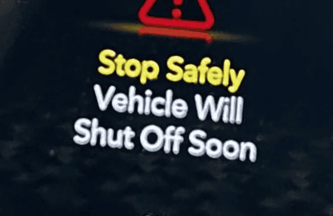

So wife called today. She got this on dash and now vehicle wont start. In middle of intersection. I know the batteries are not great (2020JT) and had planned to change them this weekend. Anyone know how to get the vehicle home. She can jump start it but it just pops up and shuts off again. We noticed it acouple weeks ago car starter wouldn't start vehicle and it barely started. Used jump pack to start and had been putting charger on it at night. Just drove it Friday with no issues. Voltage showed 14.1
This exact issue happened to me last weekend only I was driving. The dash lights went bazerk and the vehicle went into park. Good thing I was rolling at a slow pace.
My wife came out to boost me but that was no help so we say there for almost an hour charging the battery.
I got the Jeep home and put it on my intelligent charger for 24 hours. The battery showed 14.5 volts but the charge capacity was only 80% max.
Called my dealer and was told the batteries are crapped out. Warranty replaced them both and no issues after that.

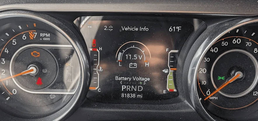

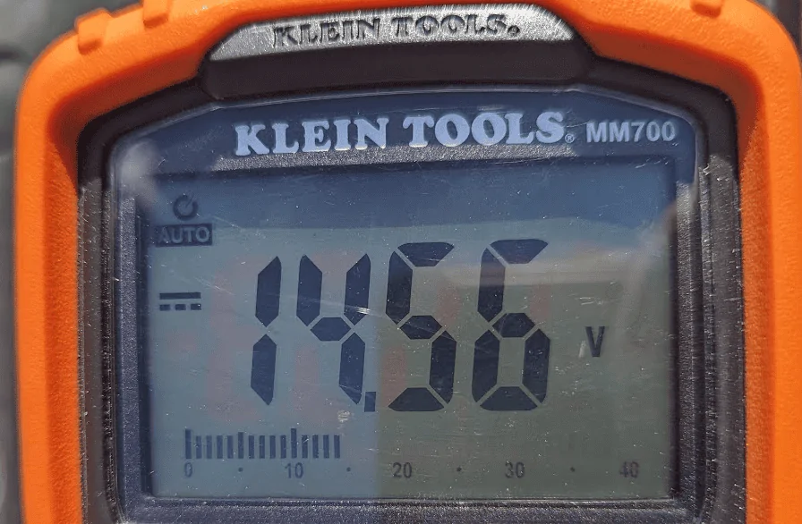

OK> So update. Replaced both main and aux battery. Aux Battery showed 10.60 when removed. Main is 12.6.
Vehicle Off
New Battery Main - 13.12
Aux - 12.35
Both batteries have chargbed multiple times over night before I got home. Charger shows full on both.
I removed N1 and M3 and measured DC voltage on both cables and it matches the 12.35-49
Start vehicle and dash throws alarms and shows battery voltage 11.5
Jeep Gladiator Stop Vehicle Now - Updates Alternator ? 1706894470456
Battery Voltage with vehicle running 14.56
Jeep Gladiator Stop Vehicle Now - Updates Alternator ? 1706894441133
PCM Via JSCAN shows 11.37
Jeep Gladiator Stop Vehicle Now - Updates Alternator ? 1706894402015
I did continuity test on ZBar Fuse - N1 and N3 appear to be tied together. N2 and all other posts appear together. Voltage on all posts with vehicle off or on.
I'm at a loss. Checked F42 and fuse is good. How can it not show 12+ volts on PCM but show 14+ on battery when running.
