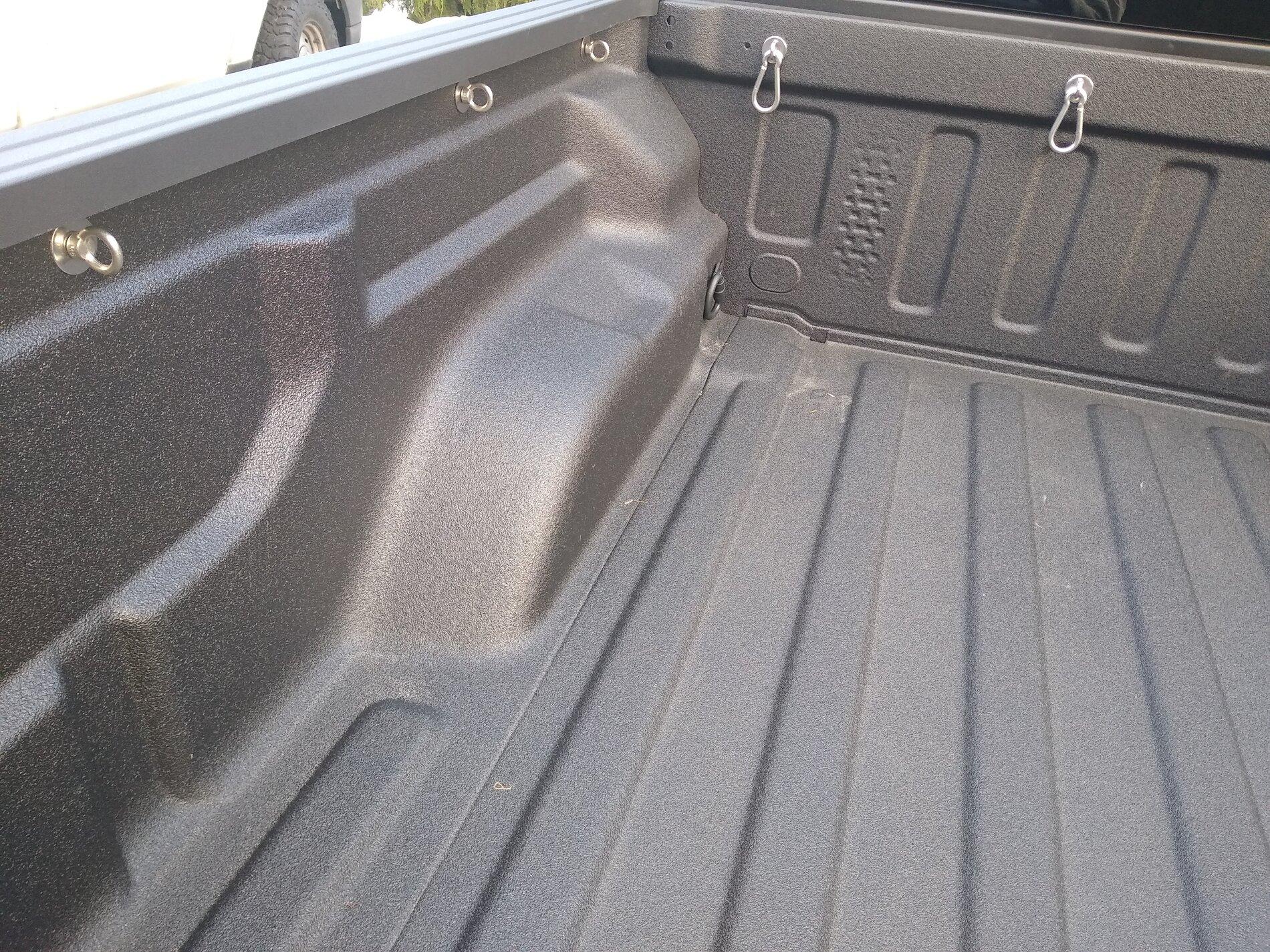

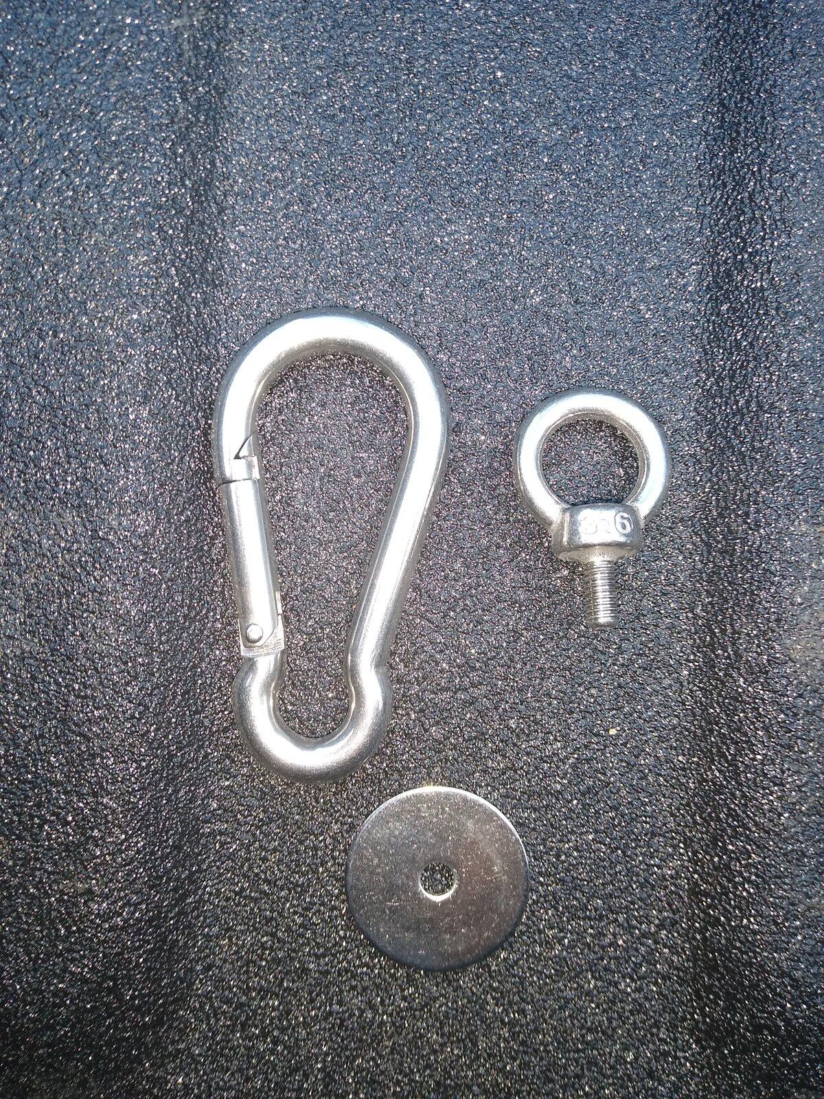

Securing M6 / 6mm Bolts in Bed Rail Holes?
FLUndertaker
Aug 9, 2020
83
1,049
1,244
Oklahoma
2020 Jeep Gladiator Sport, 1986 Jeep CJ7
Get the Macs Tracks gladiator kit. Perfect fit, very versatile and very reasonable price.

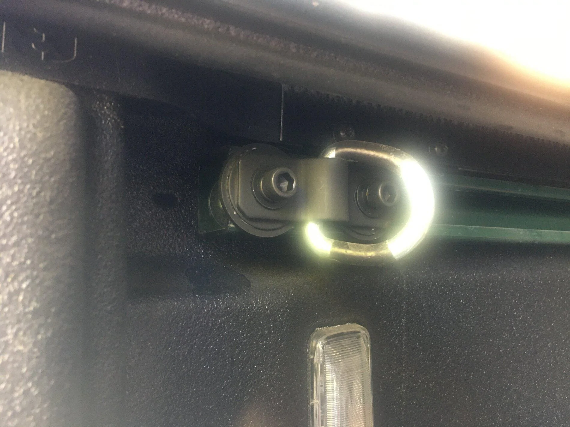

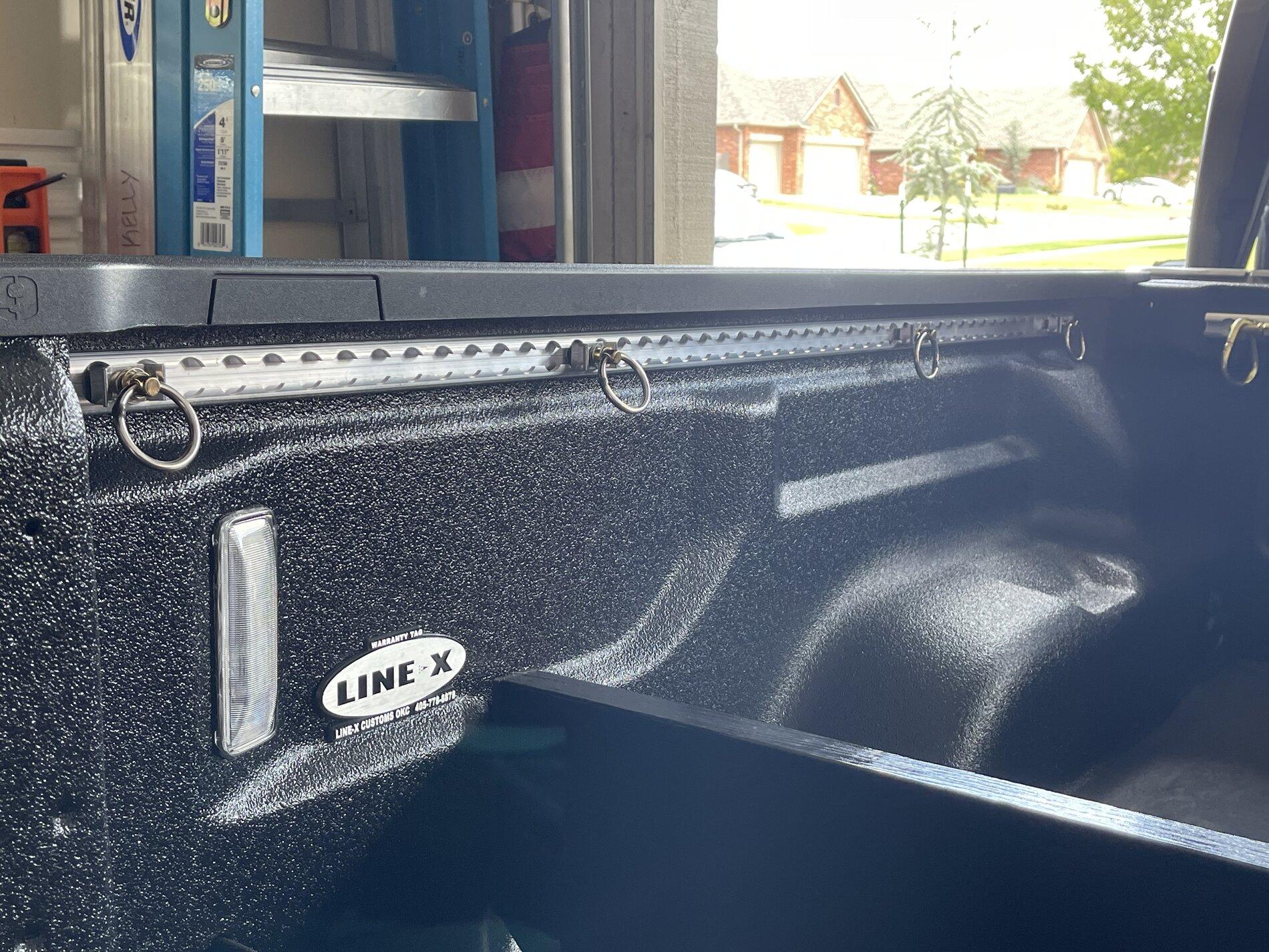

My cargo rail attachment points were full of bedliner material. Had to get a tap the correct mm and tread pitch and tap out the bed liner material. Once cleaned i was able to mount unistrut with D rings. Worked great!
Jeep Gladiator Securing M6 / 6mm Bolts in Bed Rail Holes? unistrut D ring
