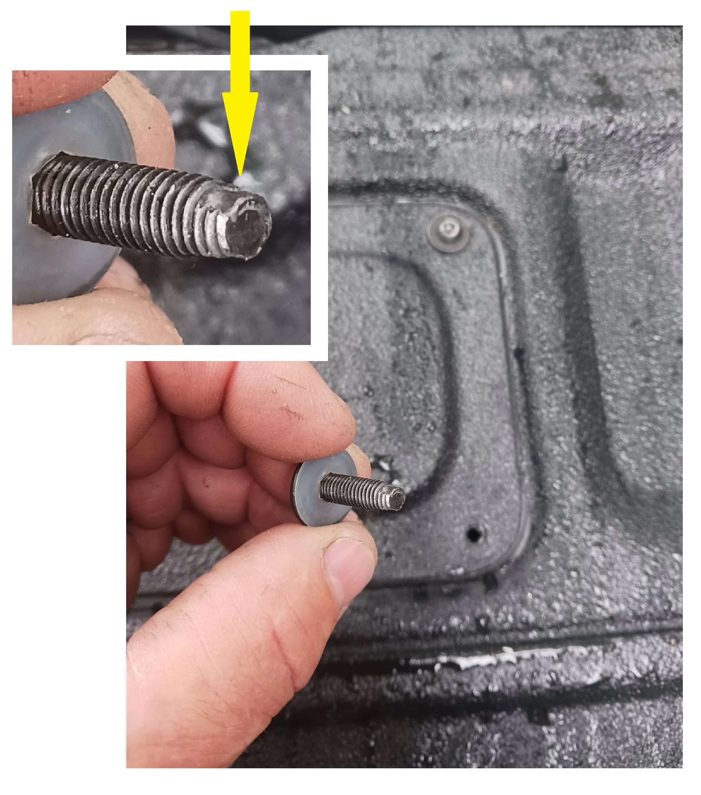

After posting the same question (how to clean the threads) I found this post and other similar posts. I appreciate the responses to this post, the Gladiator Forum, and the community! Great help!
I found that the screws in the tailgate have flat sides at the first 3 or 4 threads are they are the same thread as the holes along the sides of the bed. The flat ends of the screws served as excellent thread starters/cleaners. I used a little WD-40 and the tailgate screws to clean out the Rhino-lining.
Perhaps my solution to cleaning the threads might help others.
Using one of the tailgate bolts worked well for me today when I cleaned the bedliner out of the bolt holes. I also used the M6-1.0mm thread chaser from this set: https://www.summitracing.com/parts/sum-900198 since I had ordered it the day before NvrGvUp posted this tip. Ended up alternating between each one. The tailgate bolt seemed to "plow" most of the bedliner out of the way, then followed up by using the thread chaser to clean the remainder of the bedliner out of the threads.
