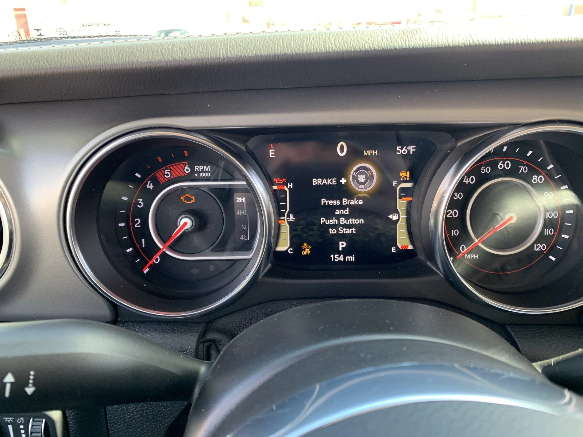

Just happened again. Driving errands doing great. Get to a light and switching through screens on instrument panel. Stop on start stop as it’s only activated once while I was driving. Start to accelerate left to turn at light and vehicle is limping. In short fashion I get a service Start/Stop message, Service DEF system message and service electronic throttle switch. Pull into center lane and start/stop system says it needs to be turned off and back on. Then get low oil pressure alert. Turn it off and back on and limp into a parking lot. Waiting to hear back from Jeep. Check engine light on as well.
Jeep Gladiator Service DEF system see dealer warning message EBF44413-F8BF-41BD-8968-F619E082B2A5
sounds like your fuse box has loose ones to me. Pull your PDC cover in the engine bay and see if you can push them down

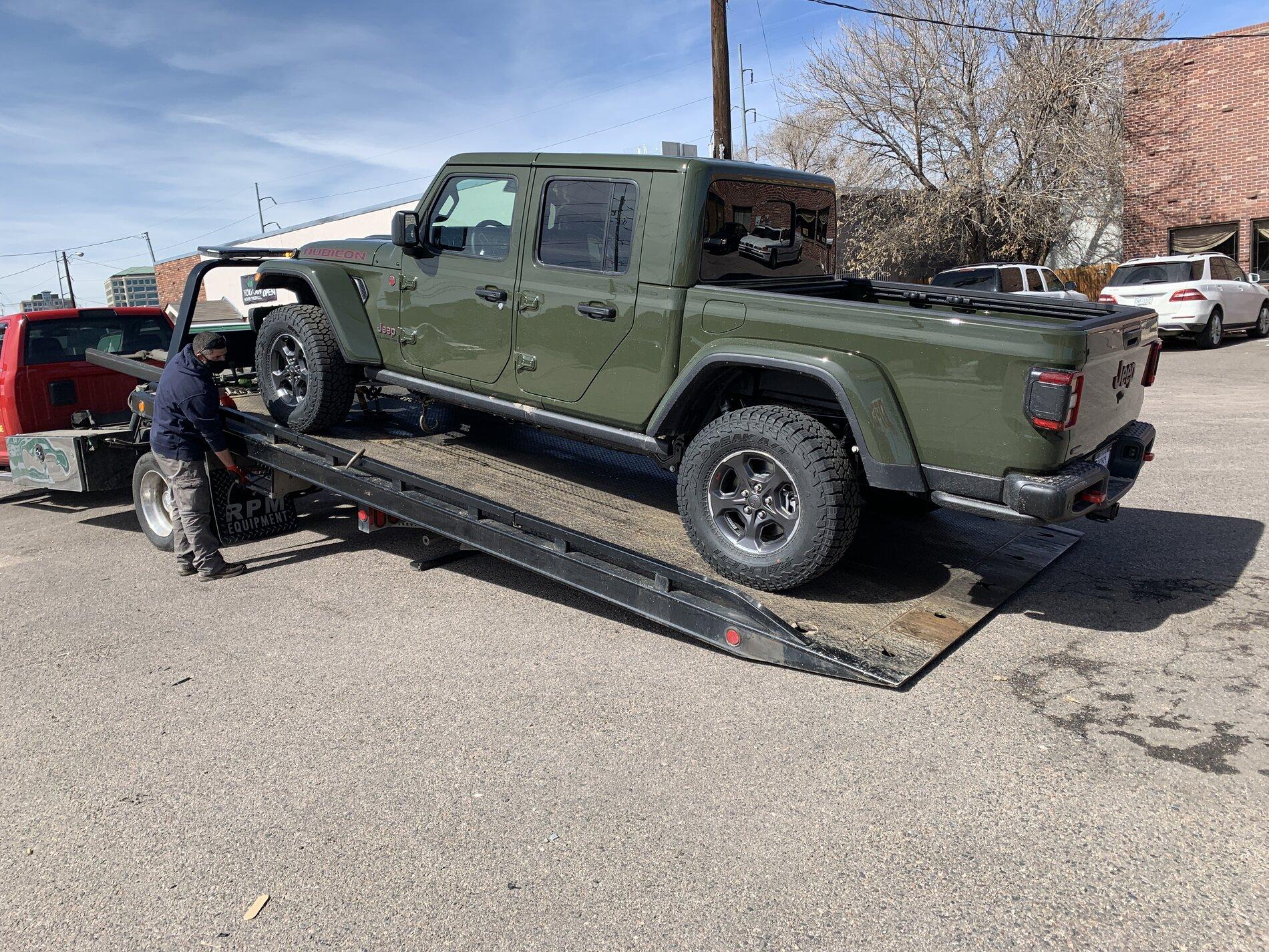

155 miles and it’s first tow. Heard back from dealer I bought it from and the DEF pump was already replaced along with a crank shaft position sensor.

Damn that sucks.....sorry man. Let us know what they end up finding wrong.
Not that it helps, but I really like that green color!
You mean dealer fixed/replaced those items before you bought it?

What a bunch of bullshit! that is damn near the same thing as selling you a wrecked one and not disclosing it.
I'd say they owe you a new one...
