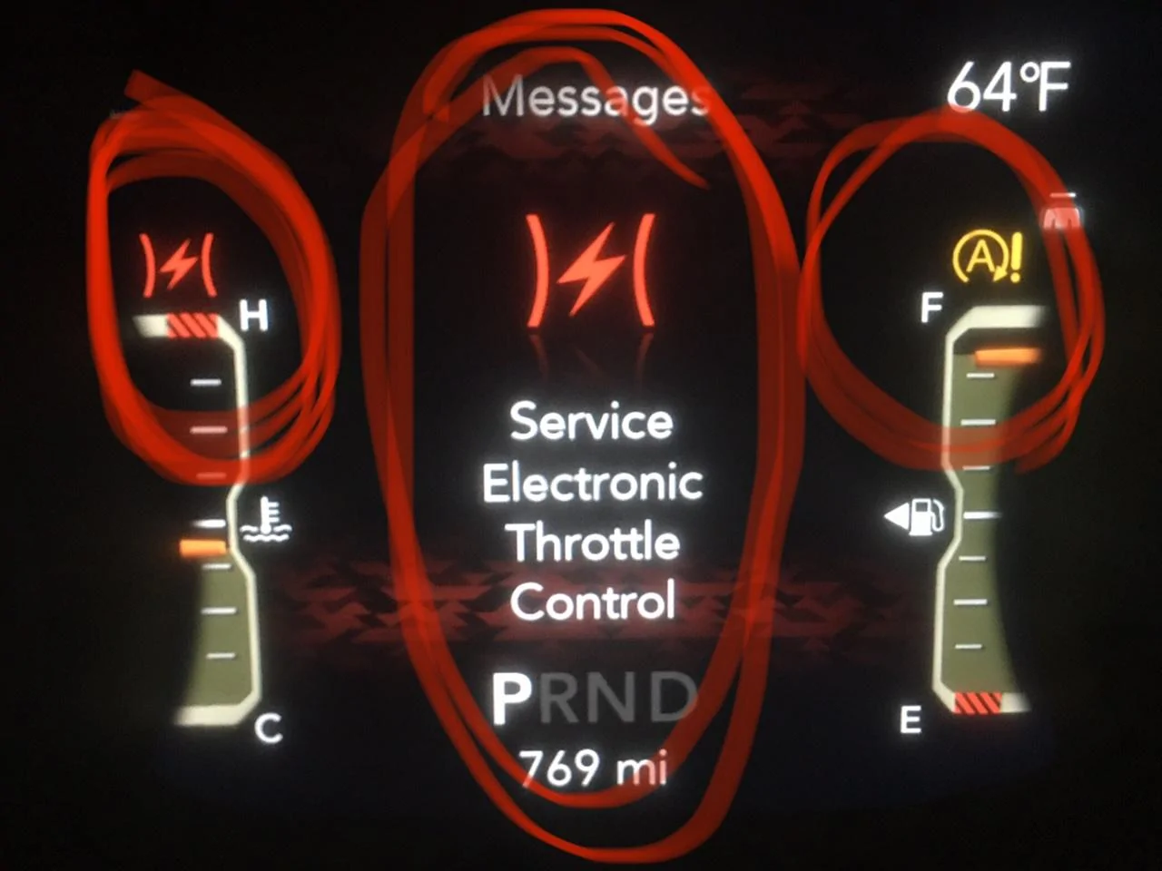

Hello fellow EcoDiesel owners. So I have owned my diesel since 10/20 and in the 17 weeks it has been in the shop for issues for 5 weeks. The first issue happened with only ~700 miles (2 weeks after pickup) and is went into a "limp mode" on the freeway only allowing a maximum of 2000 RPMS showing several codes related to the Throttle Control & DEF (see pic). I took it to the deanship where I purchased and they were "borderline useless" and after several weeks they said they reset the computer and sent me on my way.

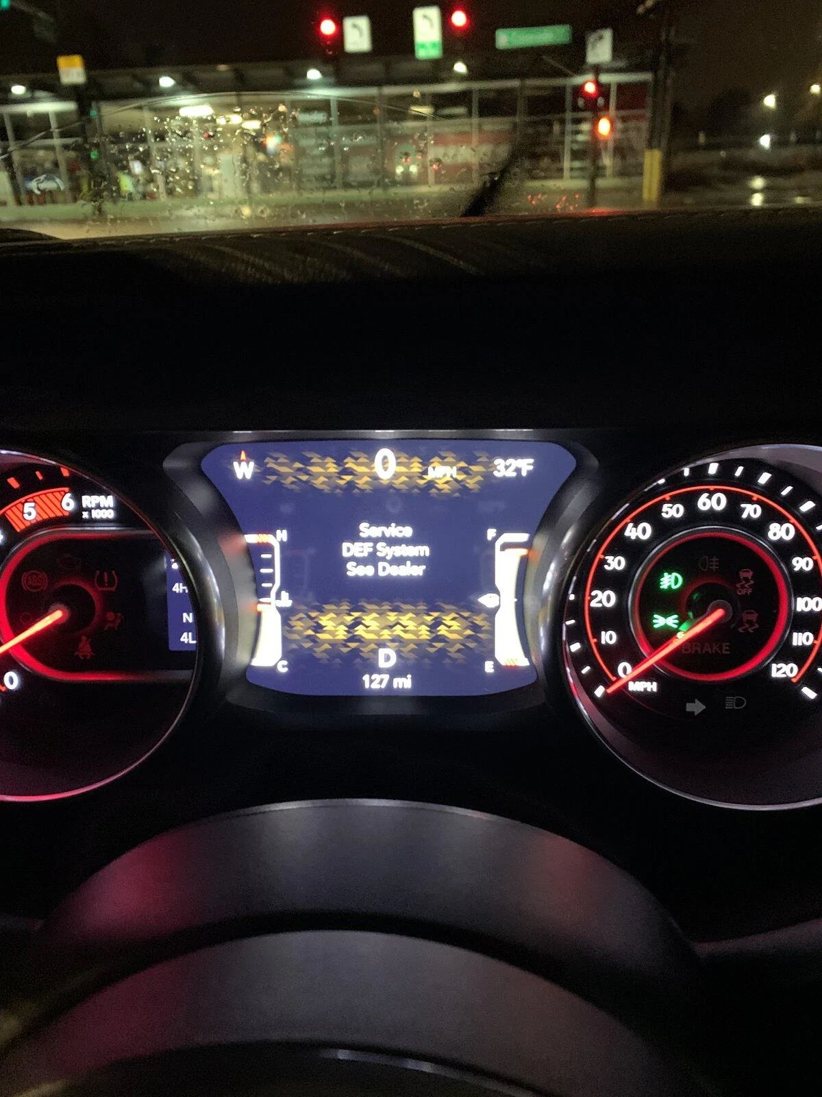

Just picked up the JTRD and after 60 miles on the highway I got the dreaded service DEF notification at my second stop light after the highway. Truck completely shut off and shifter started blinking requiring me to put it in park and restart. It came on one more time over the next mile and went away. Started it up a couple more times when I got home and no notification. 30 degrees and snowing out but should be a freezing issues after driving 60 highway miles? Maybe a bad sensor?
