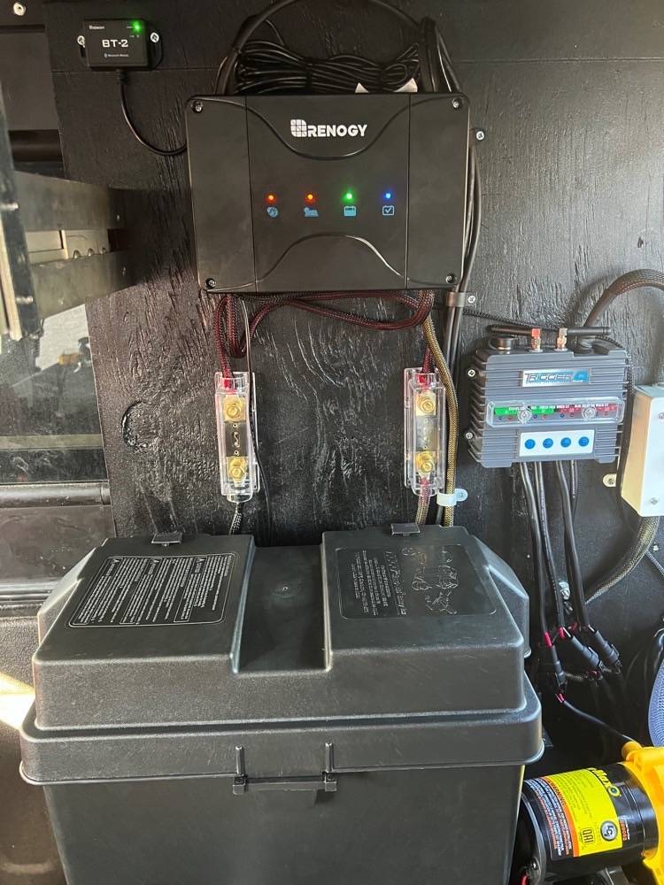

I did not have the factory bed outlet but created my own setup:
Jeep Gladiator Setting up accessories? Fridge, exterior rack lights, air? 32_100aHBattery_2
Instead of doing something like the Genesis setup, I installed solar with a 100aH battery and 30A DC-DC MPPT. This provides all the power I could want in the bed for my fridge, lighting, USB chargers, water pump, etc.
Now that may be more than you want to do but there is no reason that you couldn't run wiring from your battery back to fuse block in the bed. In fact, in the top right of the above picture is a Trigger Controller (grey with two little antennas) that you could use. On my JKUR, I have one mounted under the hood, which runs all of my accessories via either an RF remote that comes with it or via Bluetooth and an App on my phone.
You could simply mount one of these under your hood and run wiring to whatever you need. Mine are 4 switch units but they make a 6 switch as well. What I like about this unit is the Bluetooth/RF remote aspect. Mount it on your dash to run things from the cab and then pop it off it's mount and carry it back to the bed...
