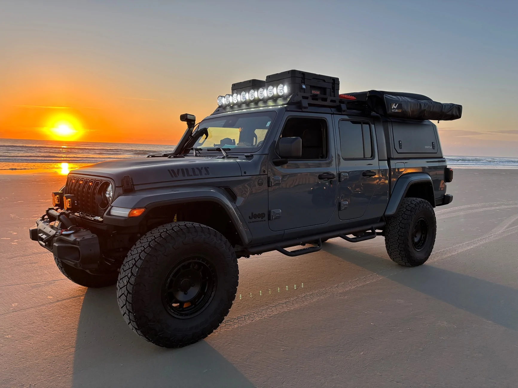

Currently running the AEV Dualsport suspension lift with the AEV 3” high capacity springs and the Bilstein 5100 shocks. I also added a steersmarts yeti front adjustable track bar to center the front axle. I want to improve the ride and handling and hoping that a shock swap out will help.
I have a Warn EVO 10S winch and knock off Mopar steel front bumper on the front end.
In the rear I have an RSI Smartcap, iKamper Skycamp 3.0 mini RTT, a 270 degree awning and a decked drawer system. I will occasionally be towing a 2300 lb. Adventure trailer. Let me know your thoughts.

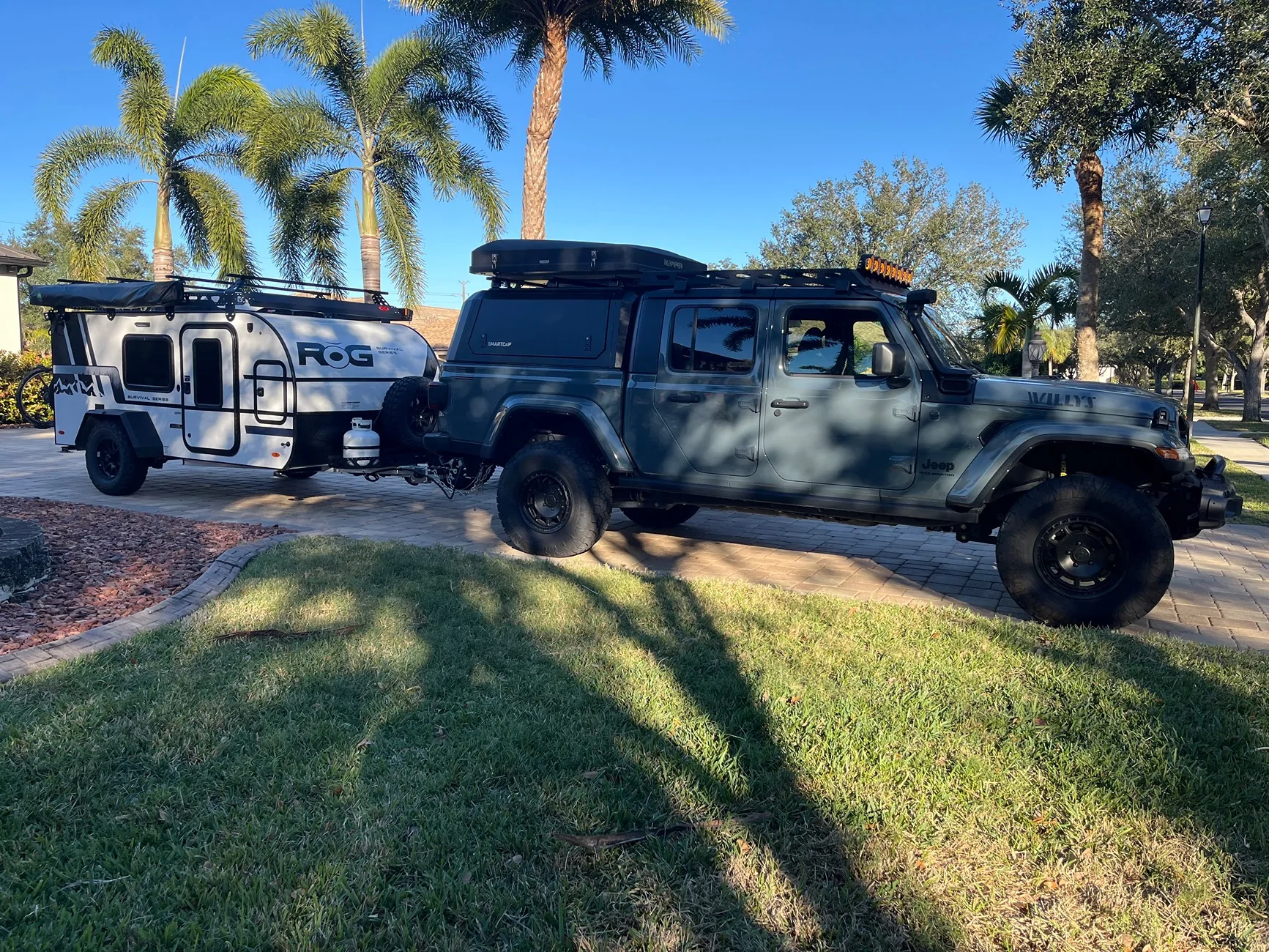

Current ride while towing my 15’ adventure trailer can get quite “bouncy” and harsh , especially on roads with a lot of undulations. So maybe everything is “too stiff?”

Do you run a weight distribution hitch? Without knowing the facts, sounds like you don't, or maybe it isn't set up right.

No weight distribution hitch. Was advised no need for one as trailer dry weight was only 1735 lb. I do run a lock n roll hitch however.
