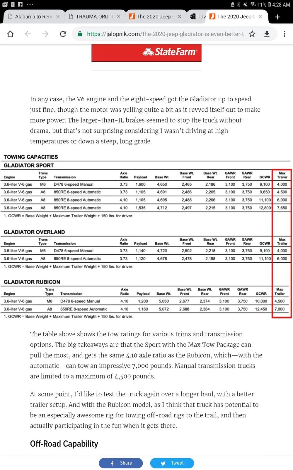

Looking at the tow chart I seem to be a bit confused. The Overland with 3.73 gearing and auto transmission has max tow capacity of 6,000 lbs. The Sport with 3.73 and auto tranny is listed in one chart to only tow 4,500 lbs.
Can anyone clarify this for me? My brain is too fatigued at this hour of the night and at the end of the week to try and figure this one out.

I think the Overland gets the HD brakes standard, and the Sport doesn't. That could be one difference.
Jeep really needs to publish better data in the owners manual. It's a joke the way they have it laid out in there.

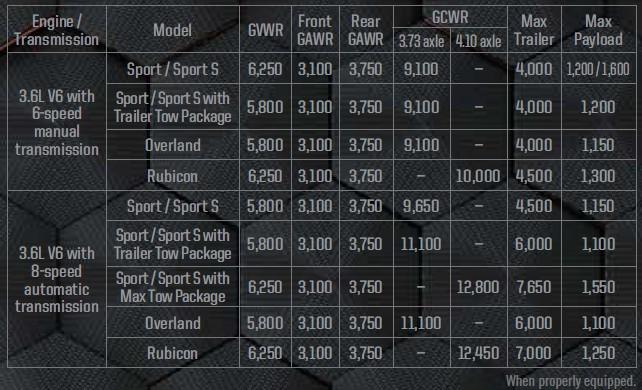

4,068
Bluegrass region of Kentucky
Interestingly, the sales brochure seems to have better information than the owners manual. Go figure..

2021 JT Willys, 2021 Audi Q3
Trauma Surgery Physician Assistant
That makes so much more sense than this previous chart I referred to.

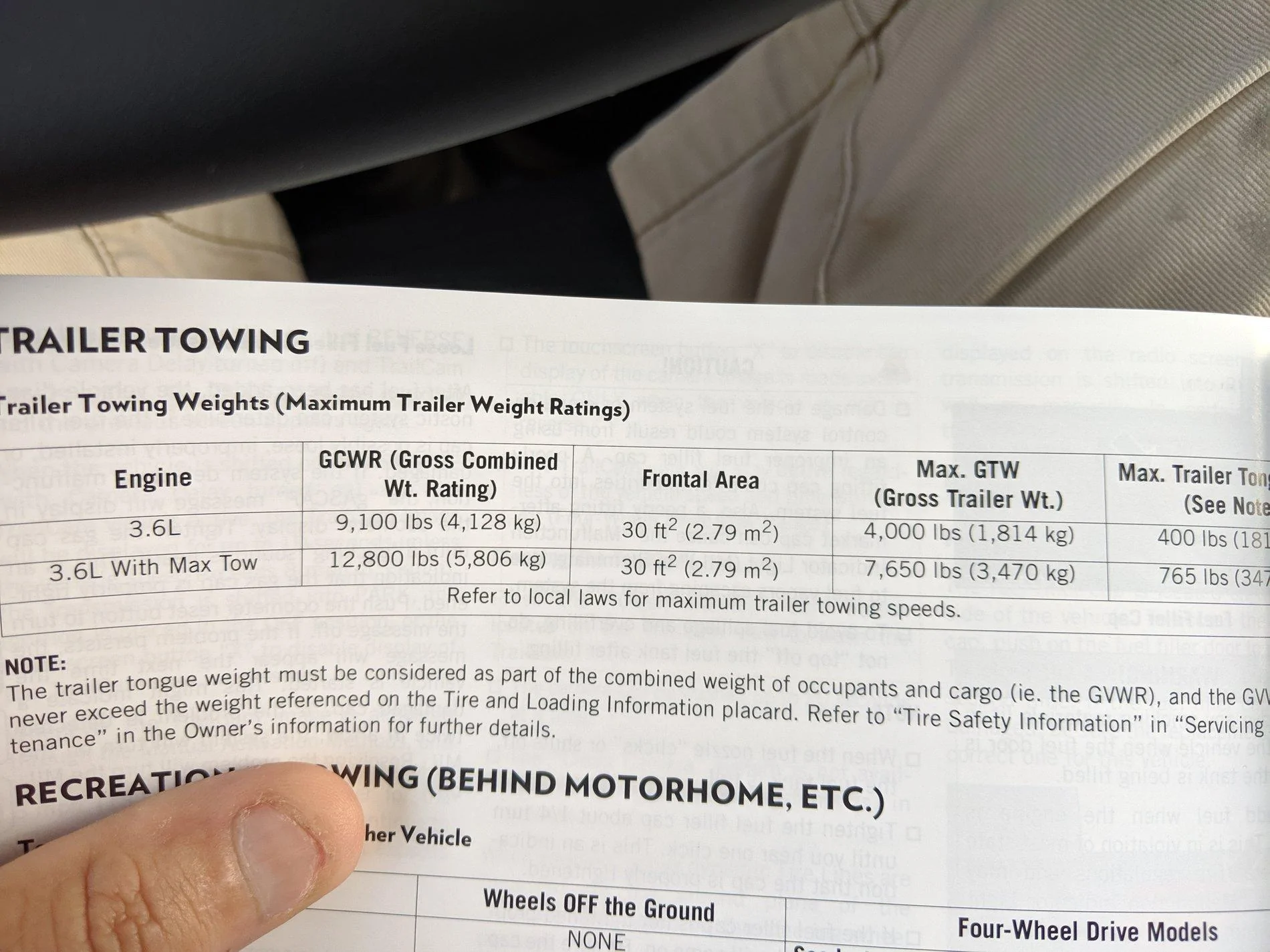

N. Carolina
2023 High Velocity JTR
Straight out of the manual for my Sport S.
And that's why I bought the Sport S w/ max tow.

4,068
That's the old version of the manual. I have that same one. Version 2 has significantly more detailed information in that chart.

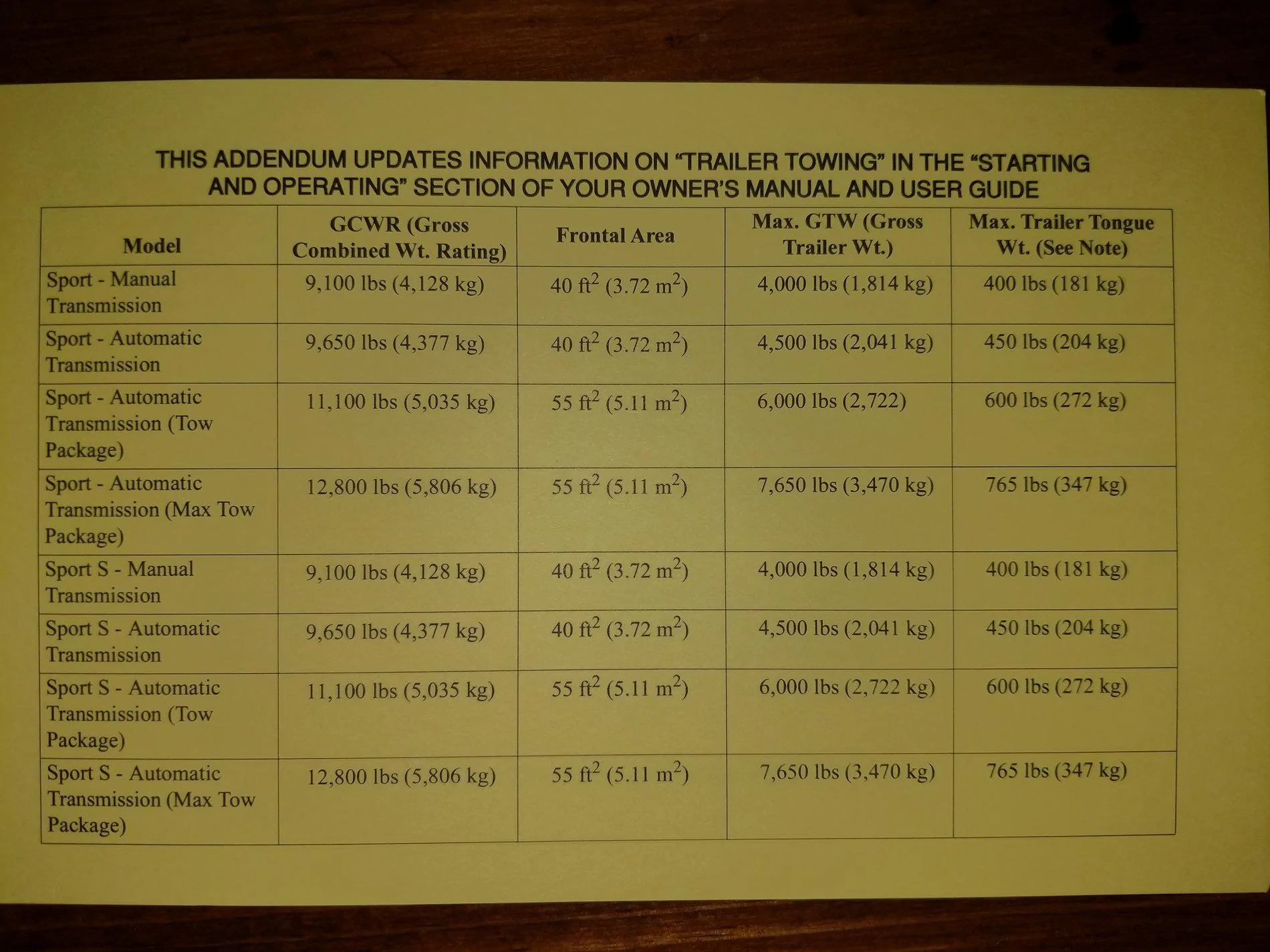

Greenville, SC
'20 Gladiator Sport S
Just picked up my Sport S with the tow package (not max tow). They added an addendum insert with the manual and it says 6,000lbs for my vehicle. I'm pretty happy with this update!
6k is more than enough for me!
