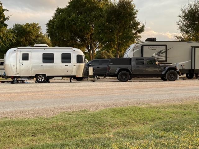

Just towed from FL to Yosemite (about 3000 miles). 22’ Airstream about 4100#s dry. Maybe 600 lbs of gear, between the trailer and TV. About halfway through the trip my rear diff sensor warning light came on. Heard this is not uncommon while towing and the dealer will have to replace the entire rear axle.
we are moving from a 30’ AS to the same model you have. I have a pro pride hitch we used on the 30’ and have been debating using it on the 22. Wasn’t sure if it was necessary given the weight it will add to the tongue. Any thoughts on that? Also, what size bars are you running? 600?

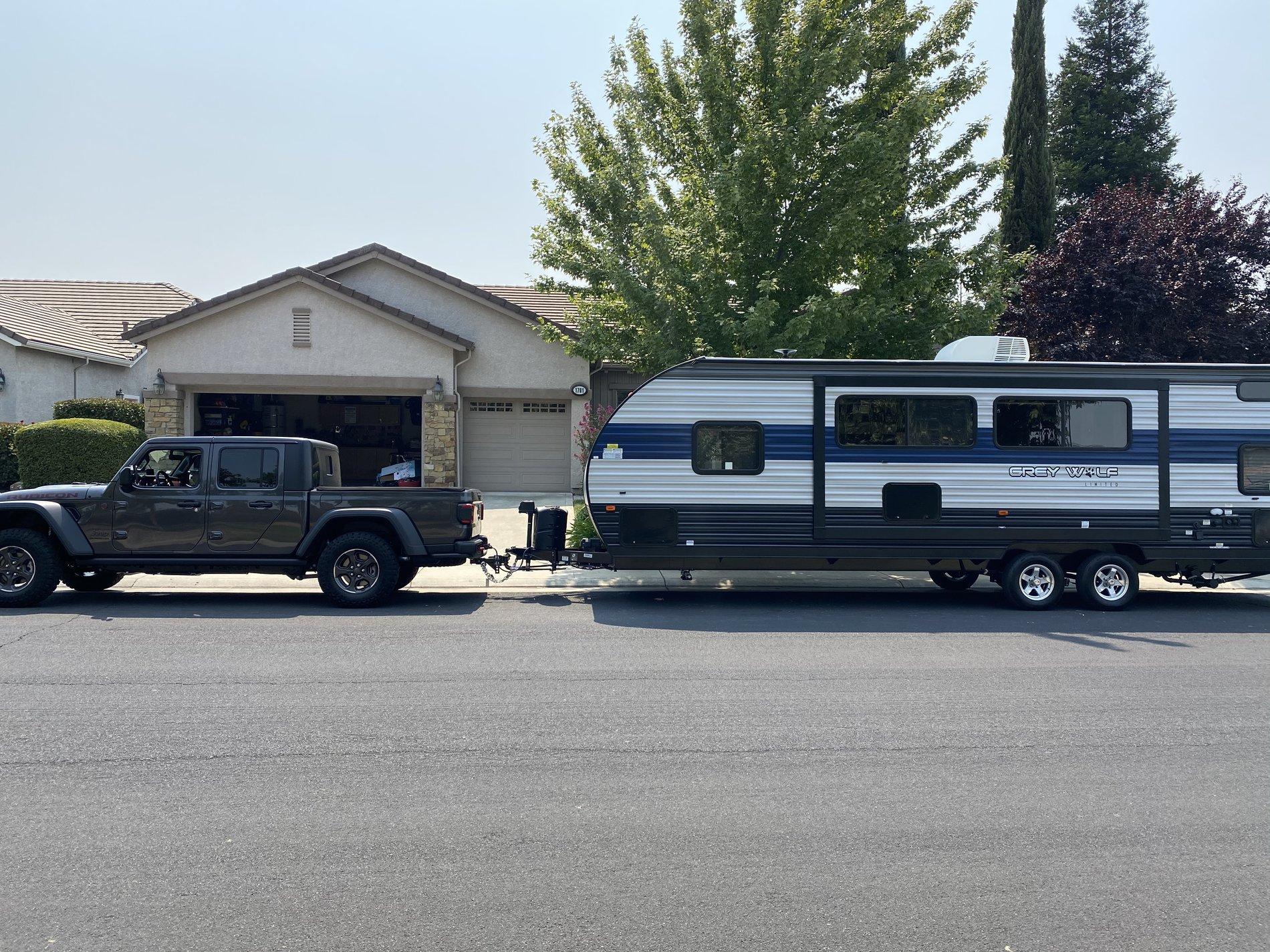

Nice looking rig. What is the weight and dimensions? How does it tow? I am looking to go a little bigger and not sure the JT will be happy with bigger.
its 6000 dry. Honestly I would not go any bigger. Once you load it up it’s a couple hundred lbs more. You also have to consider the payload weight of the people in your JT. You need to make sure the GCVW is not being exceeded. With my JTR I’m getting close to the GCVW. It tows it fine. I just took it from 700’ elevation to 7700’, to South Lake Tahoe. It did great felt comfortable towing. Trailer brakes did great. But I would not suggest towing outside of the vehicles specs. If you go bigger you maybe outside of them.
Sweet trailer. But is that trailer GVWR close to 8k lbs? What is your Glady rated at for towing? You much have the tow package etc.? You may not tow it fully loaded and sounds like it does well up to Tahoe where i would like to go to tow my trailer if I ever get my Glady Diesel!! LOL.

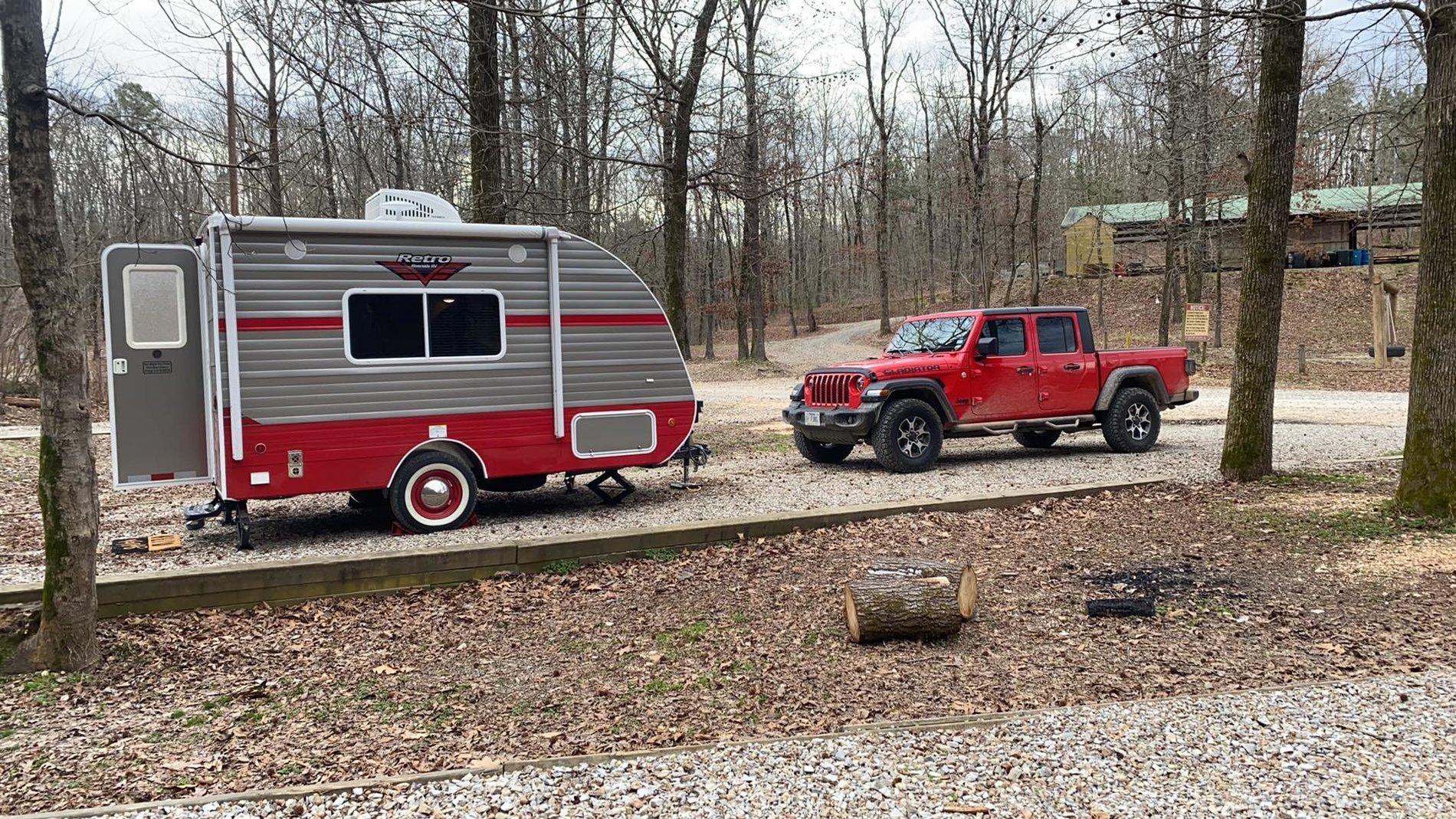

I don’t have the MaxTow pkg, and I tow my Retro 135 without any problems at all. My mileage is terrible — I average about 11 mpg or so — but the truck itself handles just fine. What is it about yours that you consider to be “really bad” ref towing?
Ferg:
Looking at one of those today with the dinette. I have the standard tow package and a manual trans Sport S. You think towing the 135 would give me any trouble?
