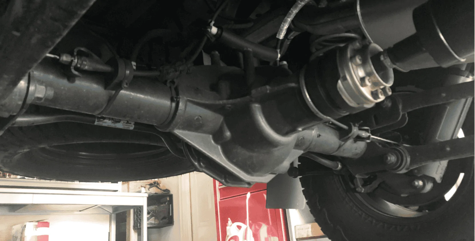

Here it is on my JT's rear axle after 19 months, including 1 salty New England winter:
Jeep Gladiator Spray in Tub liner as underbody coating 1674222503497-png

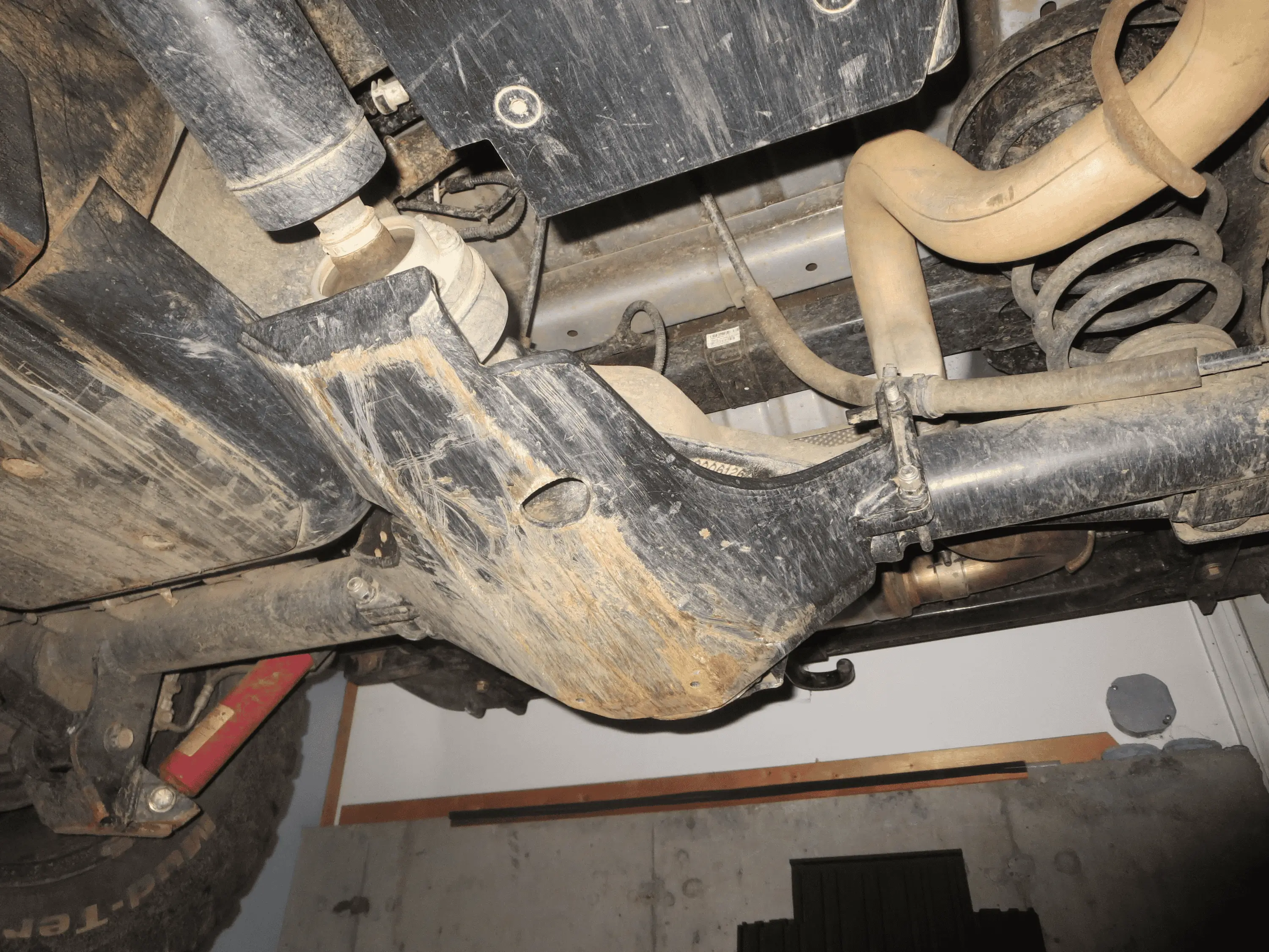

Here it is on my 2014 JK. In this picture, it is on the axle housing, all skid plates, and the driveshaft. I (obviously) don't bother touching it up anymore:
Jeep Gladiator Spray in Tub liner as underbody coating 1682681692756
