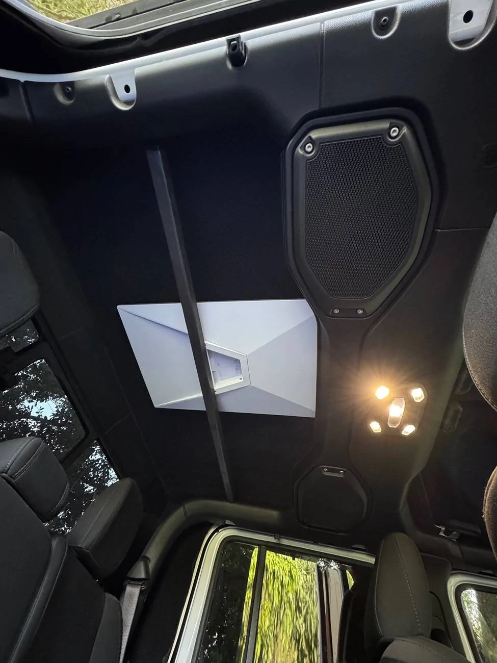

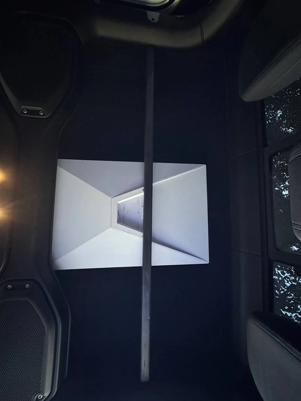

This won’t be a permanent install, at least not at the moment. I went with the Gen 3 over the mini because I’ll also be using it for backup internet if and when my home internet goes out. I’m putting it in the jeep for those times we venture out of cell phone range. Powered off starlinks own (new) 12v adapter. The bar that holds it up is a variation of a gun rack someone posted on this forum a while back. It works through the hard top and coverking (no sound/foil insulation) while in motion. Just wanted to show that it is an option for those interested.

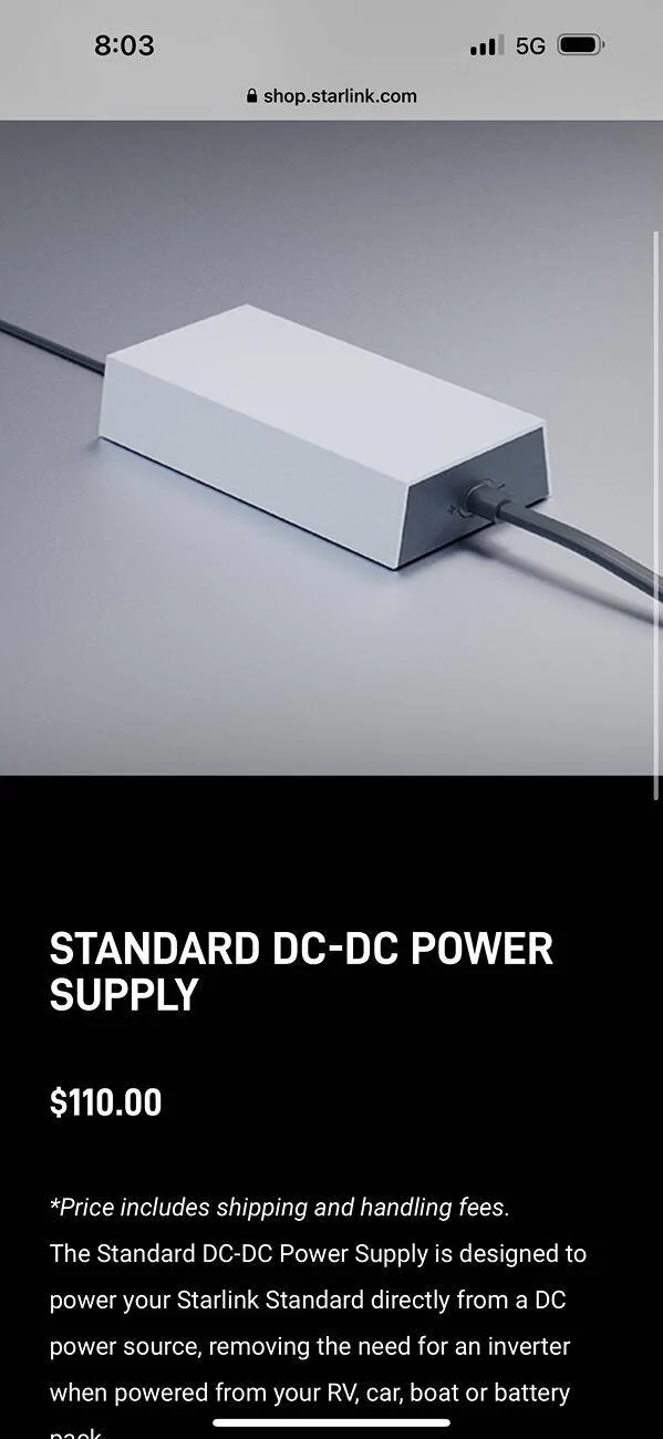

What is this 12volt adapter you mention? Do you have a link to it that you can share?
jav_eee
jav_eee
Mar 10, 2023
1,084
1,075
2021 Gladiator Rubicon
I don’t know how to link it because you can only see it in the Starlink app (requires sign-in) under the shop tab. But here’s a screenshot. It’s a little pricey but I’m sure it’ll be More RF quiet (for my ham radios sake) than those cheaper Amazon versions.
How did you secure your dish to the aluminum pipe?
jav_eee
jav_eee
Mar 10, 2023
1,084
1,075
It just sits on it, doesn’t really move around. I’ll probably zip tie the dish’s kickstand to the bar just to make sure it won’t slide sideways even though it shouldn’t. The soundbar puts the slightest bit of pressure to hold it against the roof. That being said I do have that headliner so without it it might not fit right enough to stay on it’s on. In that case you’d definitely want the zip tie.
