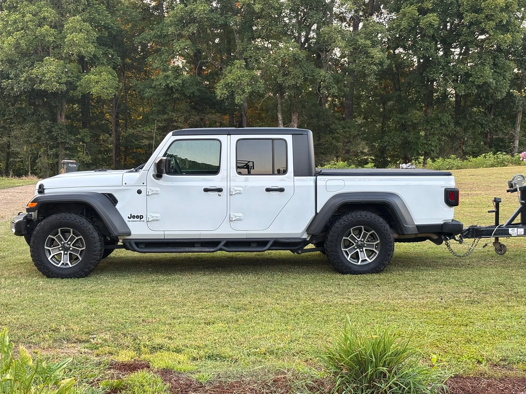

One thing about not trading for a max tow, is I tend to think instead of dealing with selling and paying thousands to get a max tow, it might be as good or better to upgrade springs and do a 4:88 or 4:56 gear swap instead of having the 4:10 that the max tow offers. I do wish I would have held out for a max tow, but now that I have a sport s base, money might be better spent on a better gear set and springs. My heavier towing is short hauls during summer to the boat ramp. Haven’t had any high temps. Still debating on getting an older model high mileage full size for what it costs to upgrade some items or trading the jeep for a newer model full size or upgrading a few components to make the short hauls better. Mainly just slow pulling power that I think gears would help with and maybe beefing up the springs. Still thinking through it and trying to decide if I want to part with the jeep, which I really enjoy driving and love to occasionally pull the freedom panels or top this time of year.

boater2018
Ben
Nov 30, 2024
New Albany, MS
2023 Jeep Gladiator Sport S
Here is a picture showing my boat hitched up and the sag. Should be right at 6000 including trailer, boat, fuel, 2-300 pounds of misc gear
Jeep Gladiator Gladiator Sport S Towing Upgrades IMG_3483
