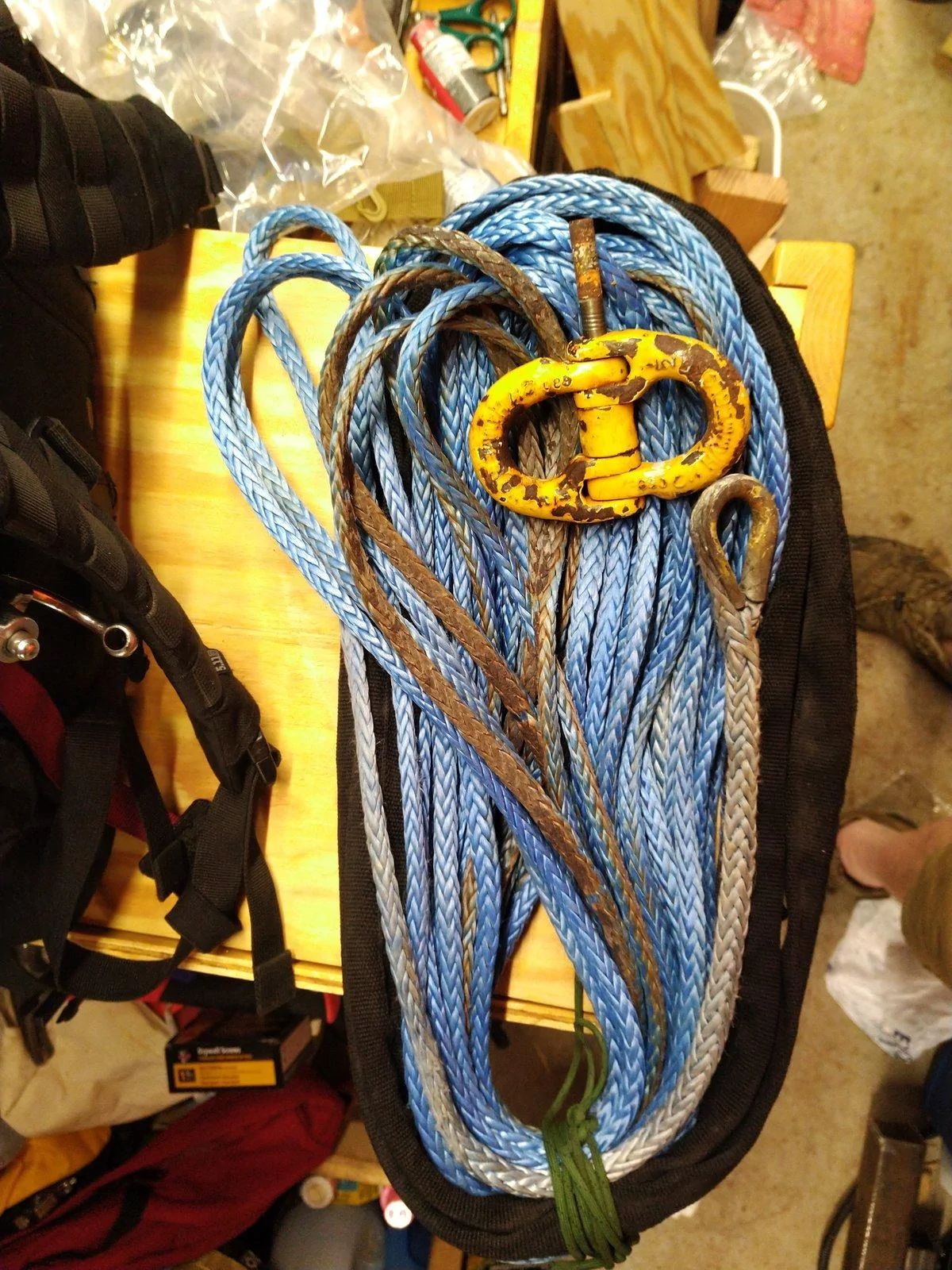

Synthetic winch line and a cover is my first choice after working with both. I've made 2or 3 covers for my winch and used them all the time it's not in use. This is a picture of my 20 year old Ramsey winch line and no I didn't have a hook on it. (Retired now) I only use it with shackles through that link laying on it. A cover can be just a few feet of marine vinyl wrapped around drum or covering the winch.
