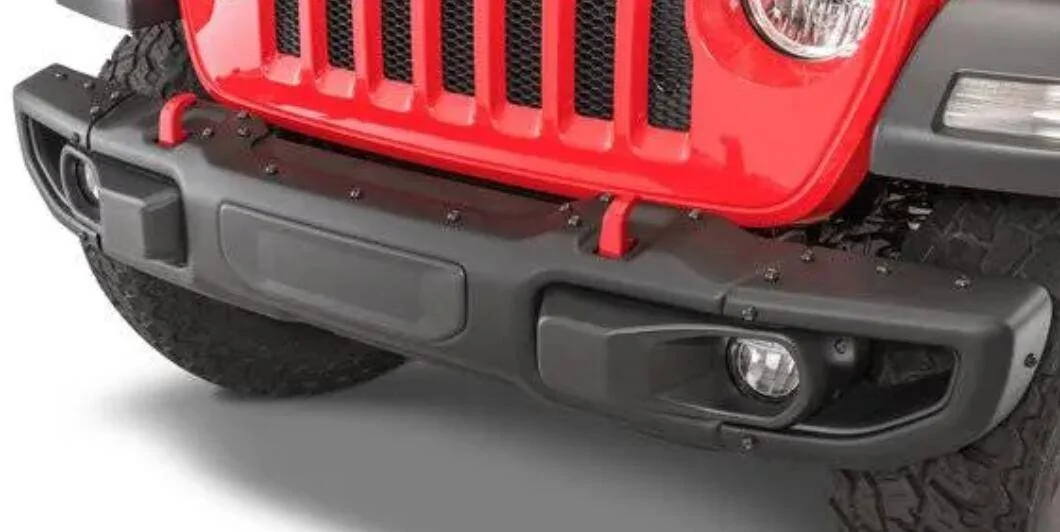

Ok I’m asking a dumb a$$ question. I’m looking to get a winch plate and winch for my 2021 Gladiator sport. I need to know how to tell if I got a plastic or steel bumper. Forgive me if if I’m being dumb comes with being 70. All my other jeeps have winches, but no so on this one.

Most likely a plastic skinned bumper, the plastic bumpers have some sheet metal under the plastic but not much to it. Unless it's been replaced before you got it.
If you snap a picture and post it. You can get a confirmation on it fairly quick.

If there are 20+ nickel sized visible Torx screws all over the bumper, it's the steel one. If not, plastic.
Jeep Gladiator Plastic or steel bumper 1740592522020-g8
