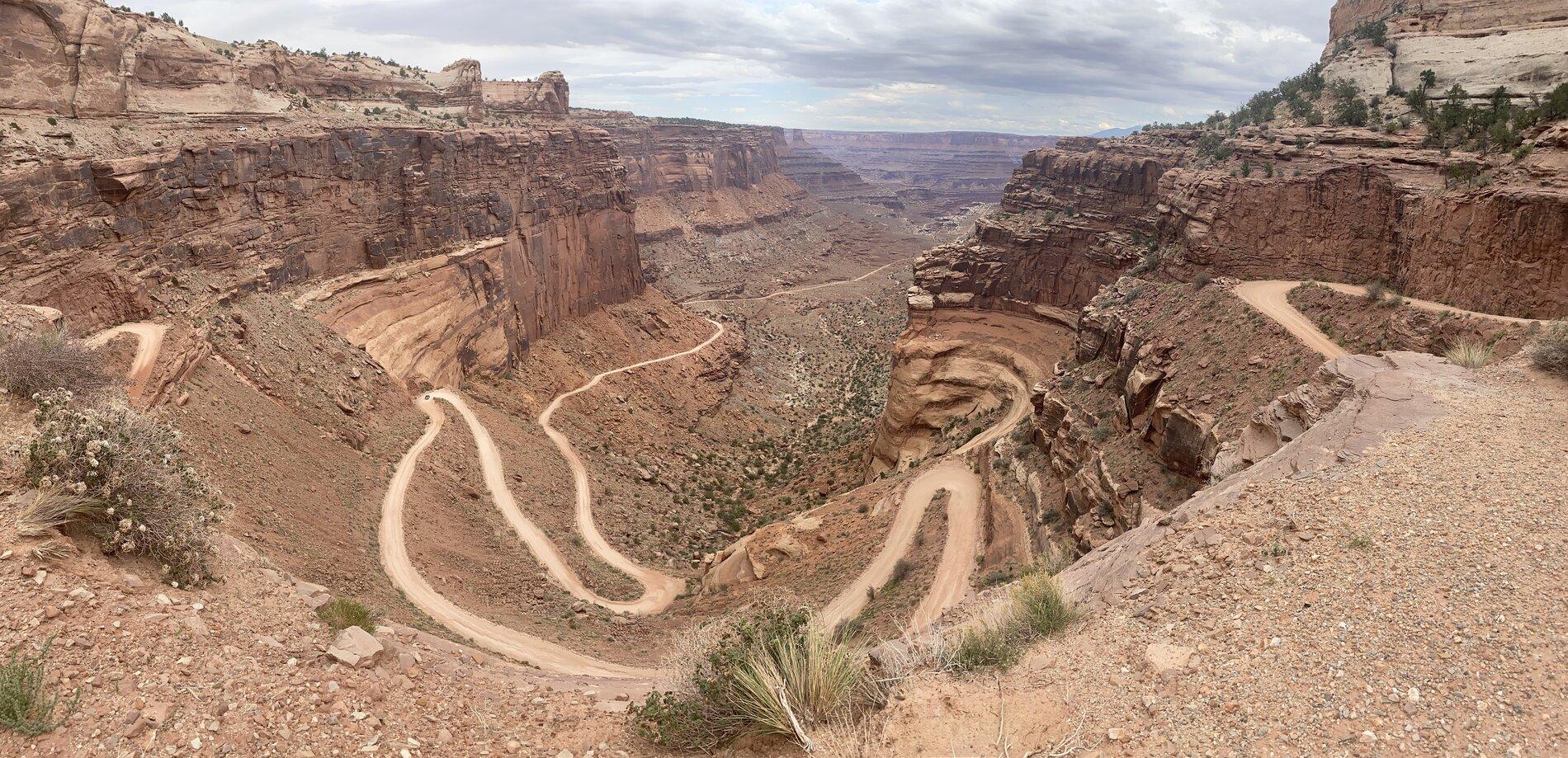

Great question!
We did the Shafer/White Rim near Moab. I experimented with a few things, 4-lo seemed like a bit too much whine for the wife going down steep sections. She kept saying I'm going to damage something lol.
Jeep Gladiator Steep Downhill w/Switchbacks in 4-Lo WhiteRim
I just put it to manual mode and switched between 1st and second. On Hells Revenge I used the speed select button on the 25-30 degree slopes and it works great.
To your point though, we didn't experience any adverse steering conditions. Maybe the surface was loose enough.
