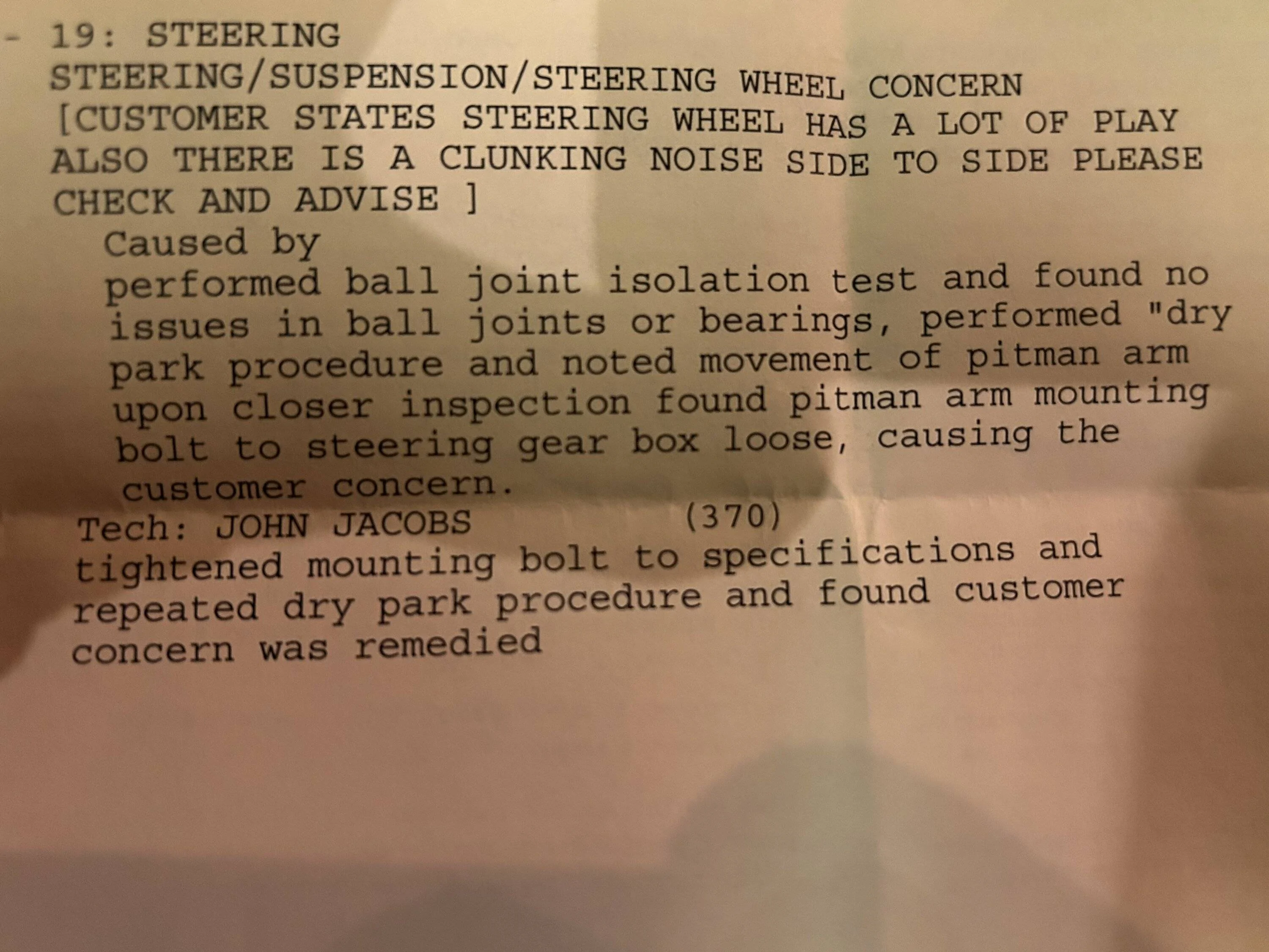

I'd say sector shaft nut. Just had one in the shop last week with a same symptom and noise.
We have a winner
Jeep Gladiator Steering clunk and dead spot help IMG_5751
time for a sector shaft brace
