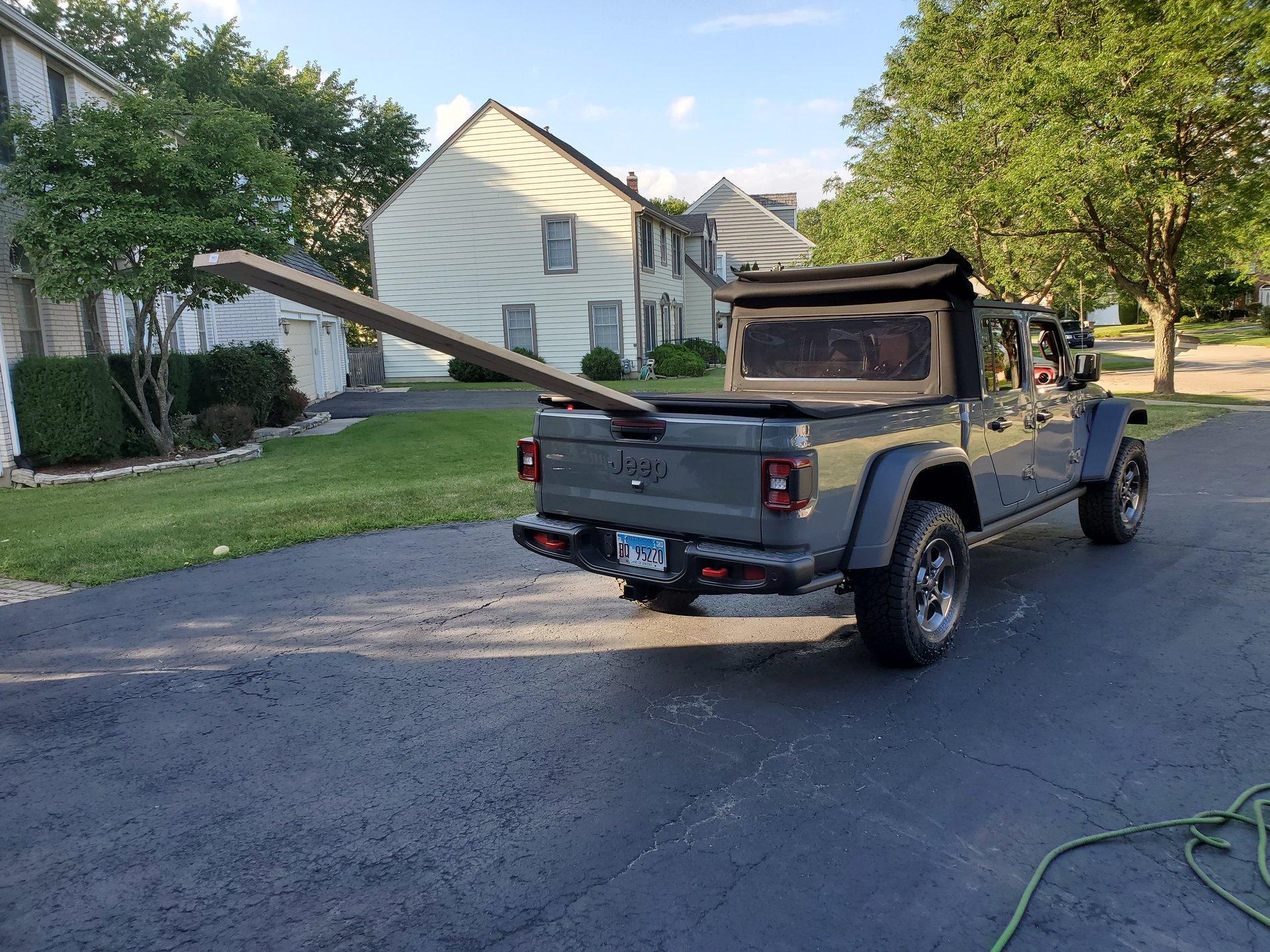

You must've ordered your JT with dual tops. Looks great with the soft top on. If I didn't own a Sting gray JL I'd have been all over a Sting gray JT.

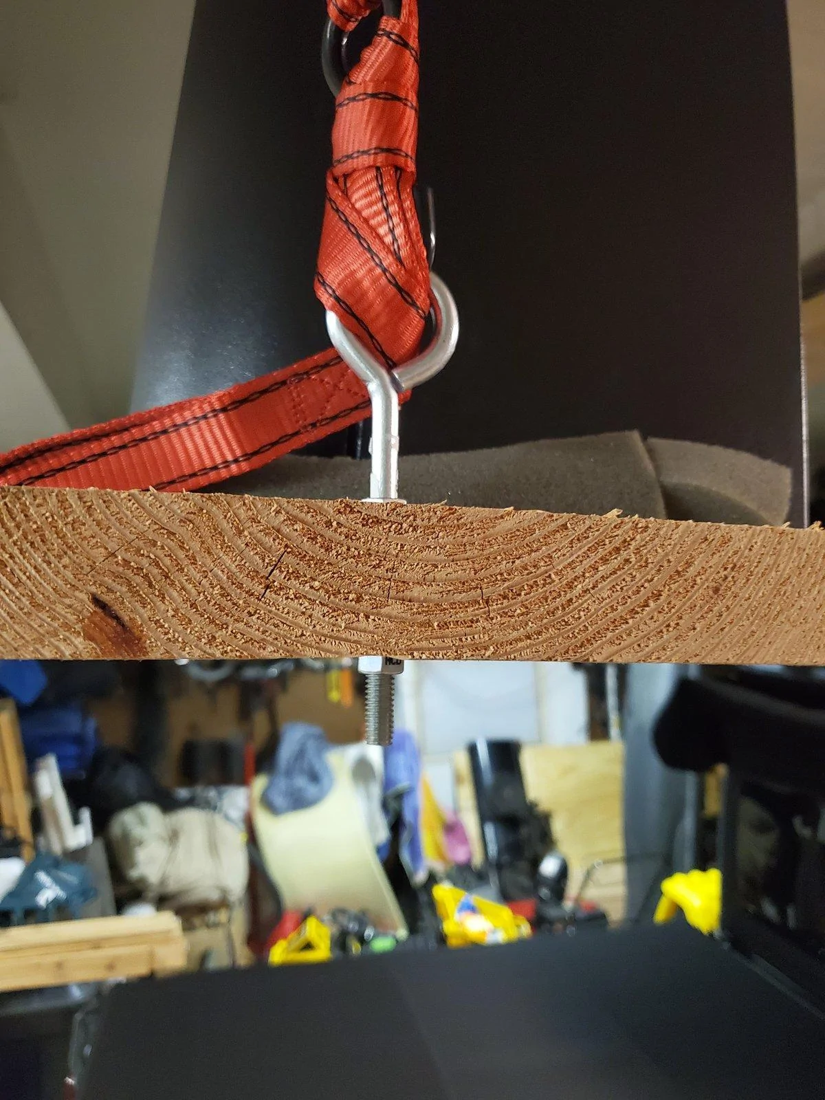

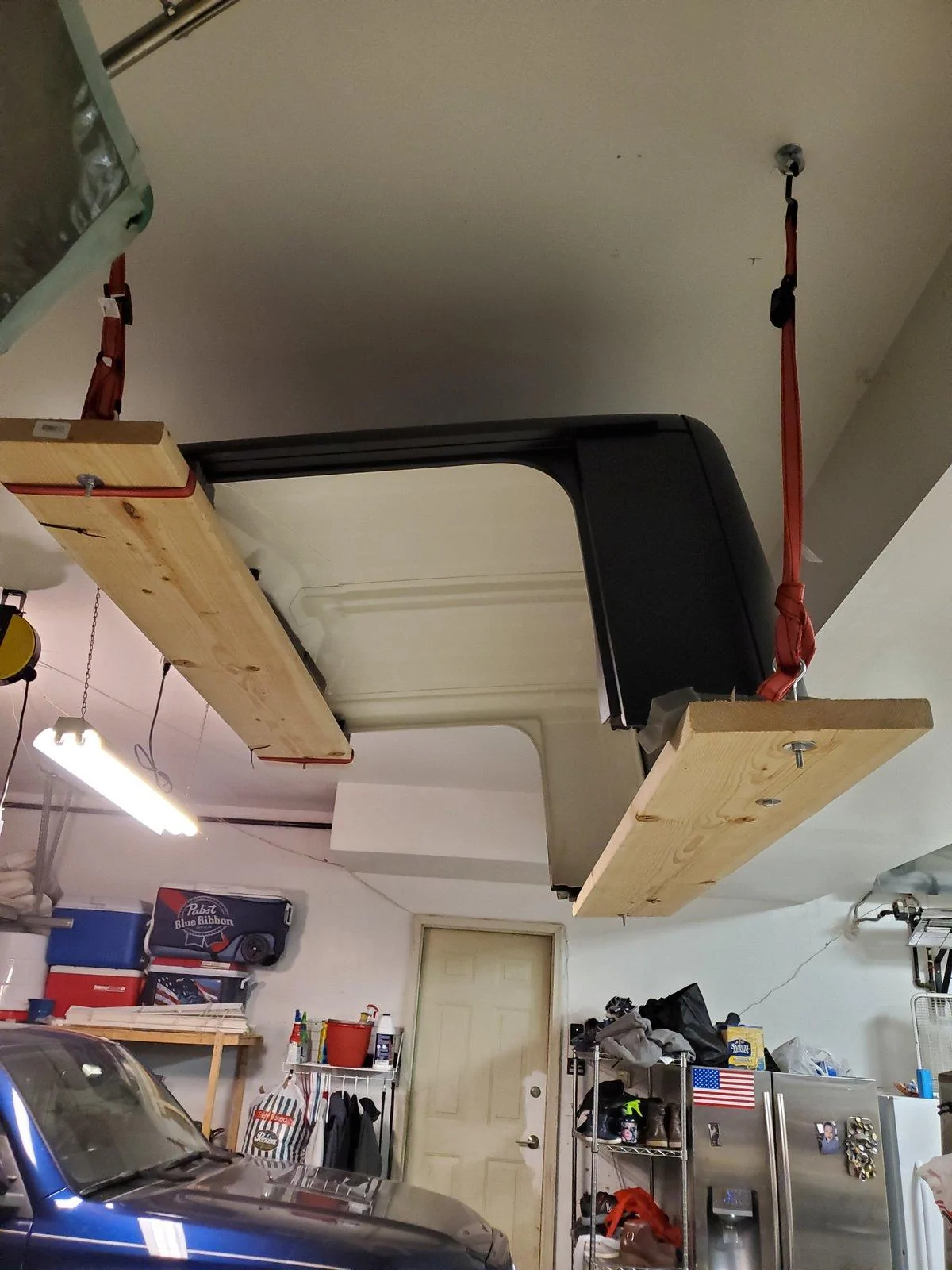

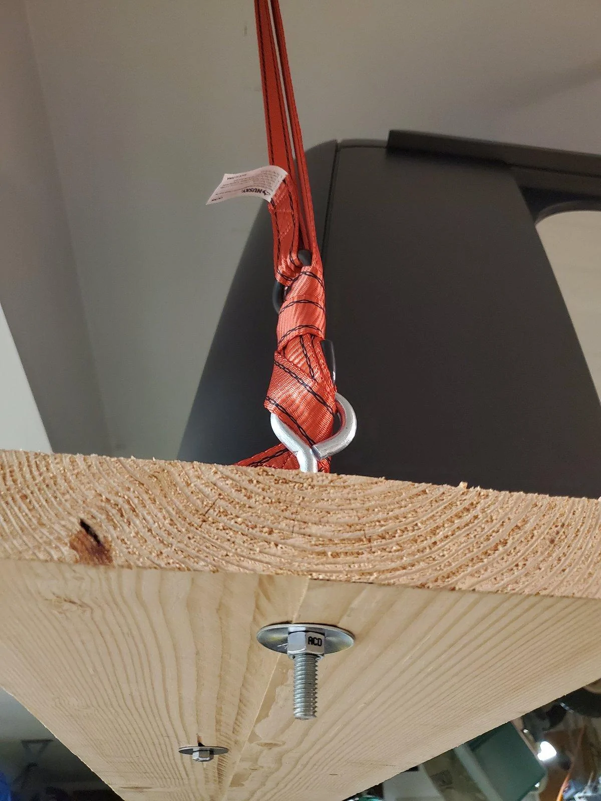

Do you have more pics of your hard top hoist and maybe elaborate on the set up and how it works?
I did order the dual tops. It gets cold in illinois, but I'll store it till fall. The topper lift was easy. Locate joists, drill pilot hole, screw in eye bolts, used 4 straps from HD that hold 600lbs each (overkill). Bought a 12' 2x12 because I wanted more bearing points on the topper. Cut the 12' 2x down to two sections of 6". Had some foam I put on the board for cush. Drilled some holes for eye bolts in the 2x for the straps to hook to. Oh and I added a hole for a zip tie strap to keep the topper on the board. Just for peace of mind while hoisting. It was kinda bich to hoist it, as I had to circle around with a ladder and do a strap at a time, but it's not like I'll do this every weekend. Just at the beginning and end of the season, that's why I did not waste the money and but the super fancy one. Alli have left is to figure out how to store the freedom panels up there too. Shouldn't be too hard. All in all, I spend under $50 for all the hardware, boards and straps.
