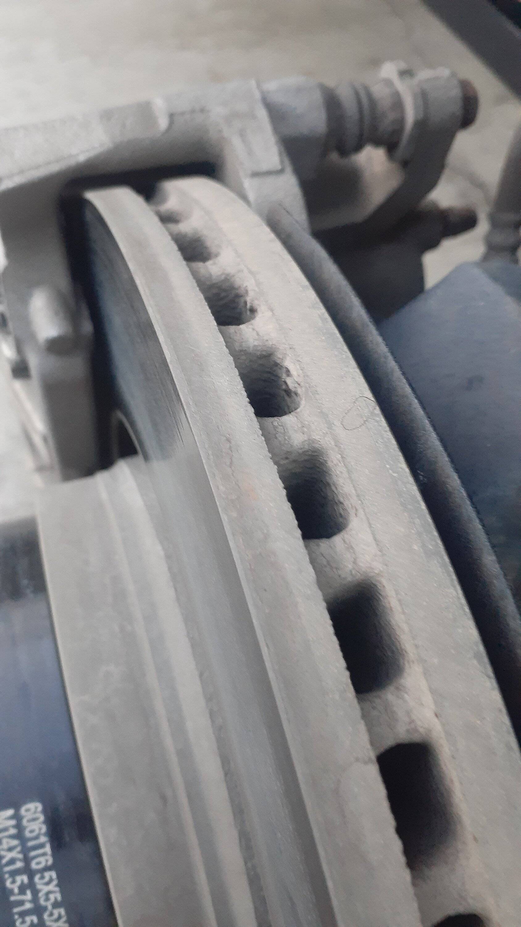

If there's been one thing I've been impressed with in this truck it's been the brakes/ rotors.
34k and through a couple sandy, muddy swamps:
Jeep Gladiator Stock Brake Pad Life Expectancy? 20230822_195400
