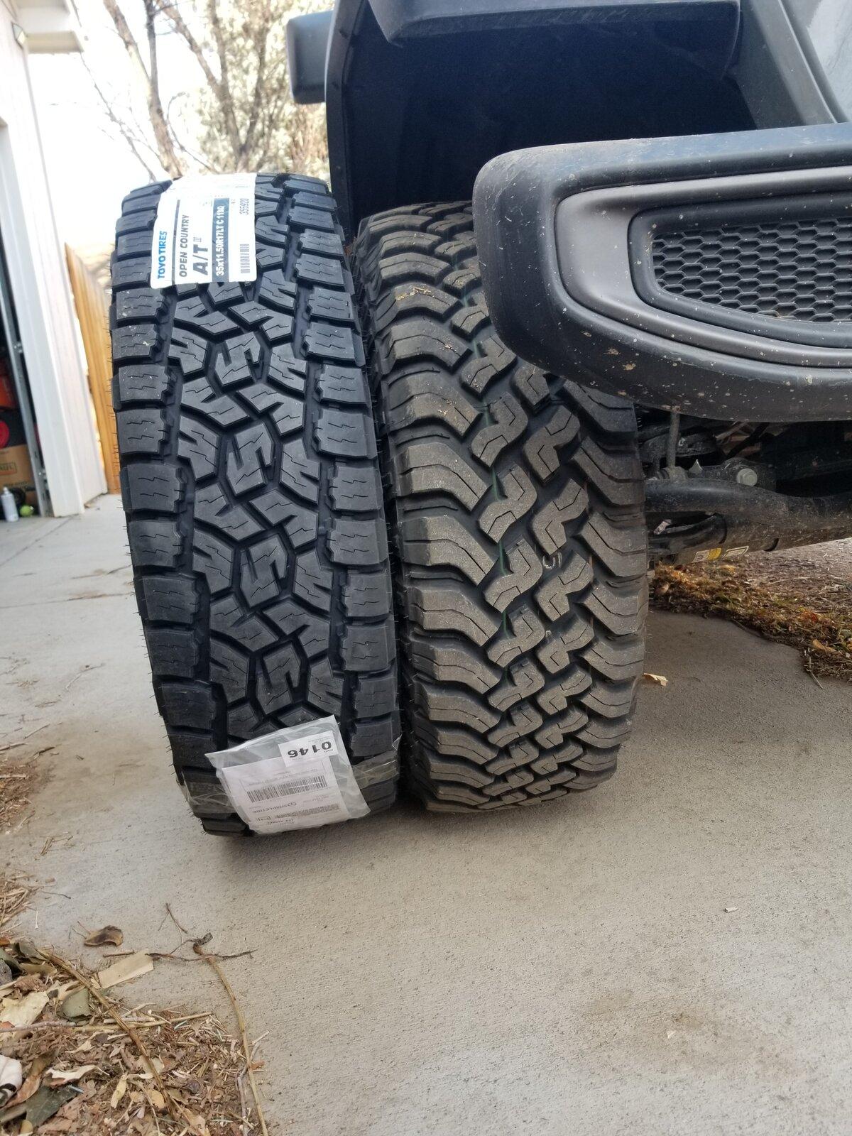

Mac- Have you had the Toyo AT III in the snow? I like that those are only Load C but concerned 11.2" is too wide for traveling on snowy roads. 255/80/17 (33x10.5) would be perfect for me but I dont want a stiff ride with only Load E available.
We haven't had a ton of snow, but had a few bouts of 2-3" so far. I'm pretty impressed by the ATiii's so far. The 11.5" wide ATiis are nearly the same width as the 285/70/17 Falkens that came stock. I haven't had any issues "cutting" through the snow.
