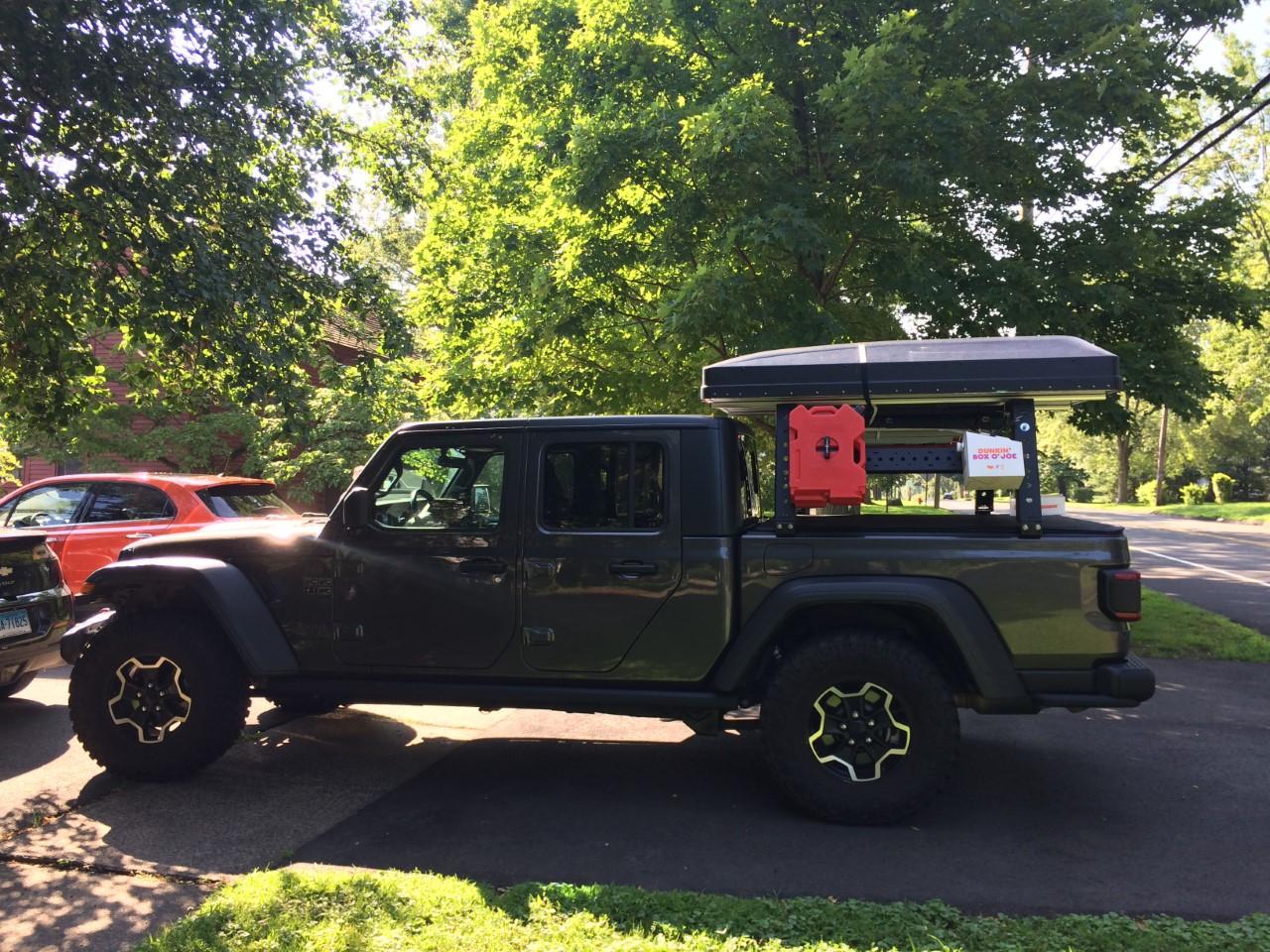

Stock Rubicon-
Nitto Trail Grappler M/T 315/70R17 D (34.61 x 13.27) [77] $370
(The 13" wide must be counting the side tread.) At wheel lock, light rub on inner fender, easy fix; slight rub on lower control arm-not enough to worry about.

Stock Rubicon-
I have an exact model you have that I just got it, mine is front 1.5in spacer leveling installed, I love my rubicon stock wheel and debating if I should get new wheels but saw this. rubicon stock wheel fits 315x70x17 with no issue? thanks
