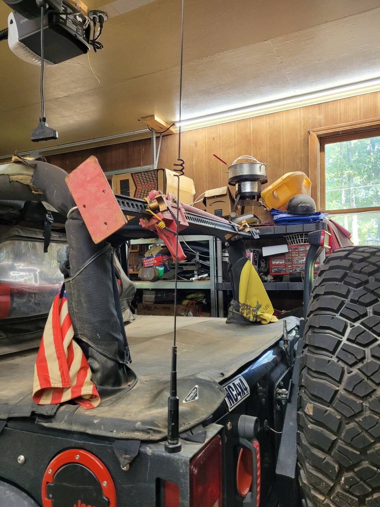

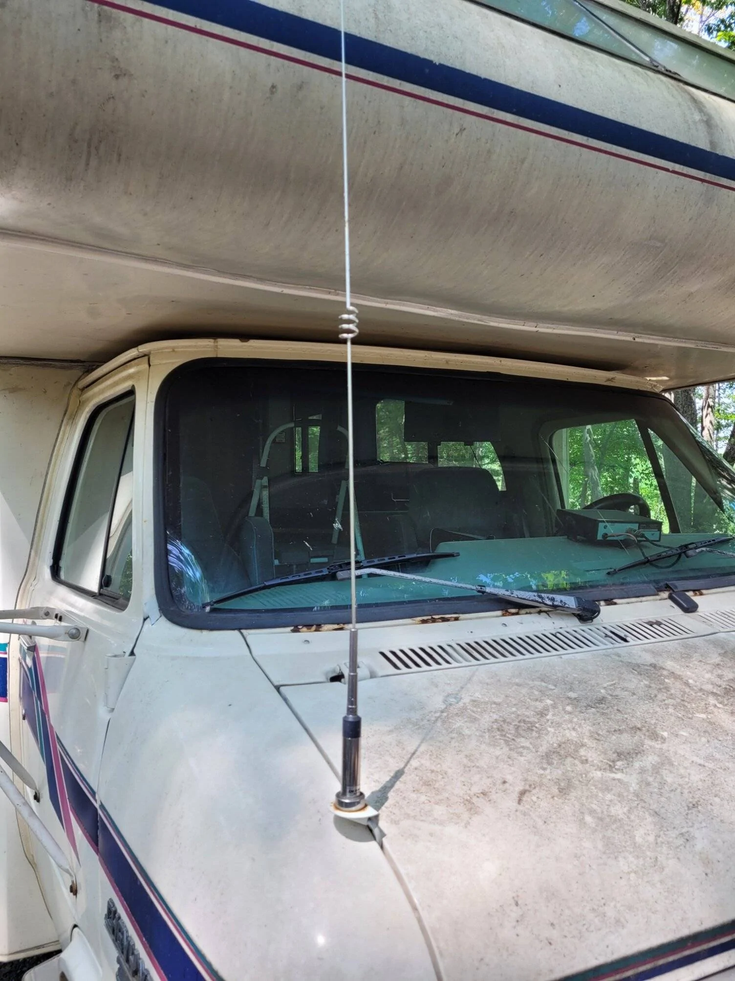

I use a Diamond 770NMO antenna. It is a no ground plane antenna and I use it on all my Jeeps and on my Class C.
However it is not specifically a GMRS antenna, it's a dual band ham antenna. It does work well for GMRS though. GMRS is 462 MHZ, 70CM ham (voice) is centered around 444 MHZ. Because I have access to an antenna analyzer, taking about 1/8th" off of the antenna gives me an SWR of 1.1-1 across the 2M band, 1.2-1 across the 70CM band and 1.4-1 across the GMRS band. Caution, don't buy one and just trim it without having a SWR meter or an antenna analyzer. What worked for me might not work for you.

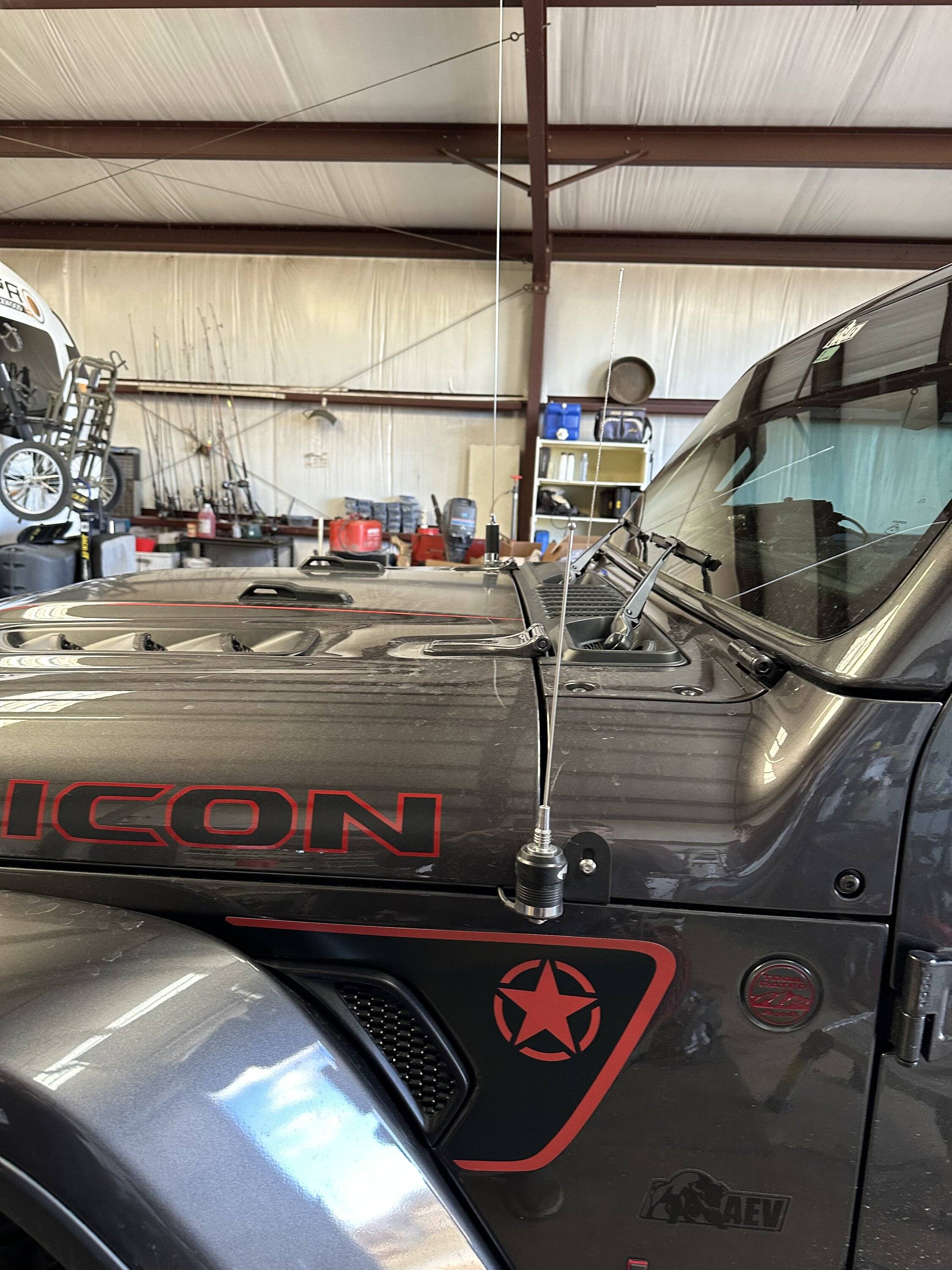

Midland makes a hood mount that I find works well.

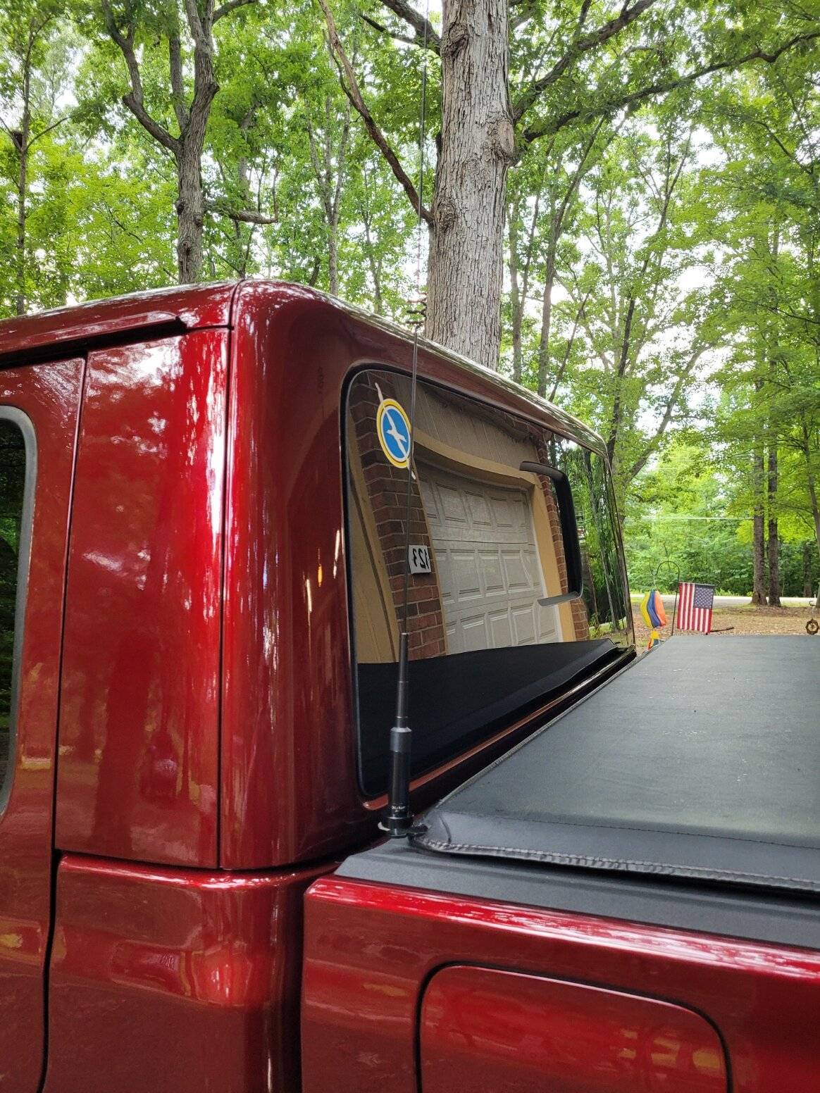

There is a member that put a stubby antenna on the center rollbar. The soft top cleared it and he said there wasn't any interfere as far as transmission/receiving goes. So, what short antenna with magnetic mount do you guys suggest?
i run rugged radio mount antenna on L side of my jeep fender side cowel luv it

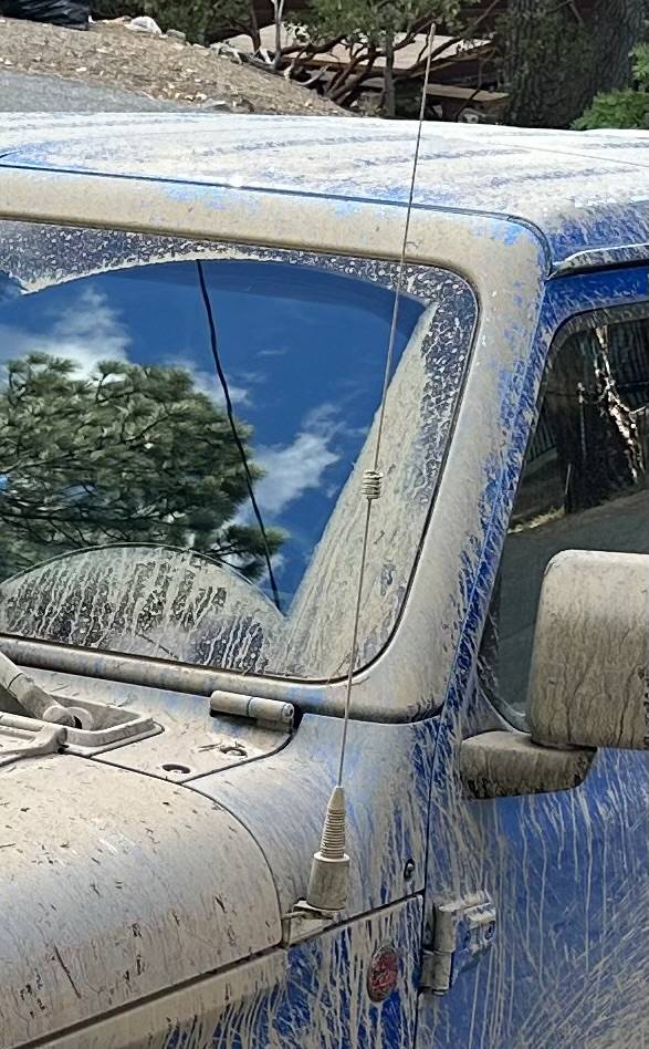

Antenna:
Midland – MXTA26 MicroMobile® 6DB Gain Whip Antenna – Quadruple Signal Output – 32” Antenna https://a.co/d/3jOffQs
Mount is off the driver side cowl. See picture. Ignore the mud, this was the easiest pic to find.

That antenna requires a ground plane. You have really no ground plane for that antenna and I wouldn't be surprised if the mast of that antenna is too short. While that antenna is advertised as set from the factory, many have reported that it is not and in trying to tune it, they found the mast too short.
The antenna that @xman1564 has is a NGP antenna sold by Rugged Radios (and others). Look here for no ground plane UHF antennas.
https://theantennafarm.com/shop-by-...nnas/300-512-mhz-uhf/no-ground-plane-antennas
