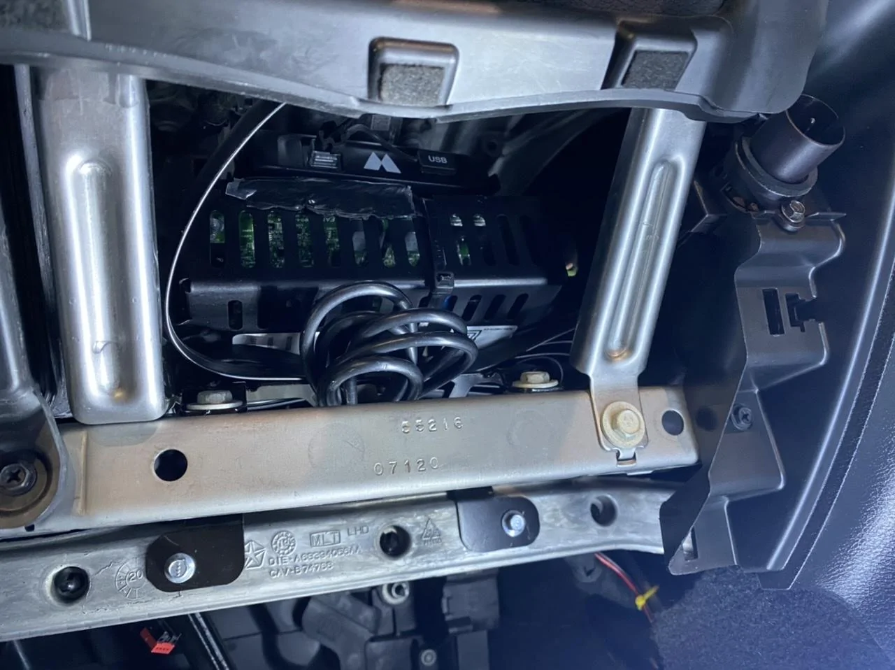

I’ve got the MTX275. I mounted the antenna inside my snorkel and the black box behind the glove box and off to the right. I was to use double side tape to kinda wedge it in that area. I only used it at the Jeep jamboree, but it seems to work great. For power, I tapped off the back of the cigarette lighter. Sorry no pics, but if I feel ambitious this weekend I might take some pictures.

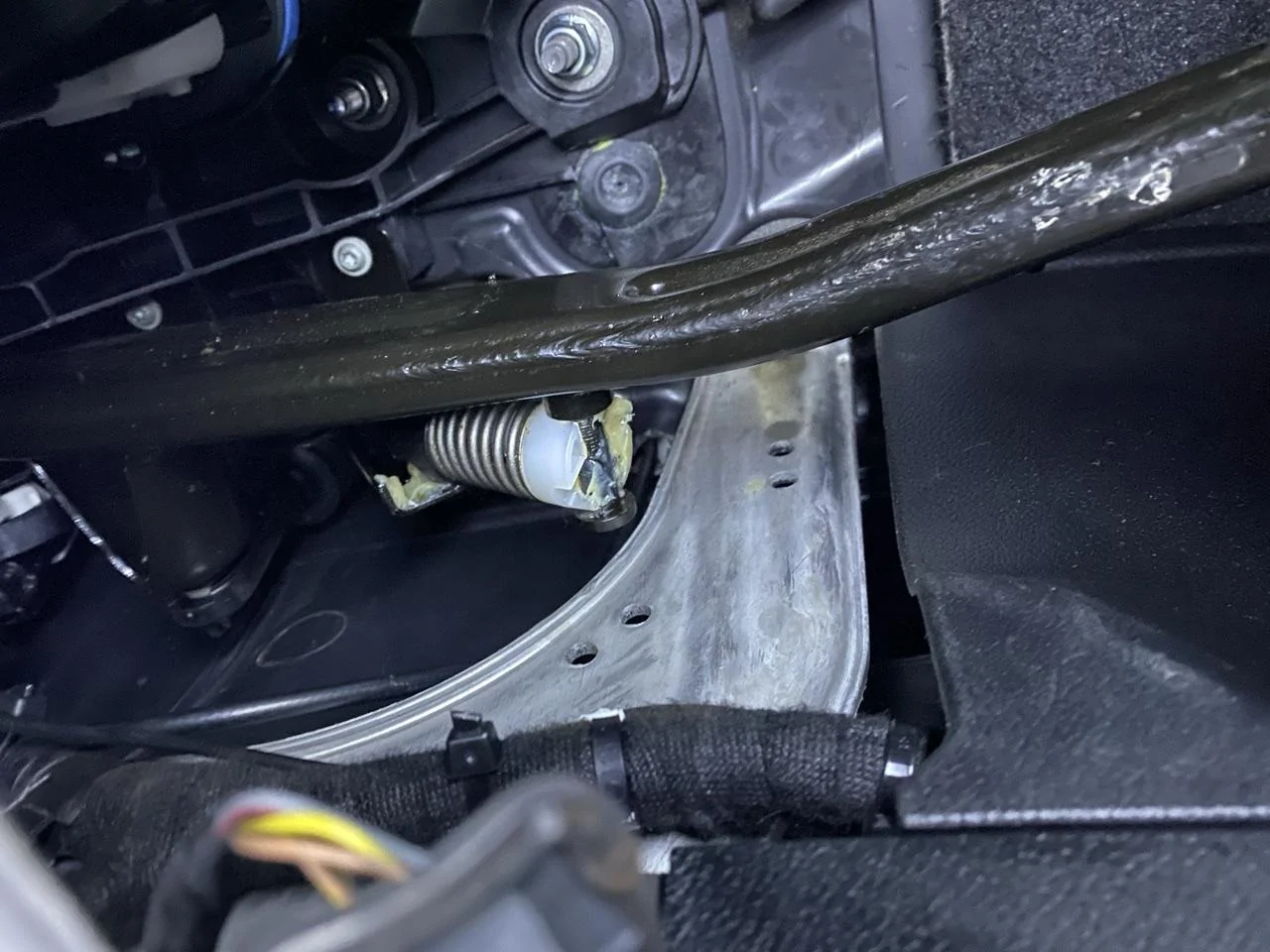

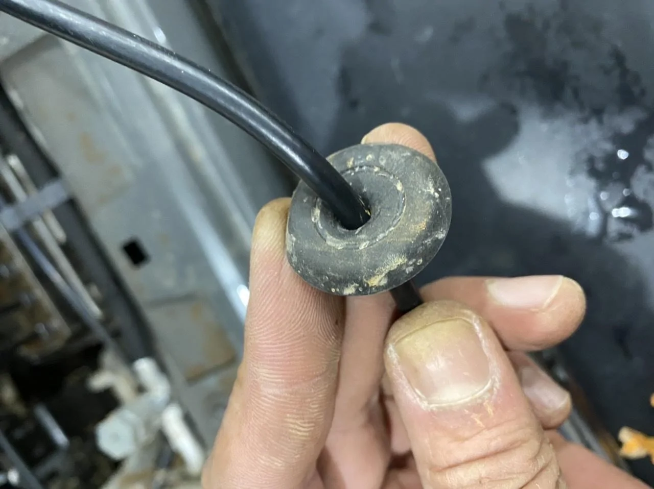

And yep, ran through a grommet under the brake booster/clutch and then poked a hole in the plastic firewall cover on the inside. (In the pic just aside the spring seen)

Another option for going through the firewall is that round plug above the hole you passed through. It has 2 tabs you grab and give a quarter twist to remove. I drilled a hole through center of that, passed my antenna cable and reinstalled. You can see the hole from drivers footwell, no fishing wire needed.

Did you run the antenna cable next to the power through the same hole?
