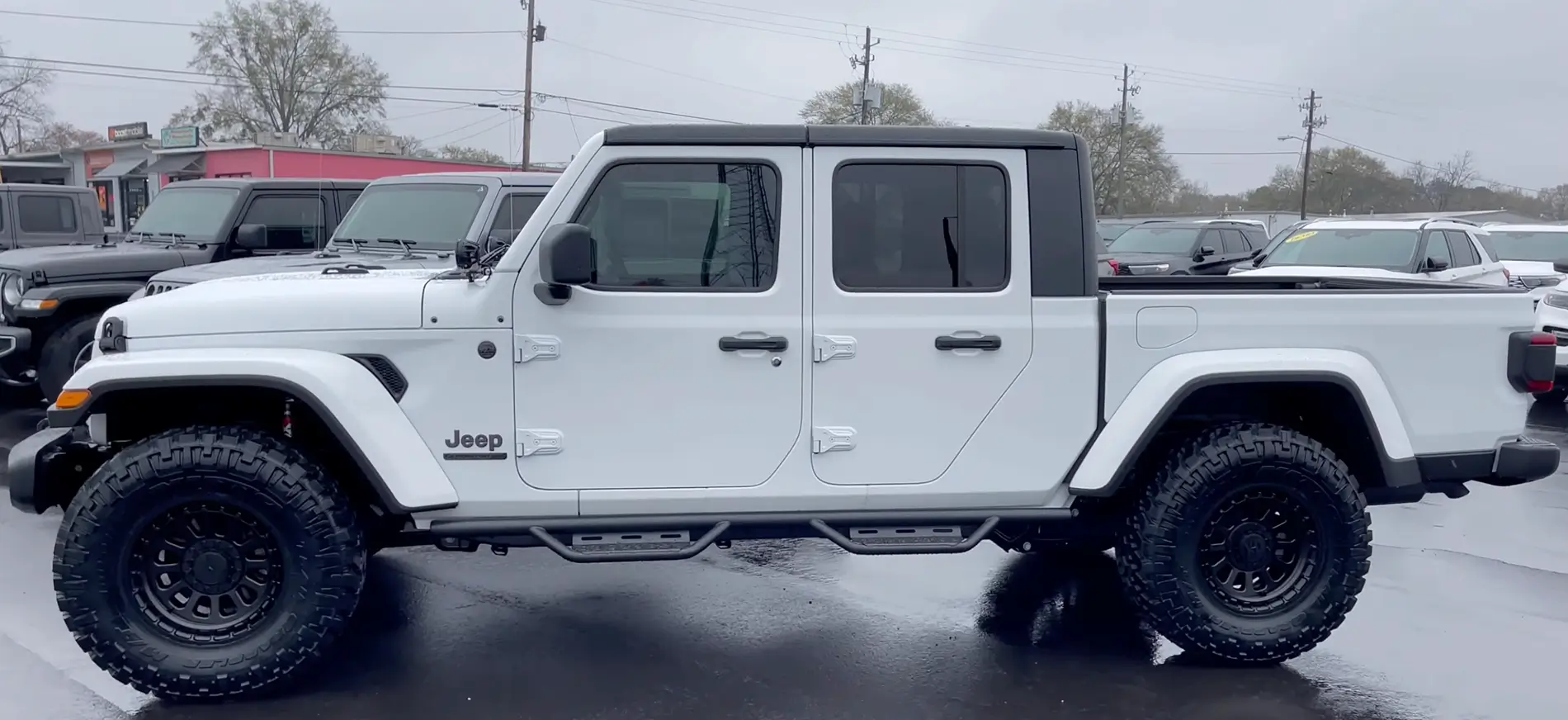

Thanks for the feedback. I pivoted on the leveling kit and went with 1.5" Daystar pucks. I came across a video on YouTube of the truck below, and that stance is exactly what I'm looking for. It's almost perfectly level with just a hint of rake, and the wheels fill up the fender wells a little better than they do with the Rough Country kit.
Also, I'm going to roll with the 35s. There are about eight different options to choose from in 35x11.50R17, so that's my next decision. I want white letter tires. Only Venom Power offers those in that size, and I've been recommended to stay away from that brand. I'll have to get a couple of paint pens to take care of the letters myself.

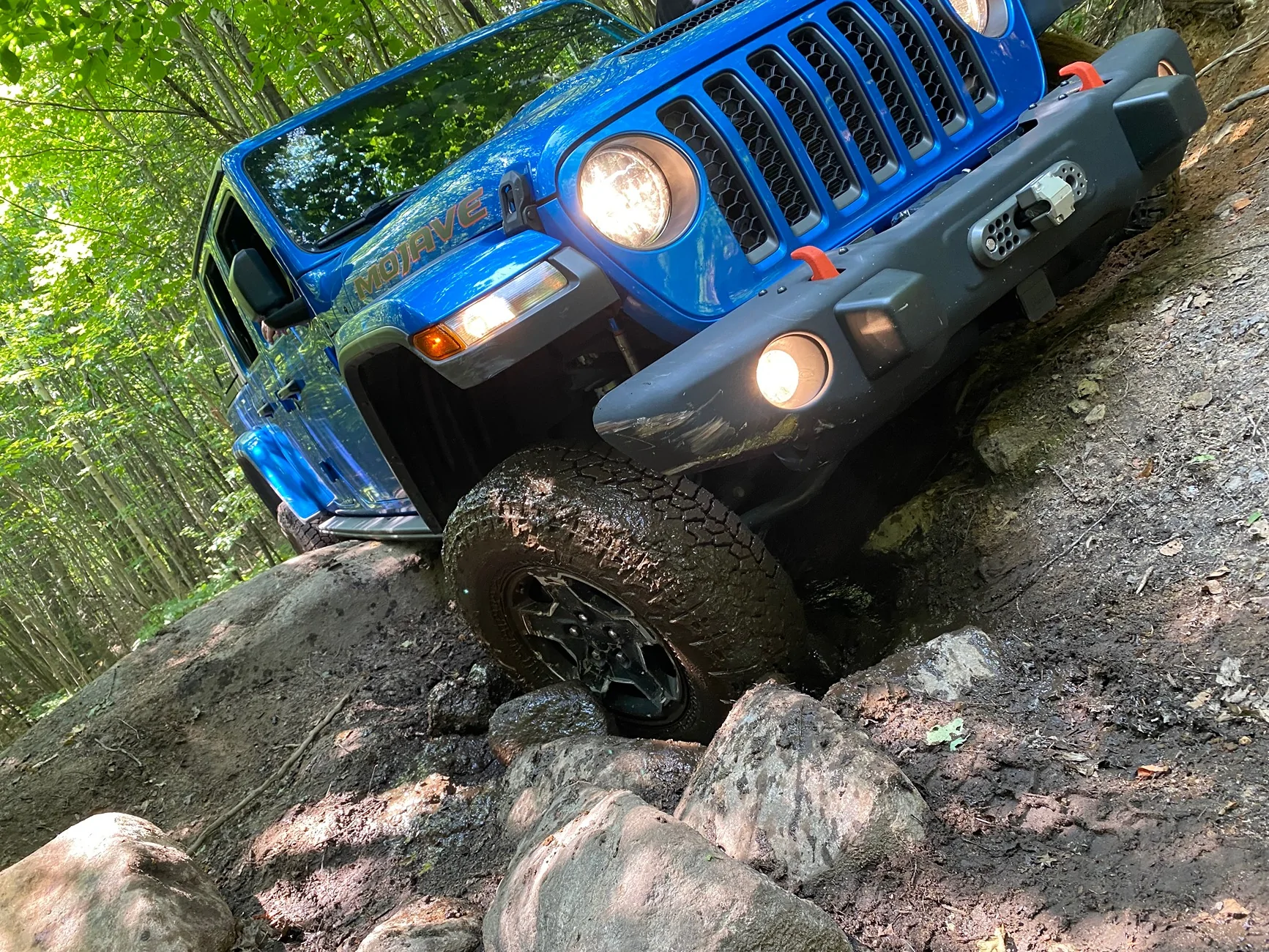

I’m a raised white letter guy , I’m one of the few at work with raised white letters on my company truck, be careful of what you decide, I’m almost 69 and wheel more now then I even did with my 46 CJ2A, meeting up with others on this forum has been great, but raised white letters and wheeling are not compatible. I also went from factory 11.5” tires on my Mojave to 10.5” tires love the steering feel , lighter weight and they do fine wheeling. This picture shows what some wheeling in New Hampshire was like, look closely you will see my wheel scratched up by the round now shiny rock , my wheel is a better Badge of Honor then the ones on side of my truck. Nice looking Glady you have going on …..Jack

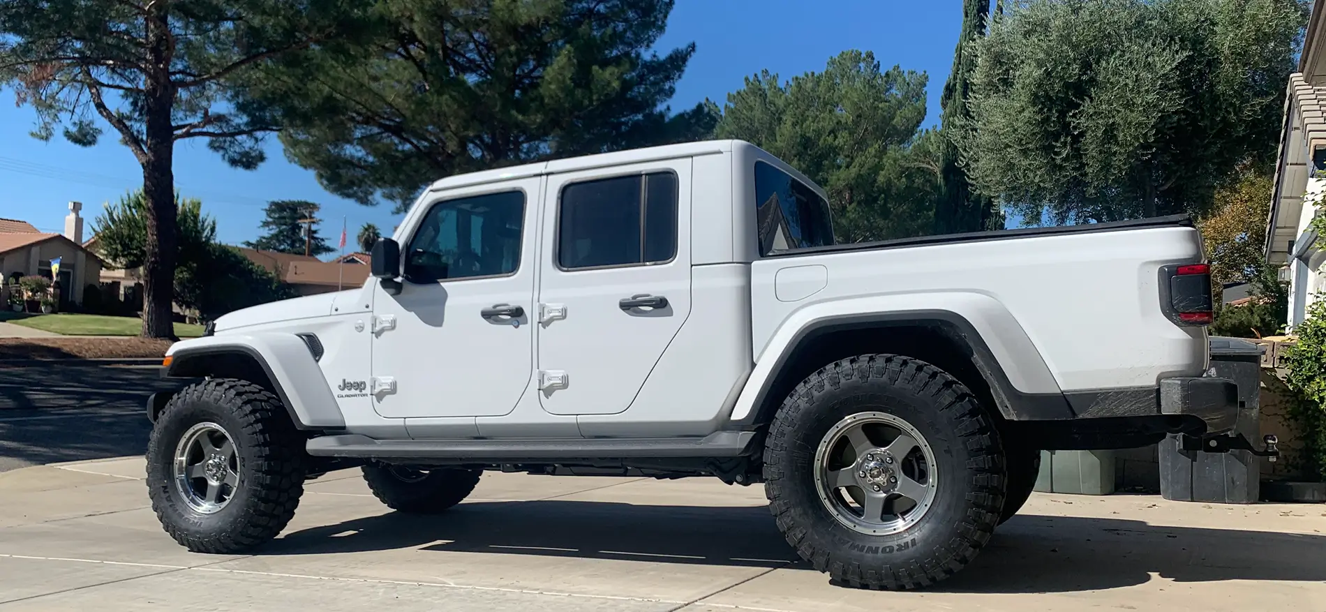

You could really stuff the wheel wells and just go straight to leveled on 37s 👍🏻
That looks amazing, but the more I look into it, the more I don't think I can do that with 37s and the stock wheels. I think I'd have to use wheel spacers, and I'm not a fan of those.

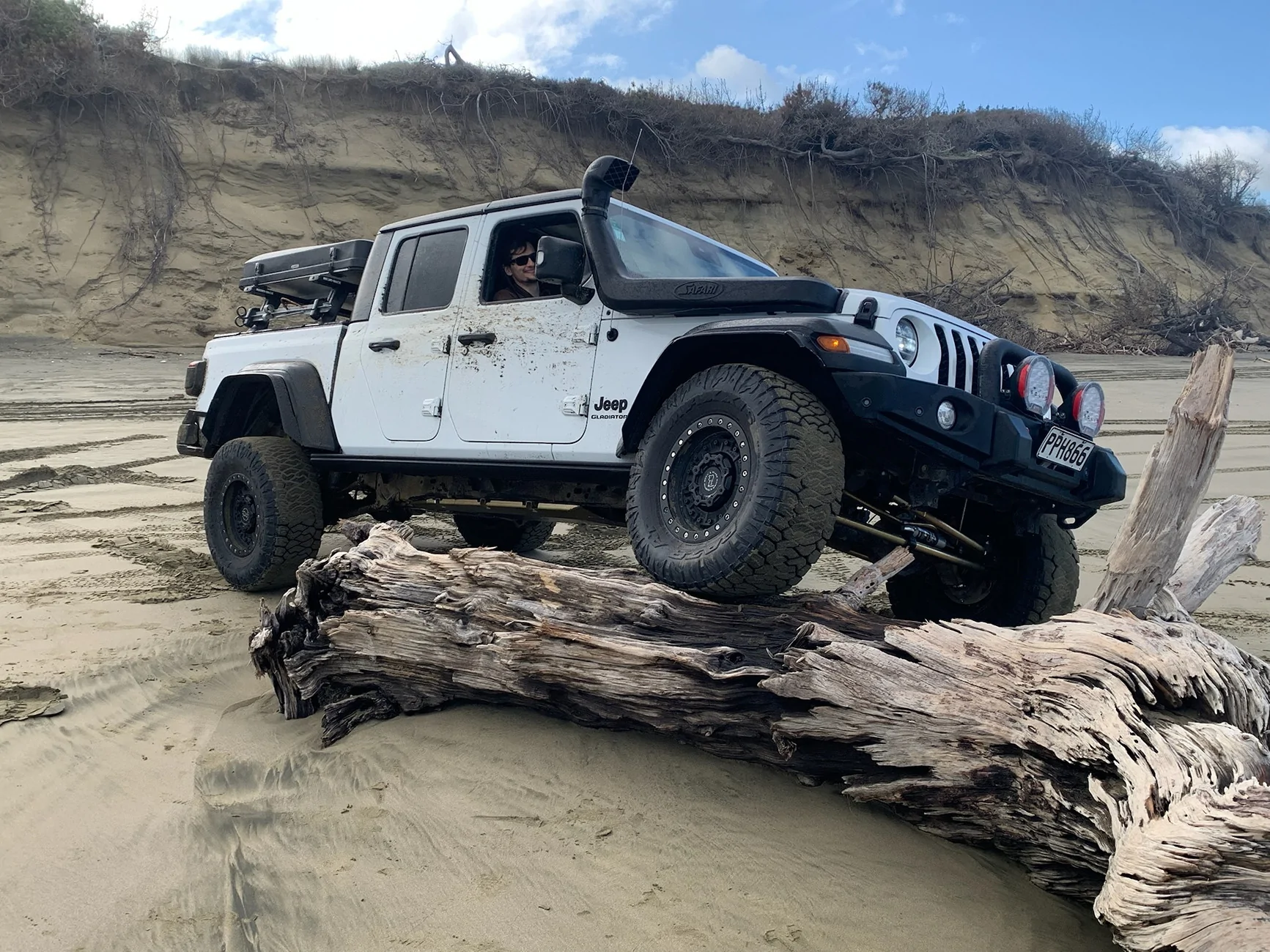

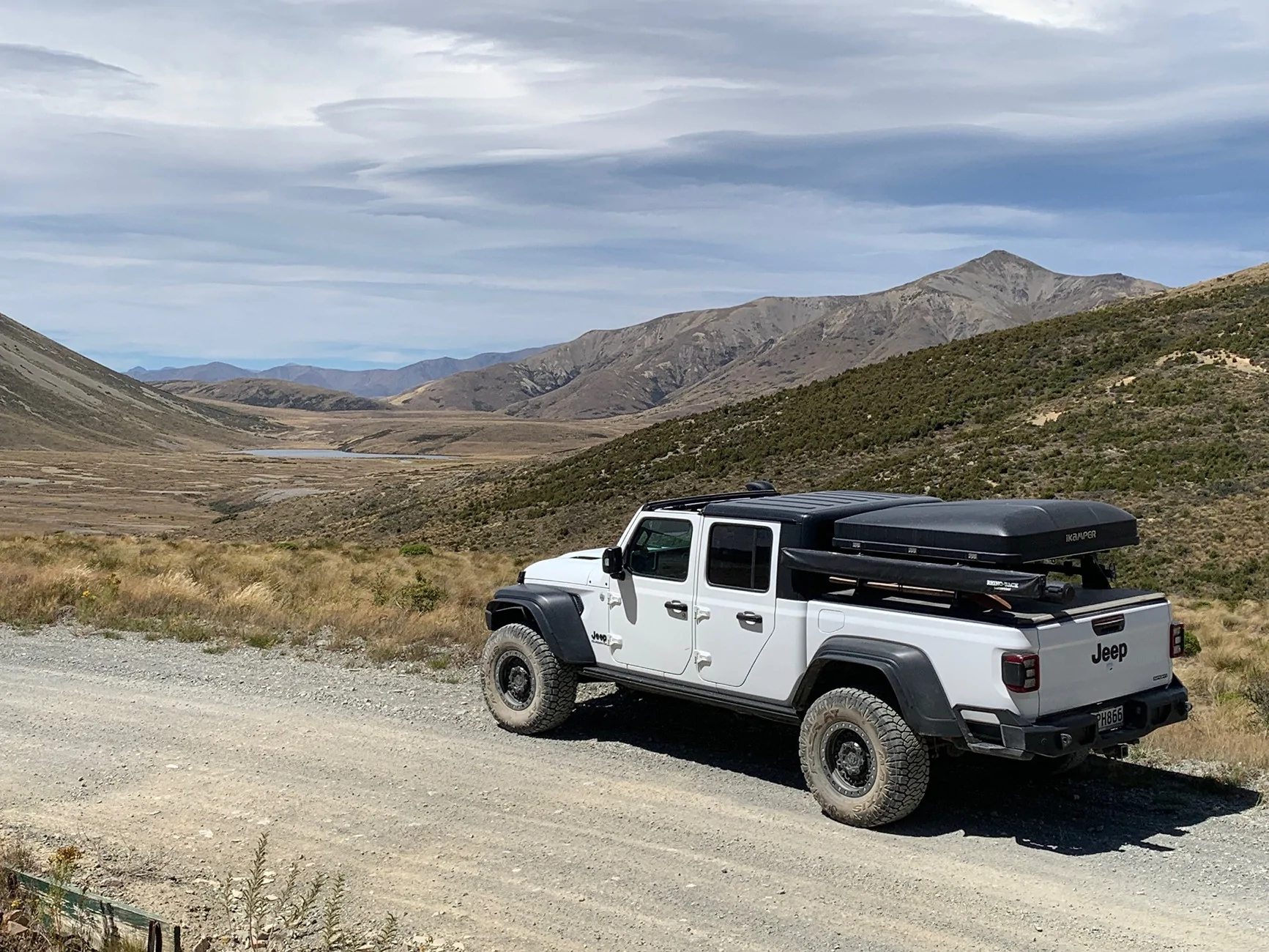

I don't usually post, but it was interesting to see the white Gladiator similar to my own. I was new to Jeeps when I bought my 2021 Sport, but after a while I decided that I looked like a dashund and needed longer legs. I went with 17x9.5 Black Rhino wheels and Maxxis 35x12.5R17 RAZR AT tyres, plus Xtreme Gravel Gear 2.5-inch Pro shocks. We don't have much rock crawling where I am, but I've done almost everything else imaginable in terms of offroading. I learned the hard way that I needed to upgrade the steering components after getting death wobbles when several thousand miles away from home. I went with Metalcloak everything, and decided to get the Undercloak armouring system as well. Then the brakes wore out early and I swapped them with Powerbrake big brakes. I think I'm all sorted now, and haven't had any trouble since. I've seen all the talk about 37s and 40s but have had no trouble with my 35s. I've attached a couple of pictures.
