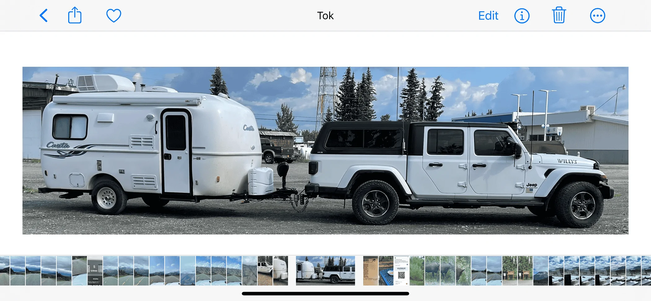

I am interested in getting a camper for my 2020 Mojave . Any suggestions?
I was content with my Casita, from Florida to Alaska and back. No problems on the way except a screw popped out on one of the shade mounts. 14000 mile trip!

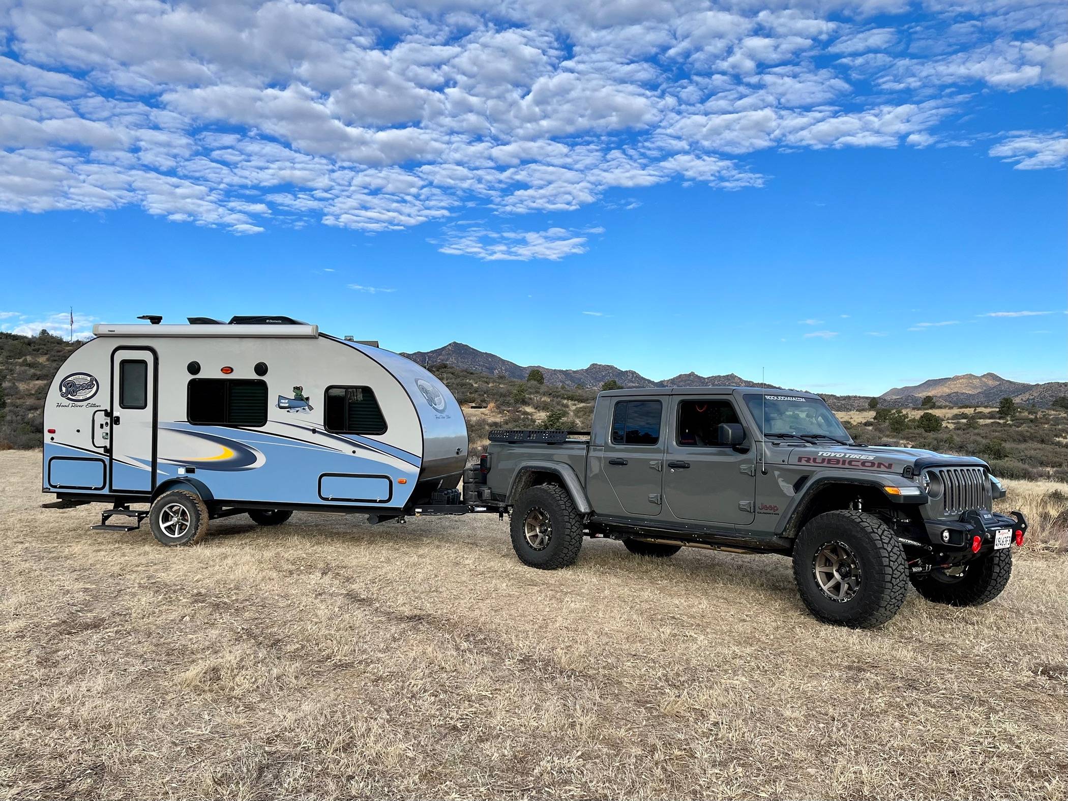

R-Pod 180 is lightweight and a great design. Has a dry bath, can still use with the slide out in, and decent storage. The only issue is bed length. R-Pods are narrower design for weight savings, areodynamics, and damage avoidance. Therefore the bed is a “short queen”. I would say you need to be under 6 foot to use comfortably, or sleep fetal. We have towed ours thousands of miles and love it. We bought used and did some upgrades. Huge forum for support and ideas.

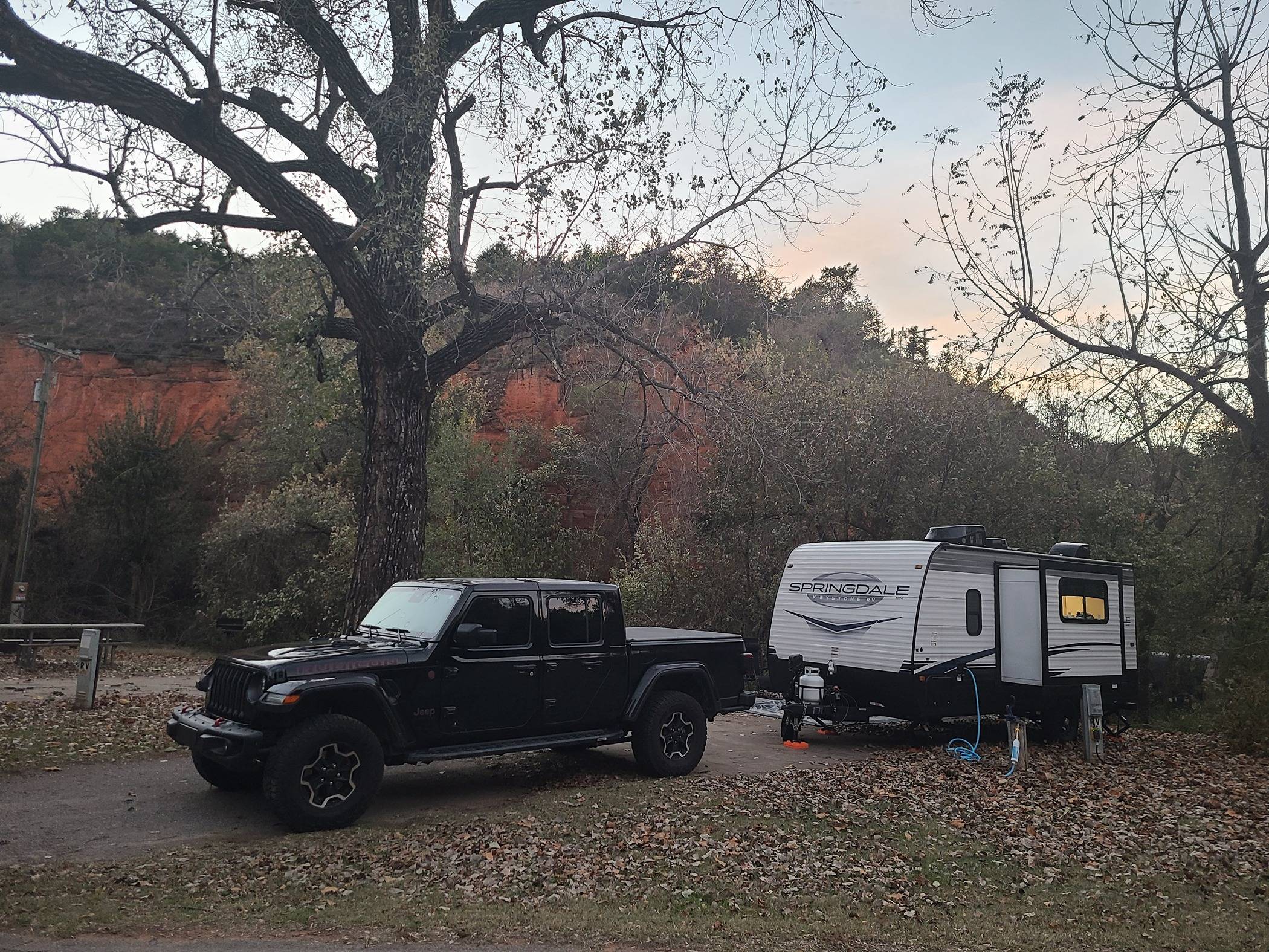

2023 Springdale mini 1740RK. 4020 pounds dry, run just under 5k after loaded. Changed shocks and steering dampner to bilsteins. About 9-10 mpg, usually do 65 mph, but no issues with 70 on main highways. Plan on getting fuel every 150-170 miles, unless you want to chance it. I carry a 2 gallon can in the bed just in case. Be sure to use a good weight distribution hitch and trailer brake controller. We are happy with this setup, i personally wouldn't go much bigger or heavier, but thats a personal choice because you could. This set up feels good and stable for our needs. Good luck!

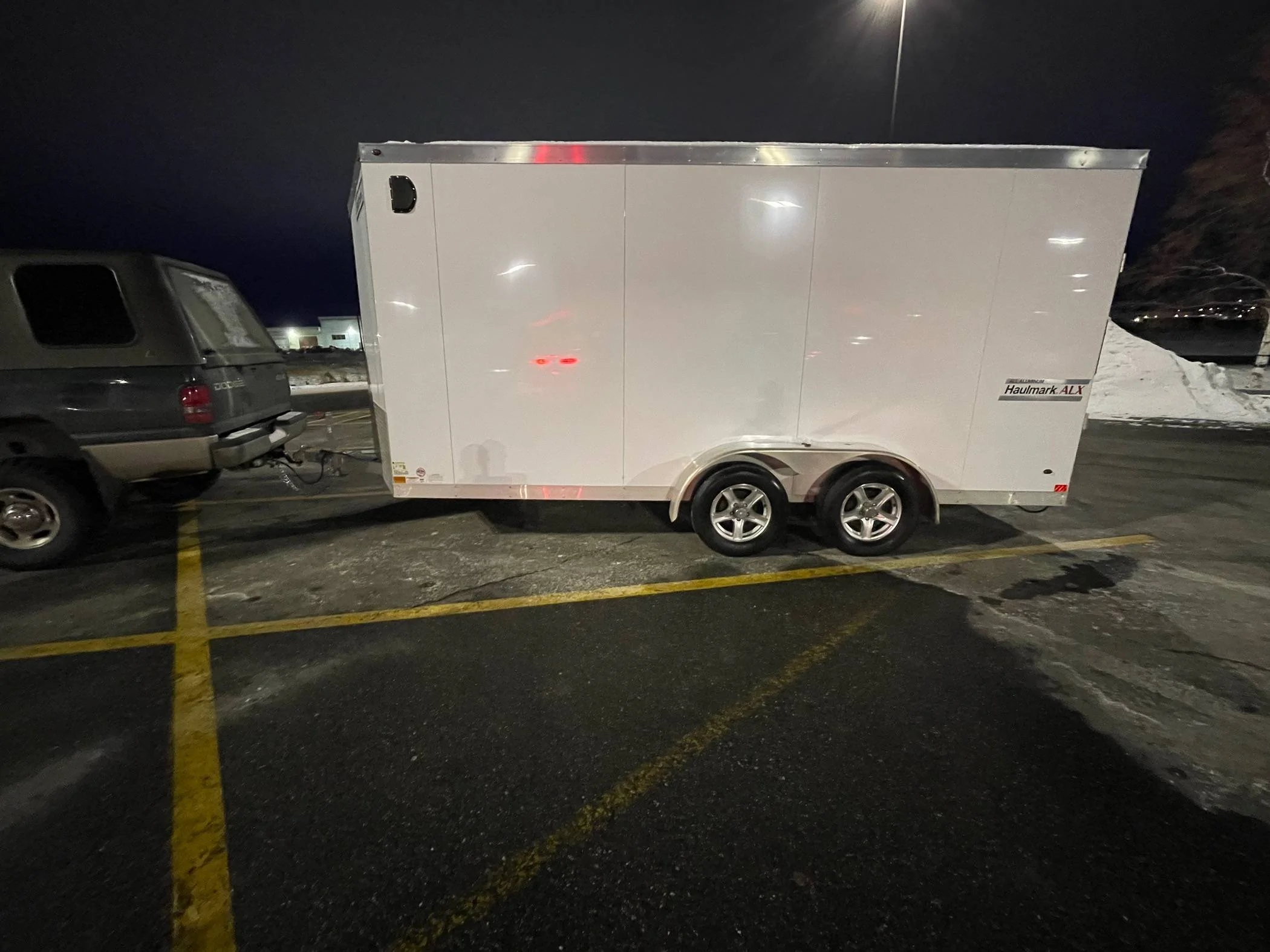

I’m going with an enclosed 16’ (18’ to the V). Trailer has a rear ramp and is aluminum (lighter). I can carry ATVs, canoes, bikes and use a sleeping platform, above the toys. (e channel).
Jeep Gladiator Suggested campers? D4368117-555F-4DE0-8362-2A0864387B0D
hooked up to the dodge Cummins here, will be using the JTRD on future trips…
