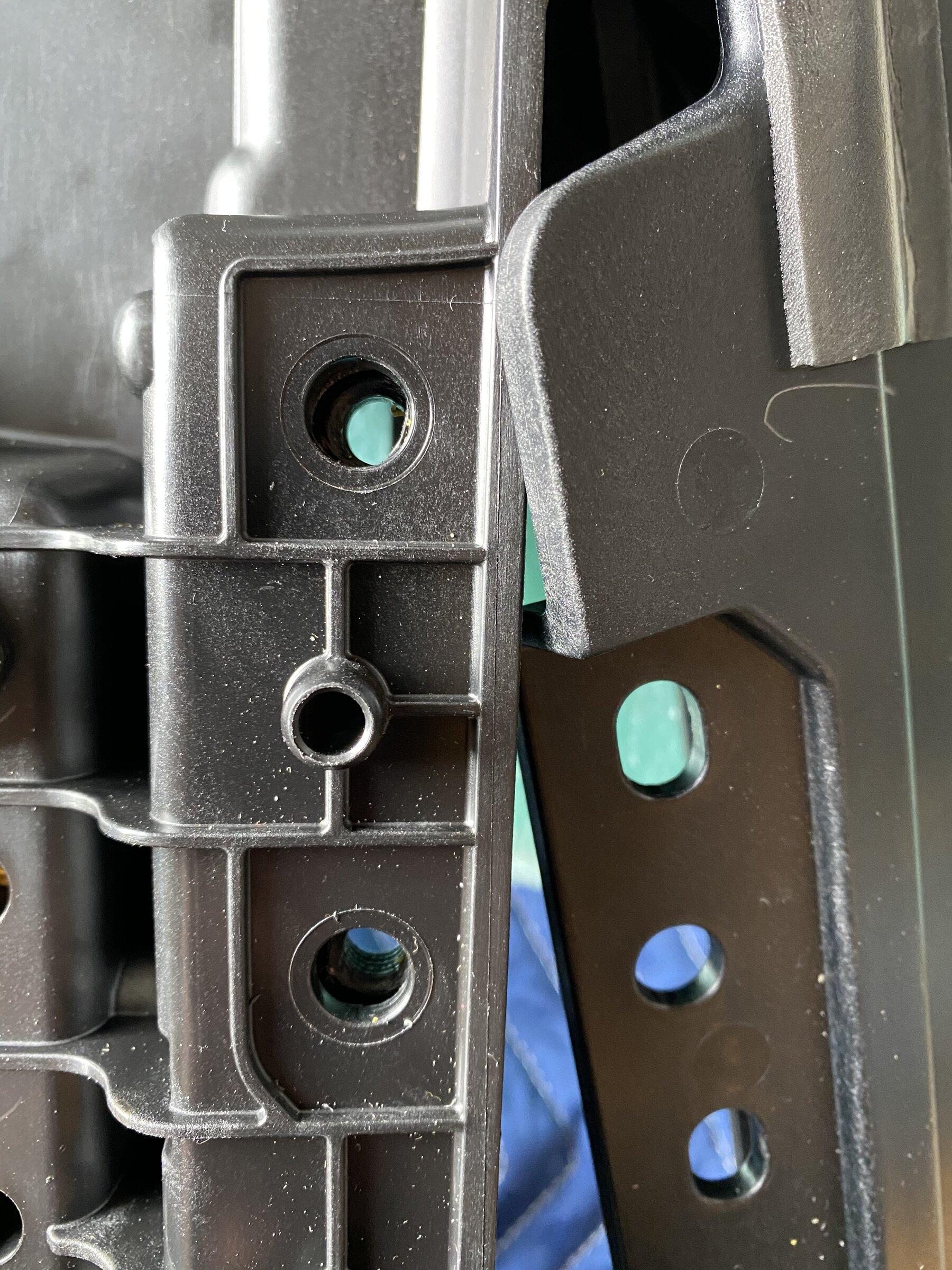

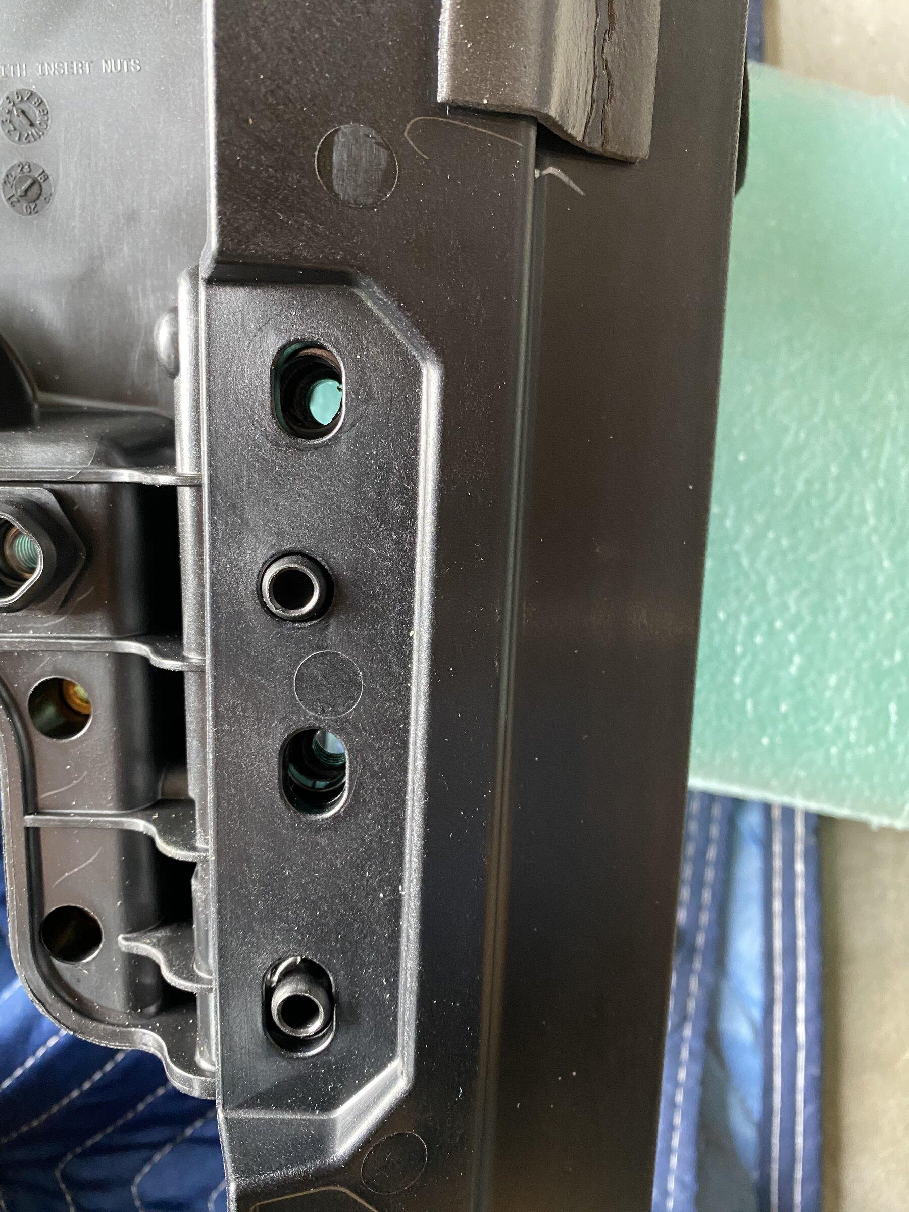

Just installed mine yesterday and had the exact same problem with the drivers side door rail. The pins dropped into the holes. But the holes don't line up to allow the bolts to go through. I tried with everything loose and was able to get the front bolt in. But the back bolt will not go at all. Zero issues with the passenger side. Everything went right in with ease.

I tried to take some. Here’s a couple but its hard to get the perspective. The holes were winked.
My top looked just like that on the driver side if I remember correctly. I use my diegrinder and opened up enough to clear the bolt. As much as it cost you would think it would be perfect ?
