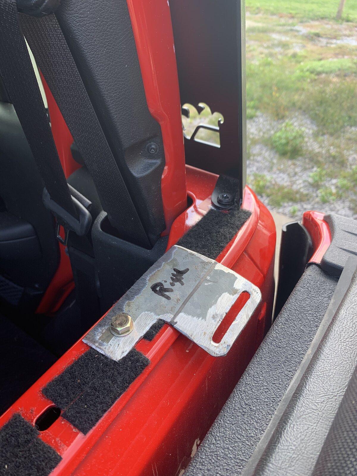

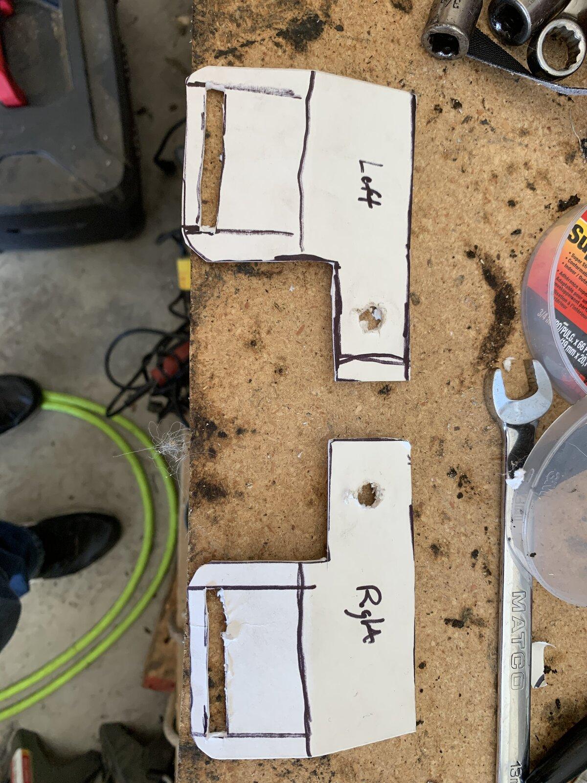

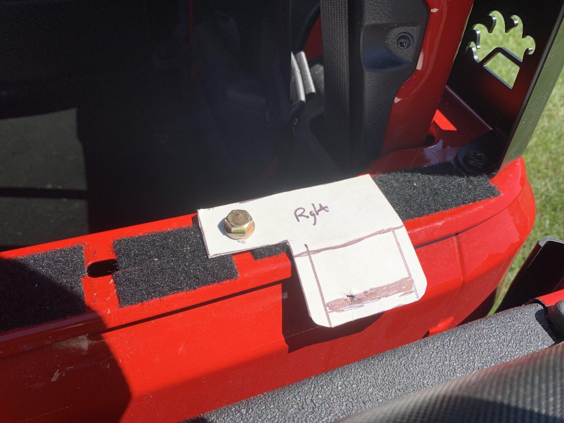

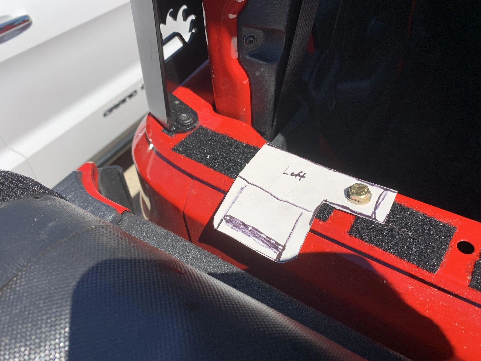

Well it was too wet in the fields so got to go home early, if I woulda made these templates yesterday, I coulda had these made today… oh well here’s my thoughts, going to use 1/8” steel and make these brackets and take the strapping and buckles for the safari mode and put them through these loops, gonna use a plas cutter to cut these out then heat and bend to contour the lip on cab
Those should work great! Plus, if you poke them through the back curtain you can eliminate the issue of pulling the strip out when tightening the buckle.
I've struggled to find a "buckle" or some sort of retaining item that works better than the buckle the included with the top, but I'm sure something exists. The old-school D-Rings (like a helmet has) would be perfect, but require the ability to sew that webbing and have the stitches withstand weather.
That’s the plan use it with the window and not use the ones on window

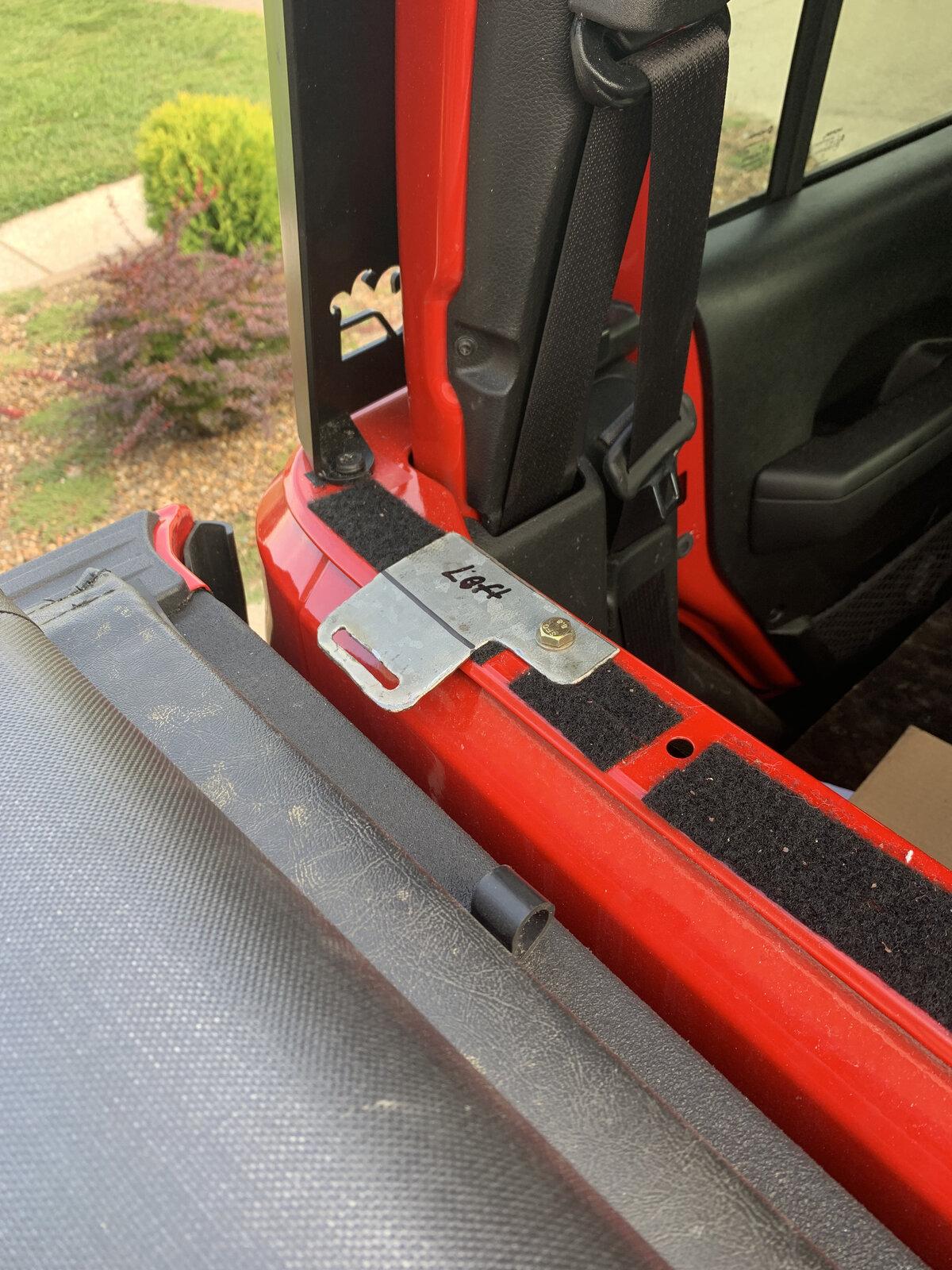

Alright after a few rainout days here’s the brackets I finished them out today and got all the sharp edges de burred and made sure I had the angles I wanted and started painting them today

Just realized those were wrong pics those were before I got the correct angle but you get the idea
