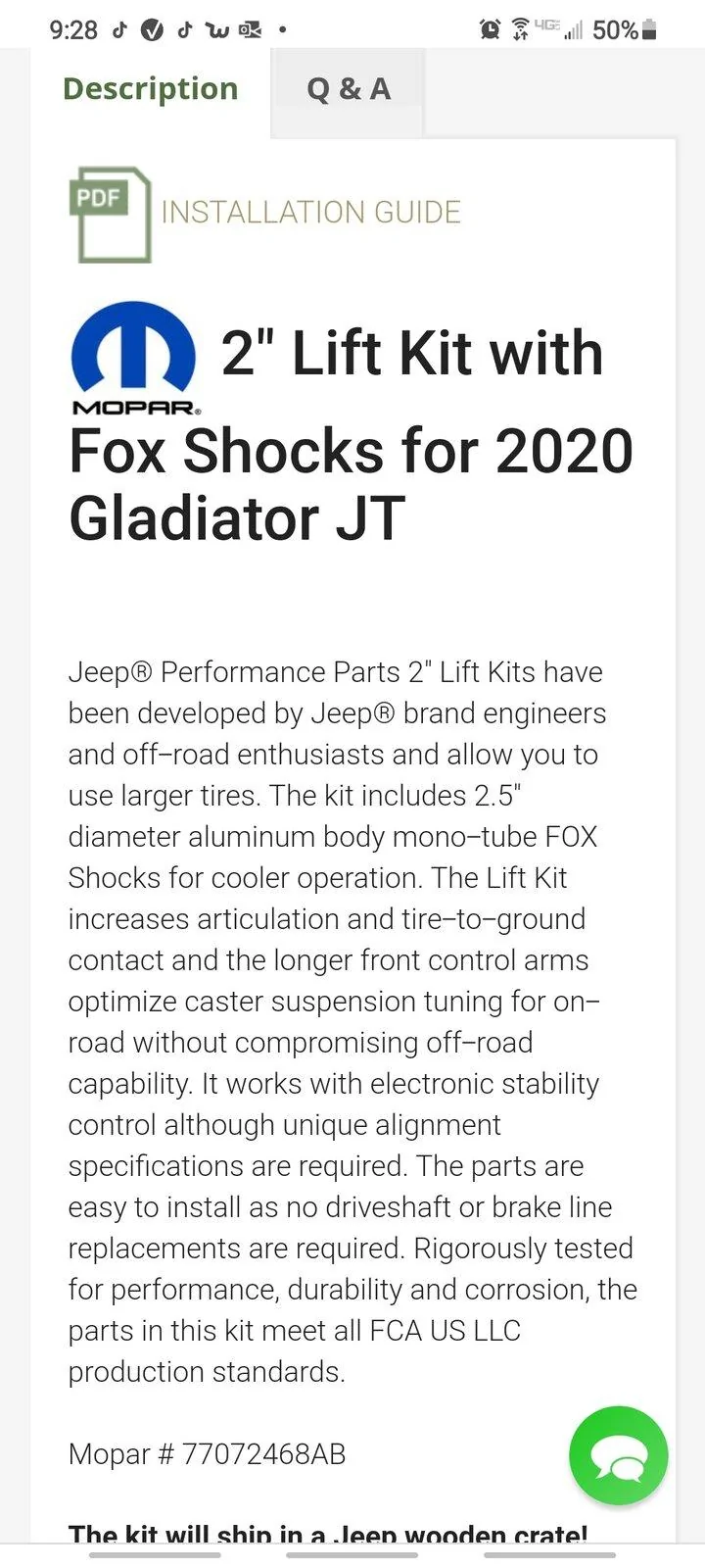

@chrisoverland are you measuring the body because the 2" vs 2.5" is the diameter of the piston inside, not the body. A 2.5 is typically around 3" but you can tell on Fox because the 2.5s have a 7/8" shaft.
-the Mojave fox shocks can go 1” up off center and function correctly per Fox
-the stock springs do not allow use of all the shock’s droop travel.
-Fabtech makes a Mojave specific lift that includes shock brackets and springs that maximize full use of the stock shocks, to the point if you whee hard or disconnect the sway bar you need a new front drive shaft for the articulation.

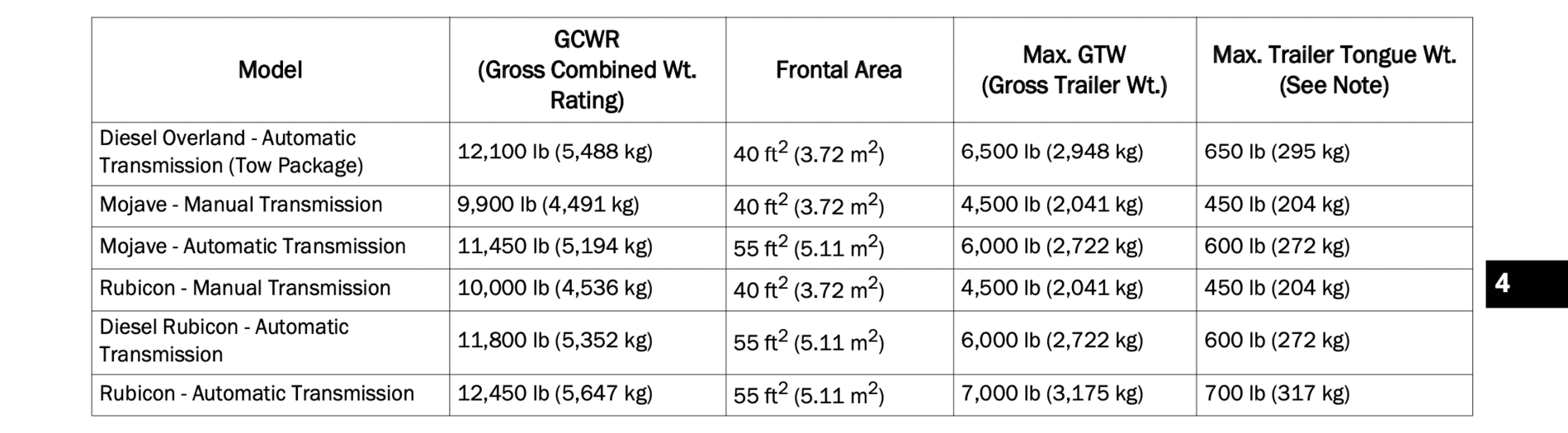

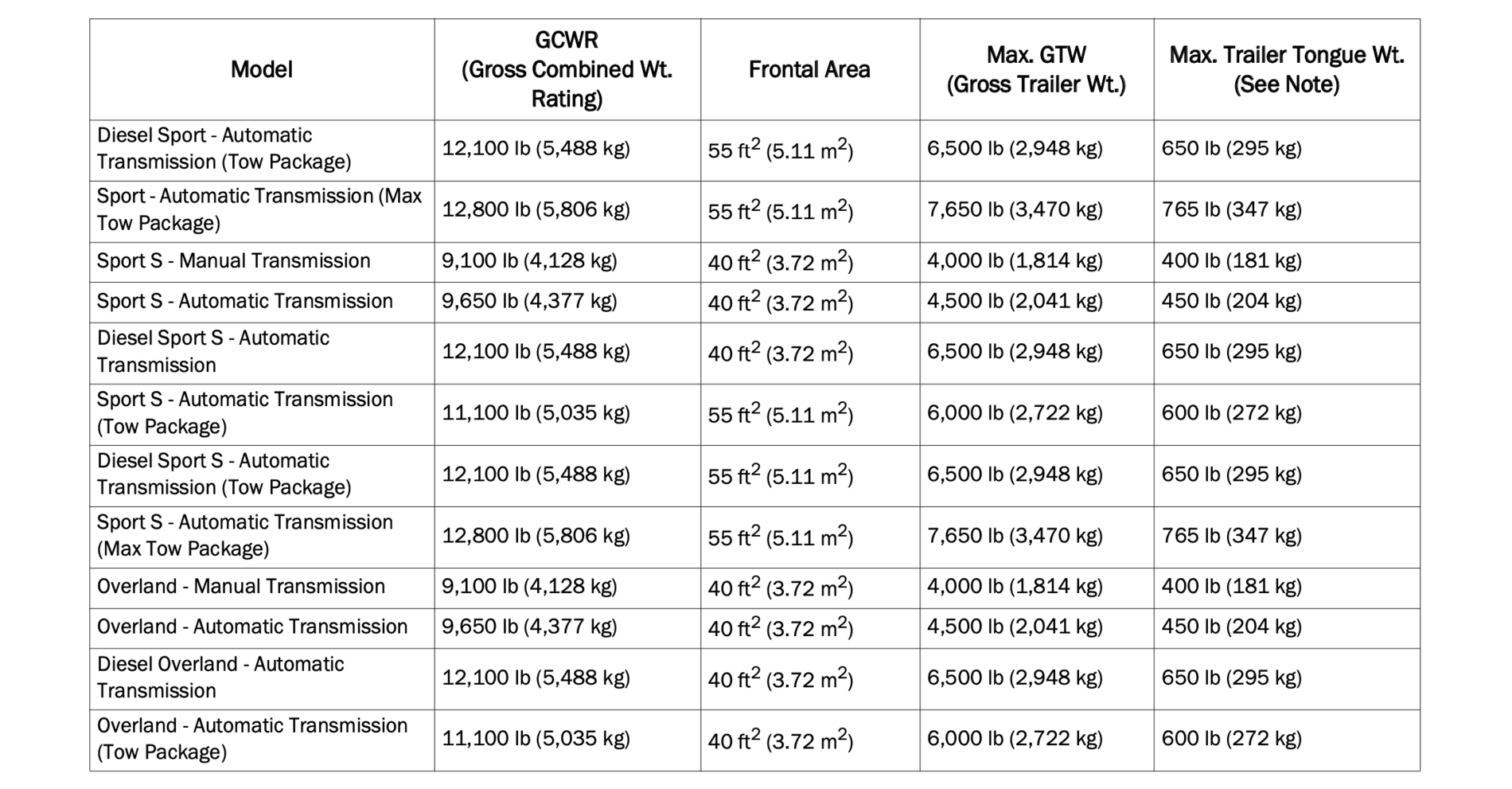

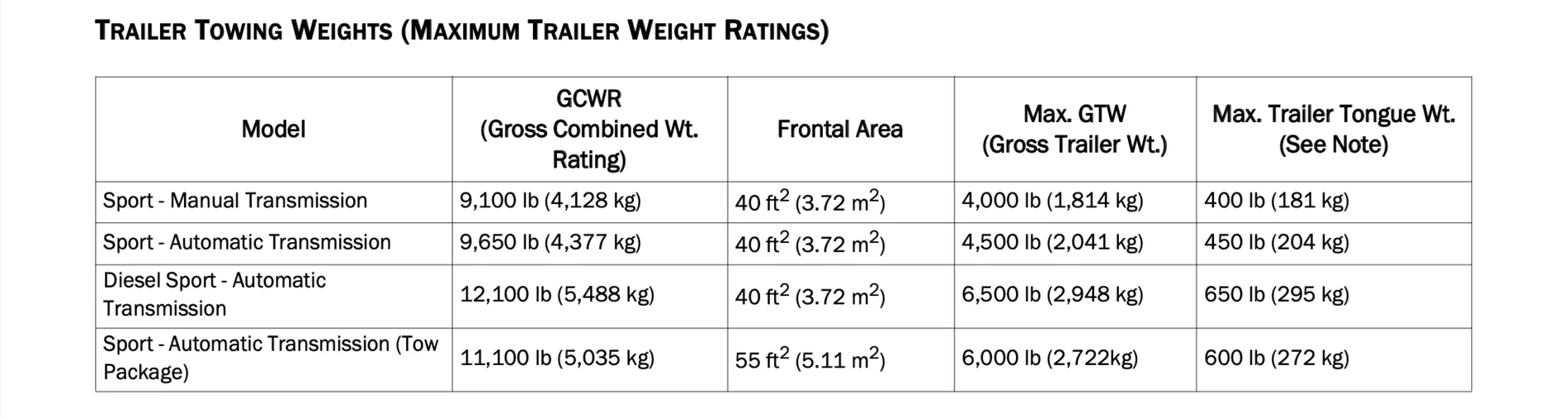

Thanks again everyone. Another question... If I swap the stock Sport S with Mojave suspension, does it change the truck's towing ability (specifically, does it decrease it)?
The Mojave has softer rear springs than some other models, which reduces the tow rating.
It seems like it depends on what type of Sport S you have.
From the 2021 Gladiator Owner's Manual:
Jeep Gladiator Suspension:  Sport S vs. Mojave? Screen Shot 2021-01-23 at 4.31.42 PM
Jeep Gladiator Suspension:  Sport S vs. Mojave? Screen Shot 2021-01-23 at 4.32.00 PM
Jeep Gladiator Suspension:  Sport S vs. Mojave? Screen Shot 2021-01-23 at 4.32.22 PM
The Mojave takes a 1k hit on towing from those springs.
two options-
1- leave your max tow springs on and the truck will probably drive just fine
2- do an airbag spring helper system to rebalance the load and lose nothing.
Oboc
Ray
Dec 21, 2020
Long Beach, CA
Yes, it decreases the towing ability, since the Mojave has softer rear springs.
two options-
Yeah, -20% seems like a substantial decrease. Thanks for the data @unixxx !
@KurtP good suggestion - I think I'll probably end up adding the airbags. But, I may try keeping the springs on for a bit just to see how it does. Thanks!

I'd love to see a pic... It's just seems off to me because Fox doesn't even make 2.5" emulsion shocks for the Gladiator (it would have to be a universal or custom application) and every Mopar kit I've seen clearly has the 2.0 body.
Jeep Gladiator Suspension:  Sport S vs. Mojave? Screenshot_20210123-212900_Chrom

Ah yeah you got fooled by the marketing and you're one of many. Fox 2.0s have a ~2.5" body diameter which is not the same as a Fox 2.5 shock which is frankly a massive shock body. You can look at the shocks you have installed and if you have an upper eye integrated with the body, that's a 2.0 and if you have a cap screwed on to the body (like the Mojave) that's a proper 2.5.
