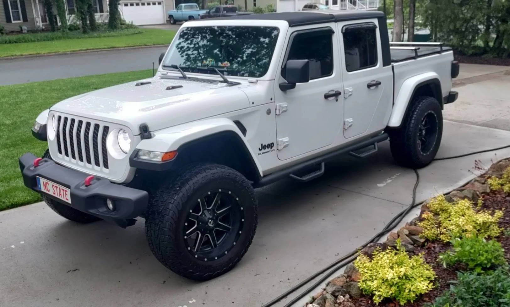

My Max Tow Sport had DRLs but they weren't activated. I used the JScan and activated it and they I was able to picked 2 different spots to have them activated. That could be the case with your sport S. As far as the fenders working as long as your getting the liners as well everything will mount up and work. Rubicon and Mojave liners are different than the sport and overland liners.

They will also hit on the Lower control arms without it being a Max Tow on stock wheels at full lock unless you get a 35 11.5 17. The 35 12.5 17 and 315 17 70 will both hit.
