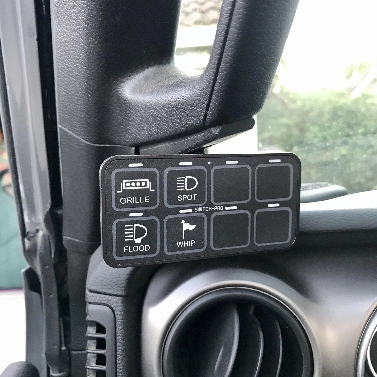

Anyone installed the Switch-Pros 9100? I need suggestions where to install the module under the hood on an Eco-Diesel and where to run the wire trough the firewall. Bonus if you can show me where you mounted the interior switch panel and how you like it. THX in advance

I dont have the diesel so I dont know if the black plug is in the same location as the 3.6. Its on drivers side firewall, I ran my cable through that.
I mounted mine on the A-pillar with their mounting kit.
I like it quite a bit. The install wasnt too bad and it works well. You can use you phone via bluetooth to change color, brightness and backlighting on the panel.

That looks like a very good and easy to reach location. Thanks a lot
