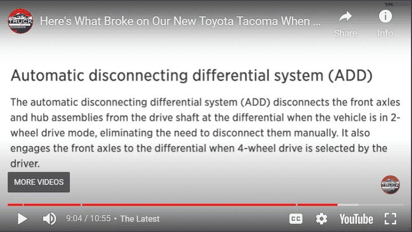

I watched the diagnosis video this morning, and I thought they said that the broken part (designed to give before catastrophic damages occur) was in the front differential.
Video is queued to the explanation.

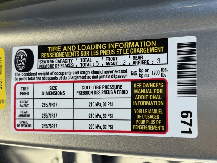

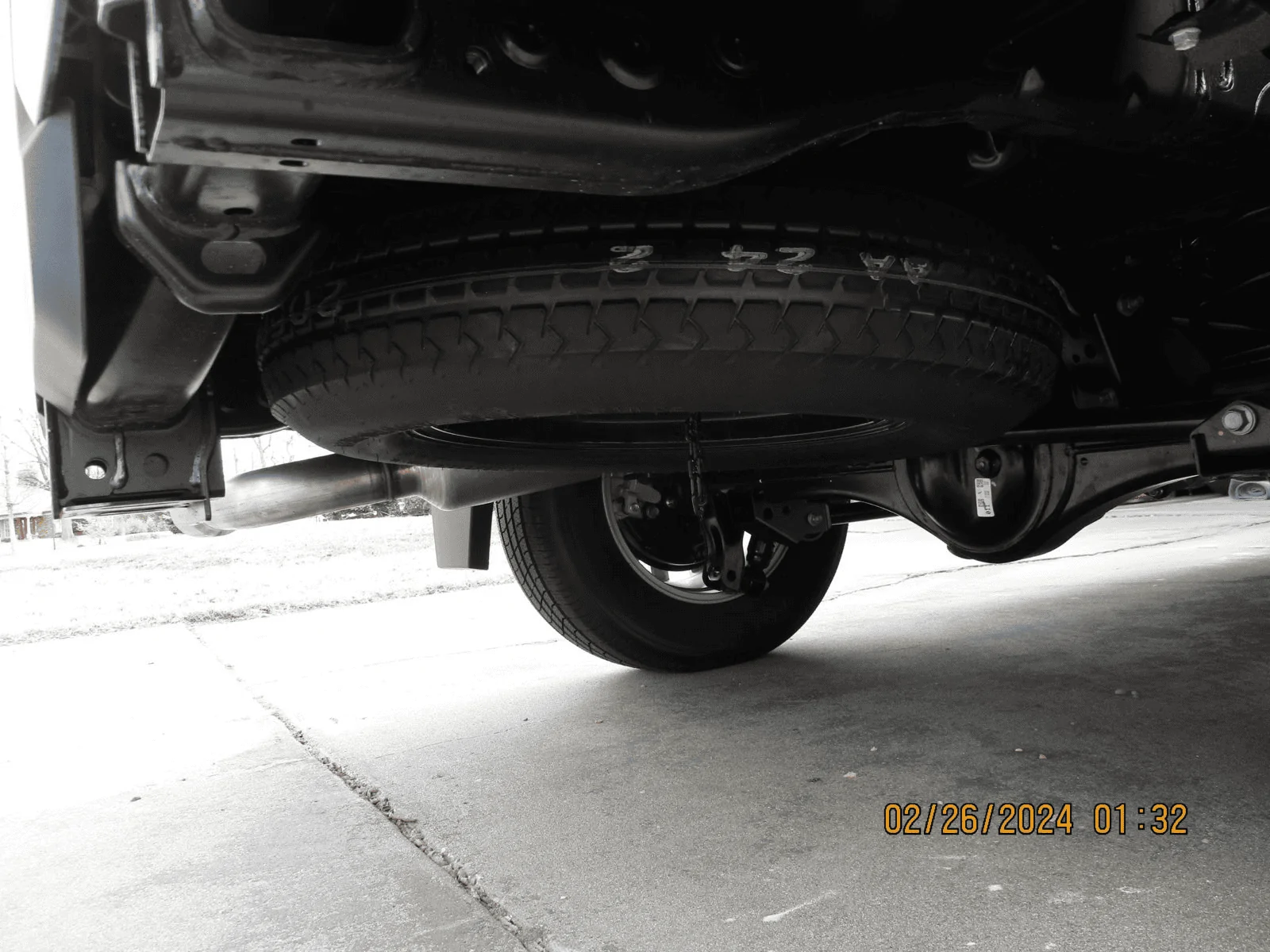

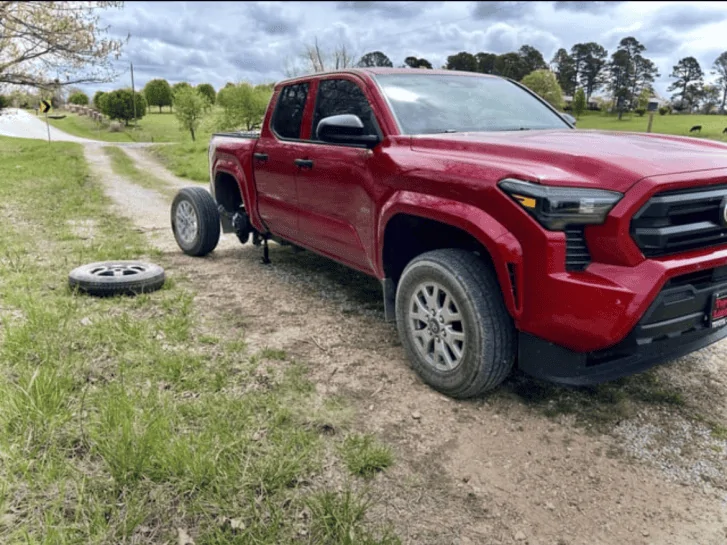

Apparently the 2024 Tacoma has a donut for a spare.
Jeep Gladiator Tacoma Breaks Down on Trail 1713369554991-2
Jeep Gladiator Tacoma Breaks Down on Trail 1713369607516-3g
EDIT:
Here's what the space-saver spare looks like while mounted. Trying to fit a 265 width under there is going to impact clearance, and forget about anything larger than OE unless you want the departure angle of a Sienna.
I bet we start seeing a lot more modified Tacos with rear tire carriers because of this.
