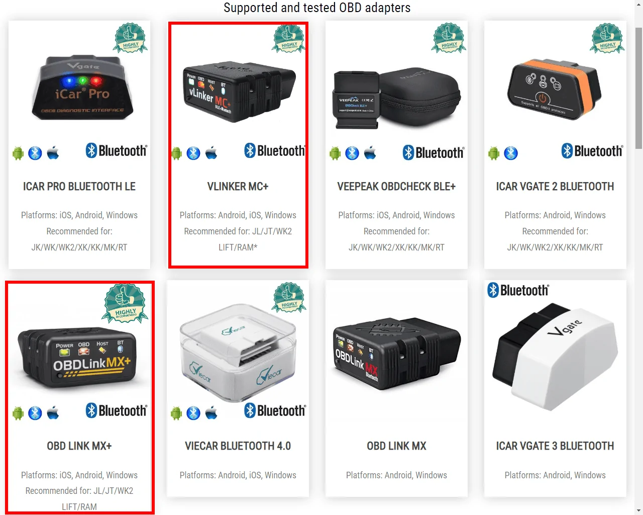

As far as the adapter price,as I stated above, according to Jscan's website, there are only two OBD2 adapters THEY recommend for the JT Gladiator. The cheaper of those 2 is currently about $60.
Jeep Gladiator TAZER MINI vs JSCAN 1659275128392
You can buy an OBD2 adapter for $10 on Amazon, and it will read codes just fine (I know, I already had one of those), but it won't work with Jscan. So I bought one they recommended. I bought the better one ($140), because that was the only one also recommended by AlfaOBD, which does a lot more than Jscan. I think I paid $22 for the recommended bypass cable at the time. I ended up going with AlfaOBD over Jscan ($50 but it does more and has unlimited vins) but even at $24 for a single license, I'd be in for over $185 for Jscan vs the $300 I paid for my Tazer.
