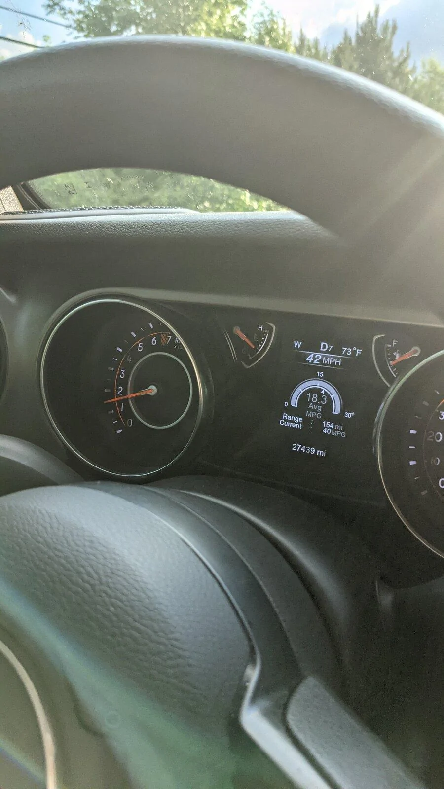

I'm averaging 17.2 mpgs to 17.4 mpgs local driving and we got 18.3 on our way to the beach. They do great for me. Towed about 4000lbs with it a few weeks back and it fine as well. I haven't saw under 17 since I put them on in February, 14,000 miles so far. I went with the Lighter Goodyear Kevlar MTRs
Jeep Gladiator Tell me I didn't just mess up PXL_20210529_223647904
