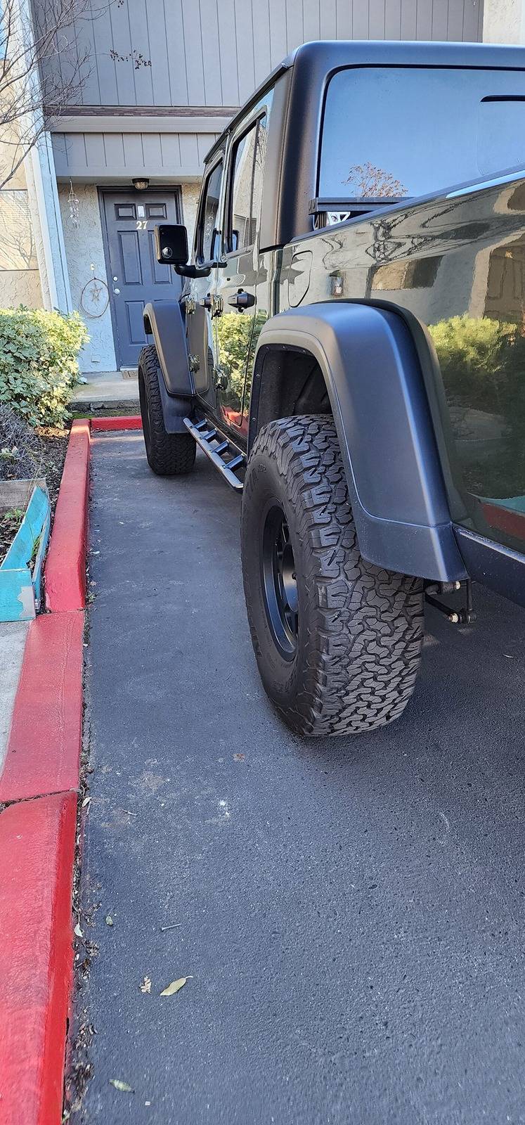

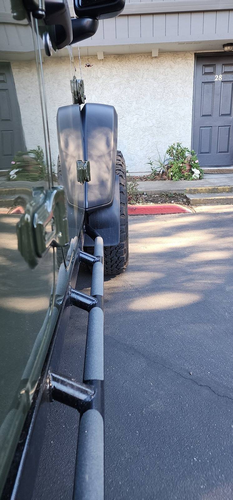

Got my summer wheel and tire setup installed last night and man am I in love with this setup!
Method 703 (17x8.5. +25)
BFG KO2 C-rated 37x12.5r17
Zero lift, zero rub, nearly zero poke. Side pics taken with phone placed level on the body panels. Tires measure 35.25” loaded on the Jeep at 33psi.
I do plan on running a Rock Krawler 1.5” spacer all around to regain the wheel gap and travel, but wanted to mount this setup first to provide real feedback. Rides like a charm and at full lock side to side and in reverse without any rubbing.
Perfection

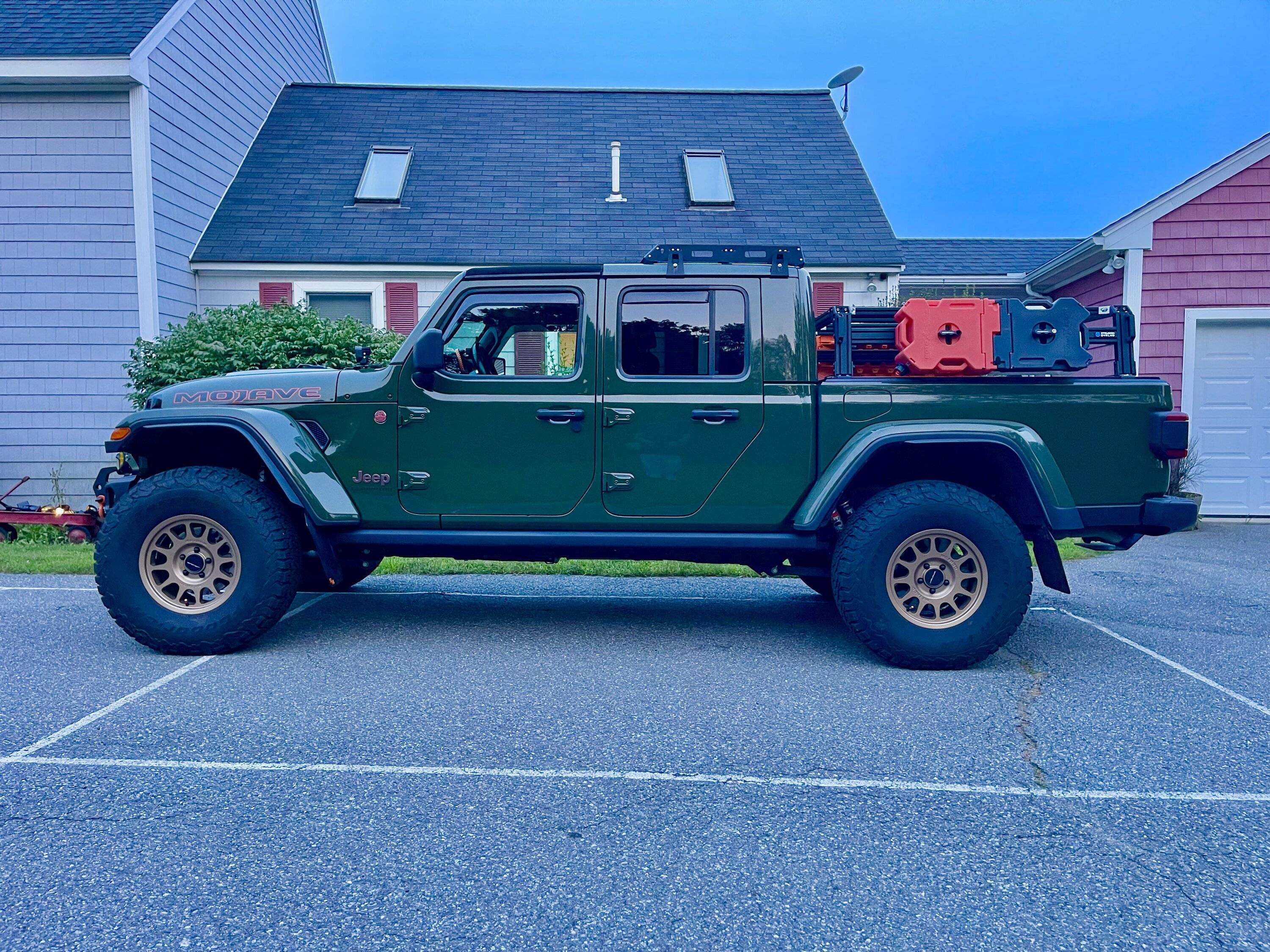

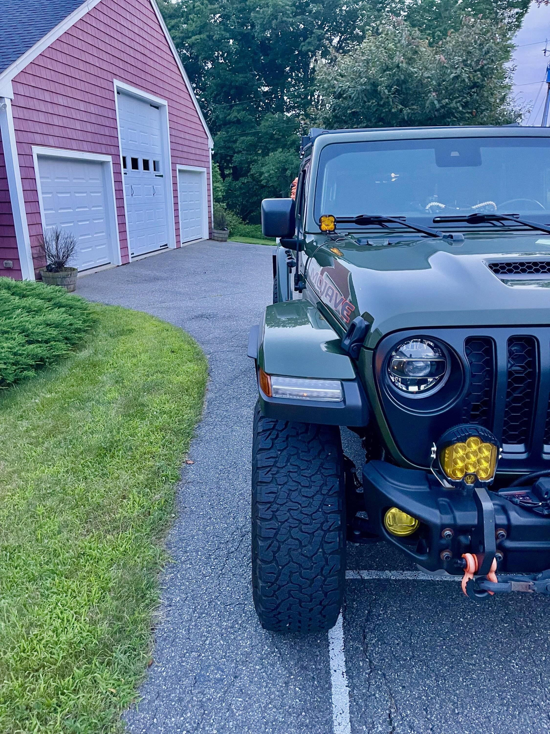

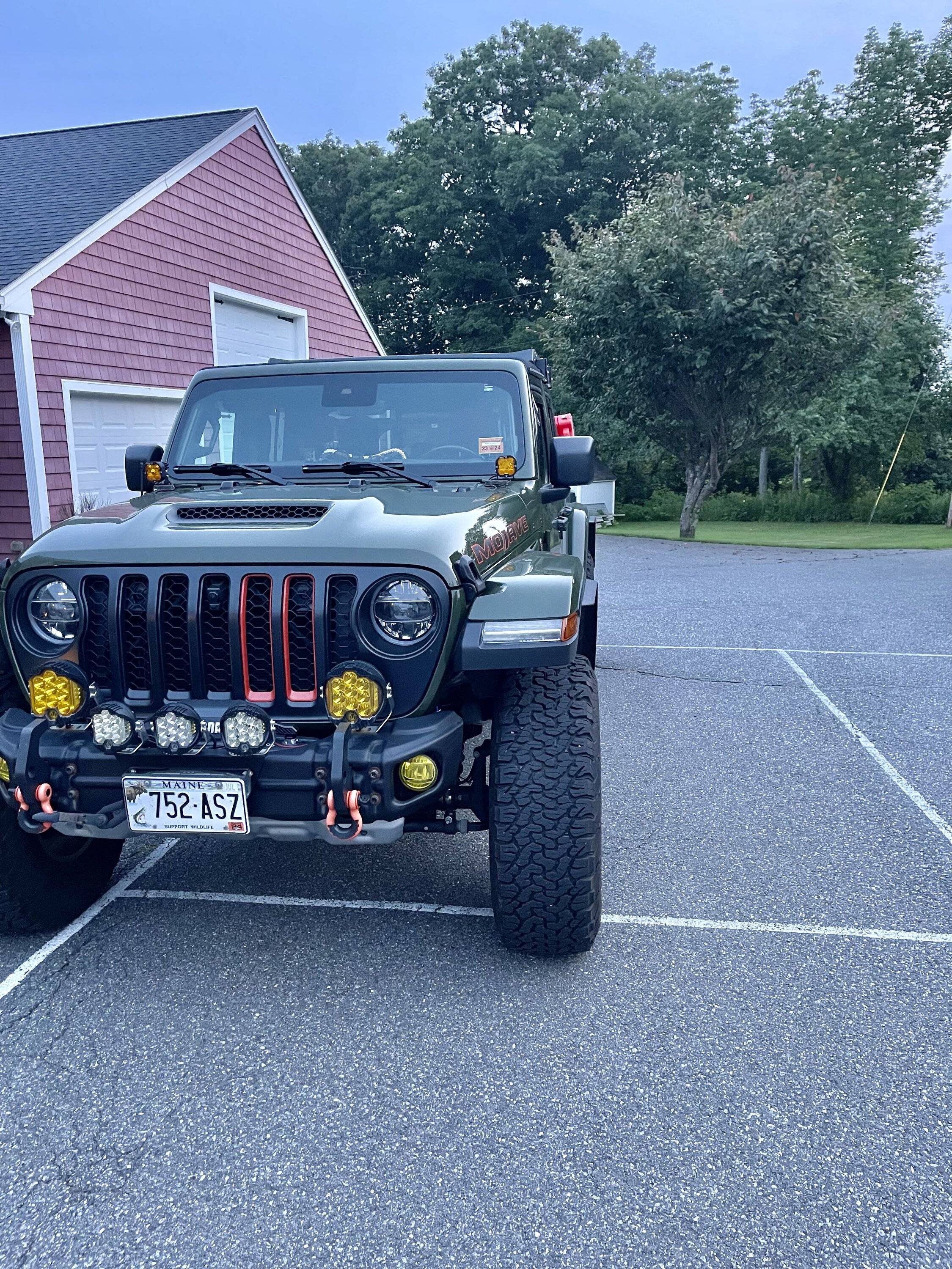

UPDATE:
Installed AEV 2” spacer with geometry correction brackets and Apex autoLynx. Gained the wheel gap back for more travel and tucked the tires in a tad more perfectly. This setup is rockin.

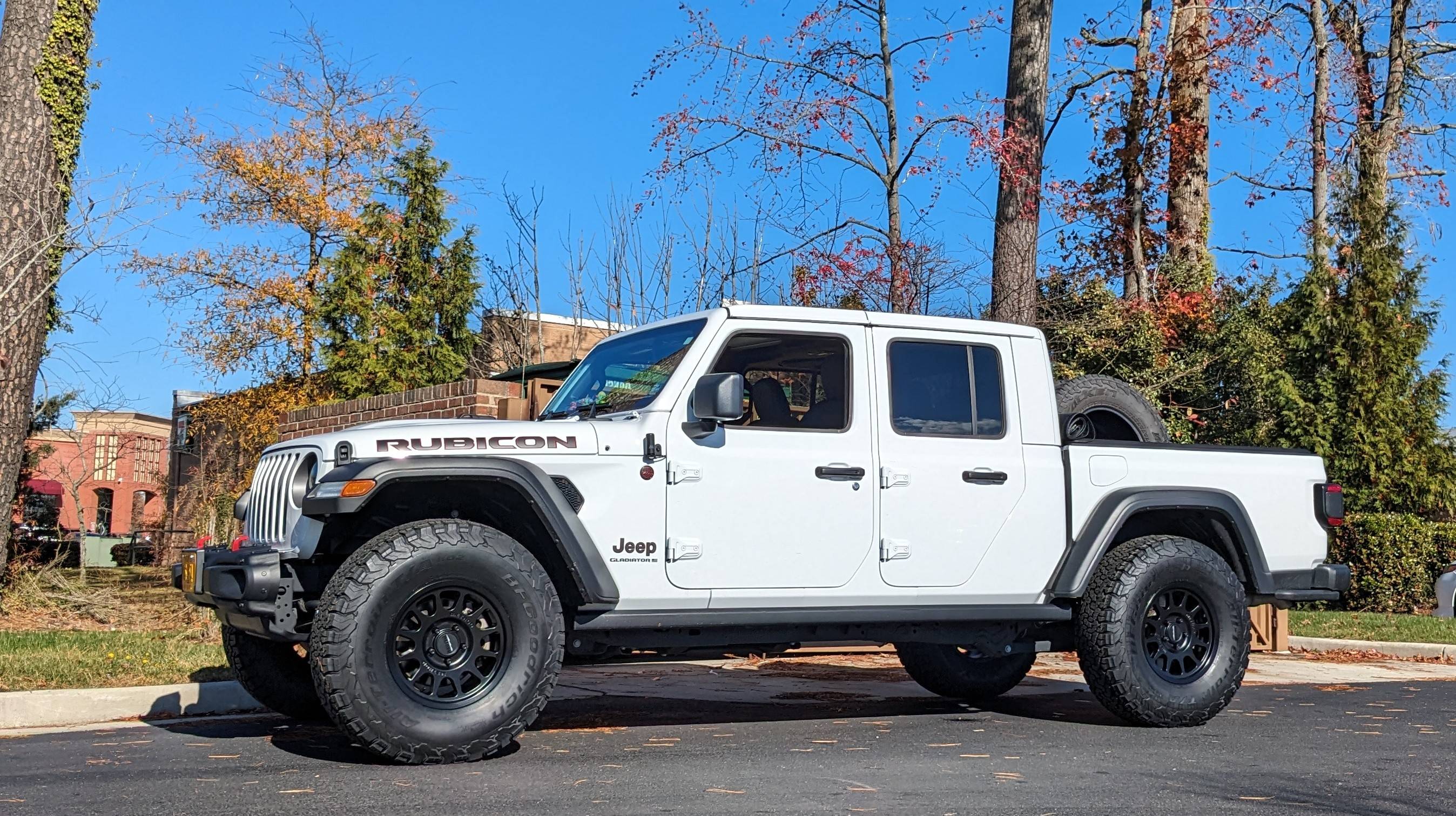

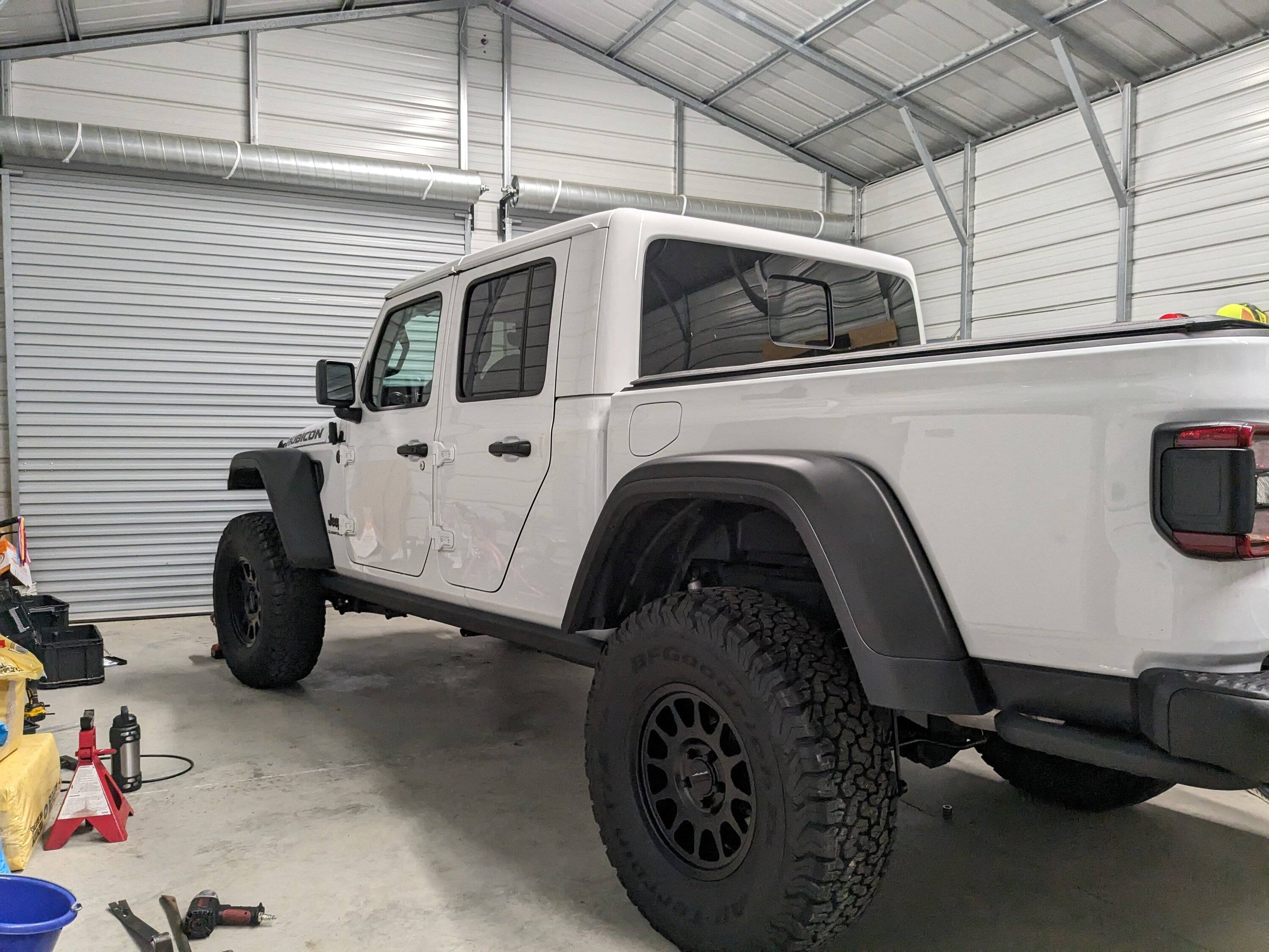

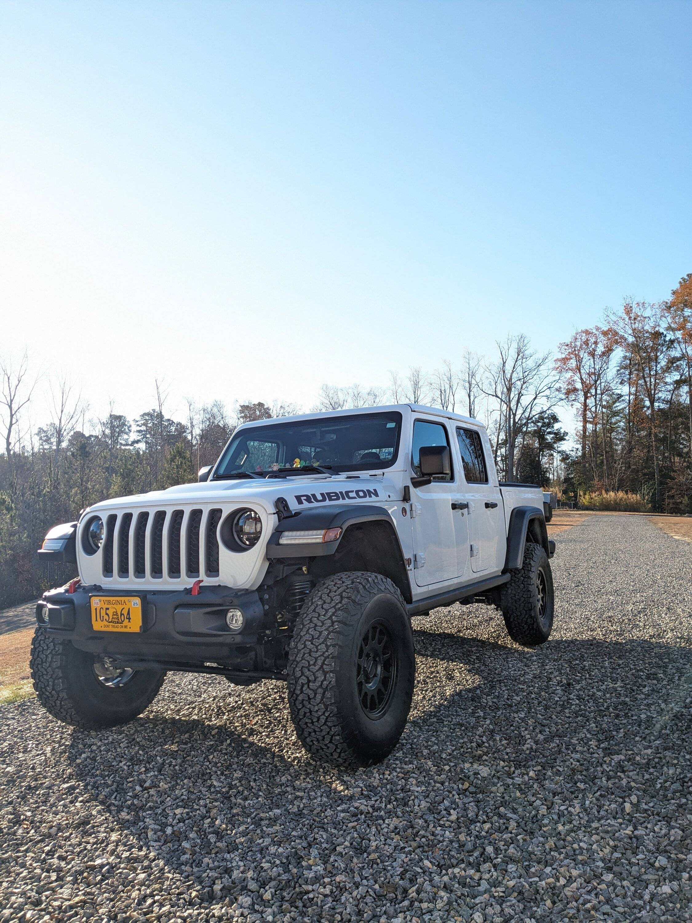

Just chiming in to say this exact thread was my inspiration. I always liked the 703s, but wasn't sure if I wanted +25 or 0 for offset. I chose +25 because it saves on bearings, turning radius (supposedly) and keeps the jeep cleaner. I like the look of a little poke, but just not as practical.
I decided to go for the full AEV dualsport after researching since May, and I'm happy with it.
But, as a Rubicon owner, I can now attest you can run 37s on 703s with no lift. Drove it around town for a bit before I put the lift on that evening.
See below for before and after. Thanks for posting and being the inspiration with "the tuck"

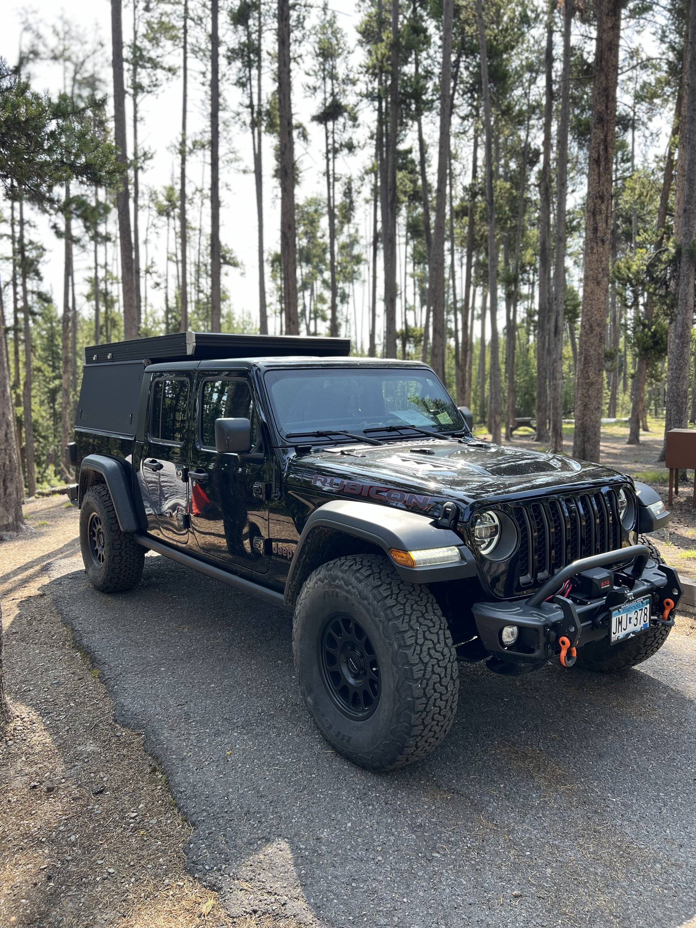

I have the exact same setup. We did some off-road trails in Idaho last weekend with some pretty decent ruts and rocks and I had no issues with rubbing even with sway bar disconnected and fully loaded down with camping gear. I do plan on lifting soon because the stock suspension is very soft with the truck loaded.

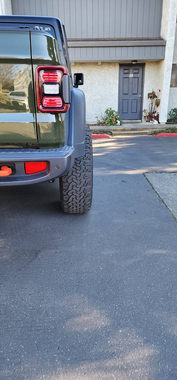

Are you running zero offset or 25+ ? Looks great! I want the new machined finish methods but I reached out to them and they are only going to offer that finish in 0 offset. Which is disappointing. So now I’m debating just keeping the stock wheels or going to the 0 offset methods.

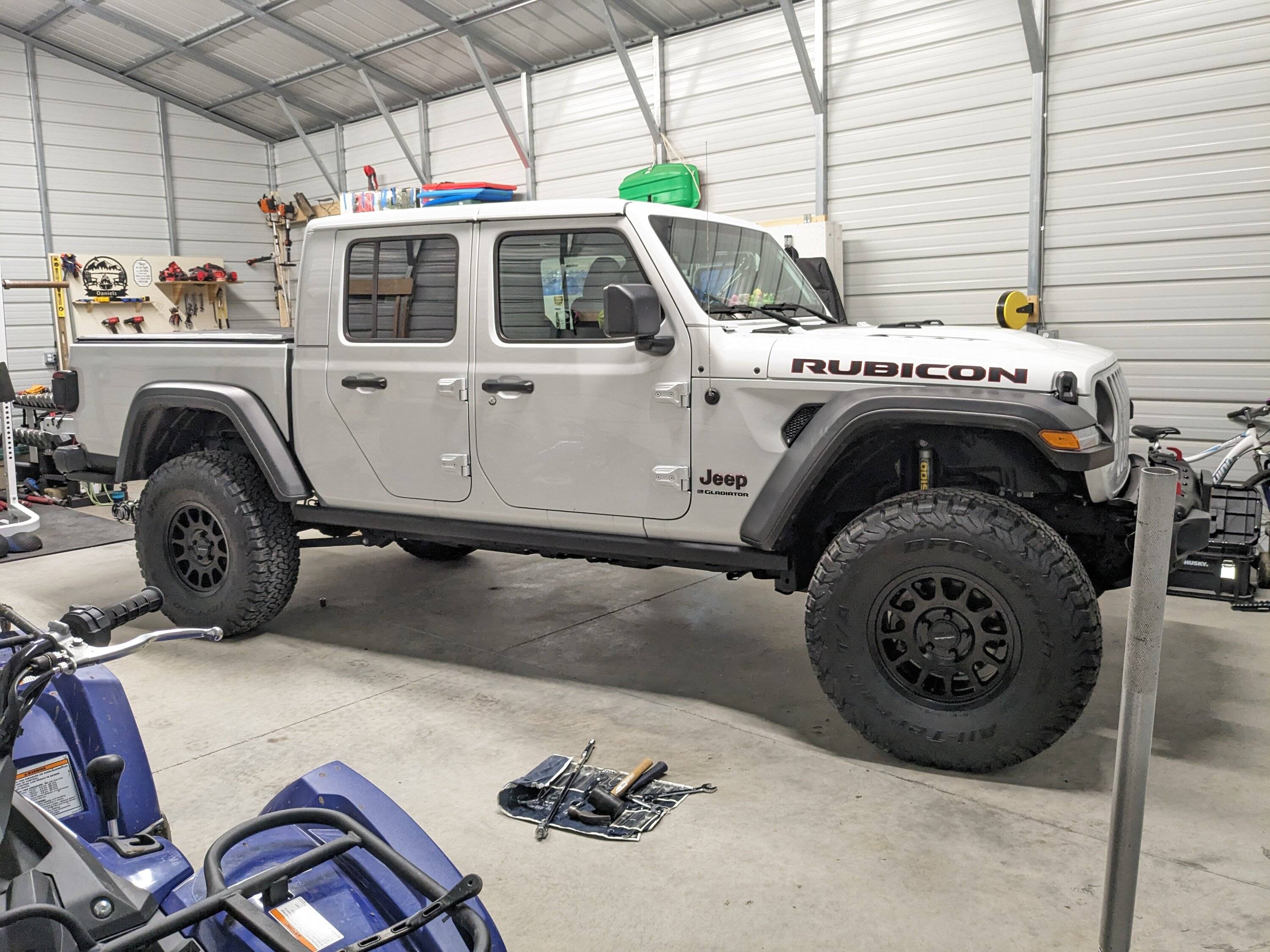

For comparison, here is my setup with KO2s and 0 offset methods.
