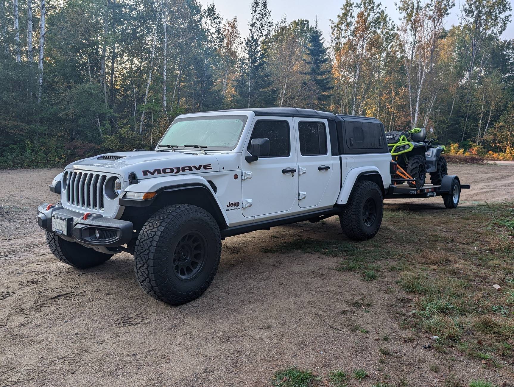

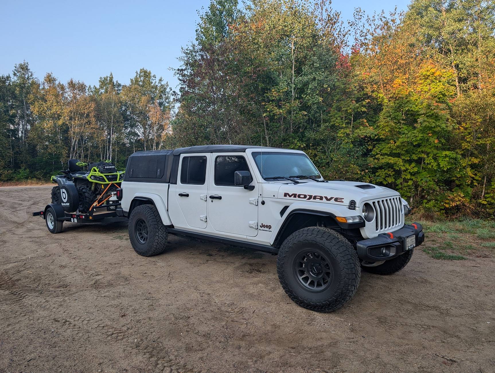

Here’s my Mojave after installing the AEV 2 inch lift, correction brackets, mopar extended LCA’s, rock krawler trackbars, and BFG 37’s with Method wheels 0 offset.
Brackets and LCA’s left me with 6 deg of castor and it’s super smooth. Likely going to regear to 4:88 at the end of the year.

Looking tall!
Couldn't decide between geo brackets and extended LCAs, so you did both?
Obviously everything is lifted 2" + tire difference, but did you happen to measure the before and after clearance under the truck? Are the Geos just as low as stock (other than tire lift)?

Looks spectacular! I'm on 37" Nitto Recons with Method 703s. Just waiting on my AEV lift. Wife told me I have to wait. Between the tires, wheels, SmartCap and trailer for the atv she said if I spend any more she will slap my peepee LOL

I’d like to hear your thoughts on the more ‘optional’ aspects of the build (brackets PLUS lca’s instead of just one or the other; track bars; and the wheels. Are the latter primarily for aesthetics,or is there a fit improvement versus stock Mojave?
Have you driven it enough to have a sense of how the suspension is working post-lift? Thanks!
