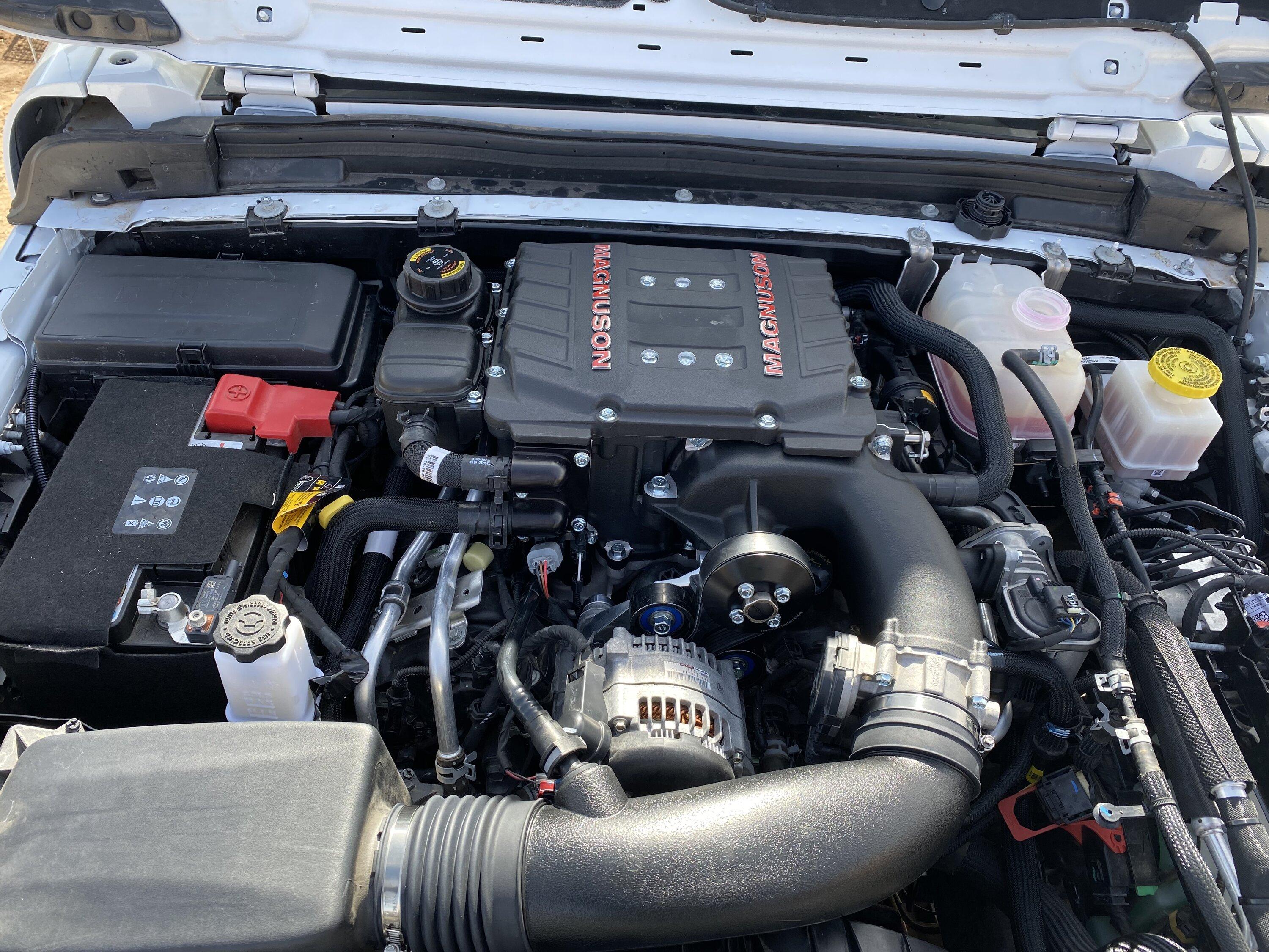

I can say, with 1000% certainty, you and anyone else running a Magnuson should uninstall it ASAP. My 21 Mojave is basically been rendered useless by this installation. I have been without daily use of my Jeep since the day it was bolted on. Between the ridiculous variance in tuning between same model year PCMs to the crappy quality control from Stellantis, the installation of a Magnuson supercharger has ruined the Jeep I’ve waited years to buy. I have r&r’d EVERYTHING but the pistons and rods and it still taps like a diesel at idle and rattles and misfires at part throttle, and shuts power down above half throttle. Dave can show you snaps of my logs (he has at least 20+) to corroborate this. I’m at the point of “F**k it, I’m ordering a TRX”
My Jeep was absolutely amazing before the Magnuson install. It is ruined now.
Dave I emailed you this as well but hoping to get to the bottom of this ASAP because I have a road trip coming up to the Rockies in which I plan to take and off-road the Jeep and trying to figure out if I just need to uninstall the SC for now or of there is something I might be able to do to get this running right.
As I read this I’m wondering if this is where my issue is? Can you describe what one would observe when the throttle losses control, and the cam timing goes into a catalyst reserve?
As you describe the control system being used this sounds very much like what is happening after my install. I know I am running a recent firmware as I had to install a new PCM after an electrical issue in which my original one got fried.

I've had my supercharger installed for 10k miles. While the install was long and rough ( because of Magnuson ) and the tuning was very rough in the beginning I'm 95% happy with Dave's tunes and his support and what he has been able to do for me.
I don't think I would be saying the same thing if I hadn't connected with Dave and had his support.
I've also had 0 mechanical issues with the supercharge or engine since the supercharger install.

I can appreciate your experience with your Gladiator but mine has gone downhill since I started it the first time after installation of the Magnuson. It was an absolute dream up until that day. Now everything I have done has been for nothing. It knocks/ticks/smokes blue smoke and now the rear seal is blown out because of a check valve that I installed on the make up side catch can (My Mojave has always puked oil into the intake tube behind the air filter). My experience is that any power adder,regardless of brand, will eventually cause the motor to have issues. Too much compression and no oil control. My two cents only.

I think that with millions of these engines out there that haven’t crapped the bed at 11k mikes, I just got a bad one. Badly built. To its credit, I have actually been trying to get it to come apart and it won’t. Dave’s tuning has a great deal of protection built in. Anywho, who would like to buy a Magnuson kit? I’m pulling it off asap. And it has every bit of 250 miles of “usage.” I’m sincerely hoping Dave will help me get the new engine to run well in NA form.

I have a pristine set of cams as well. The only things I didn’t need to replace when I finally pulled it back apart. I believe I need at least two pistons but I won’t know for sure until the block gets yanked.

If it was an absolute dream, then why did you feel the need to add a supercharger? Those 2 statements don't go together!
I added mine because it was not a dream! If I hadn't added the supercharger, I would have sold the severely underpowered thing off. I live in high speed highway driving with overpasses, and it was unable to hold speed at 75mph in 6th gear going over an overpass. I should not have to downshift every mile to go over an overpass! RIDICULOUS!
I am one of those who is very happy with my supercharger. I am running a somewhat older, super stable (for my engine), and somewhat less powerful tune than most of y'all. I get around 350lb/ft of torque at 1800 RPM which allows me to keep my RPM low and cruise comfortably without downshifting constantly.
If you are happy with your jeep, why would you risk losing your warranty coverage from one of the worst manufacturers in the world!
Installing a supercharger can be very risky. I have had boosted vehicles live 200K miles, so I don't know about the concept that the boost alone will destroy your engine. Someone got unhappy because they had a bad experience and they are now trying to warn everyone off.

Well I can say it is NOT ONE BIT as underpowered as my 2009 JKUR. I have several vehicles that have “power”. I wrench on my own stuff and drive it like I own it (not the bank). Glad you’re having good luck, but trust me that’s all it is.

What tune are you running? I have found my truck runs best on Daves 121 tune. Have tried all the others, but this one is best overall. Smooth as butter, and great power all over.

It was one he made custom for my truck when I first put the small pulley on. Ran smooth as butter. I tried 121, on my truck the surging at highway speed was intolerable and it just never felt stable pulling a hill. So I rolled back to the custom tune. I have tried 1 or 2 others, but they all have the same issues.
This one, I took all the way to redline full throttle pull with good stability and no detonation. When I had to take the family on vacation I rolled back to this stable one and haven't had any reason to test anything else since.
