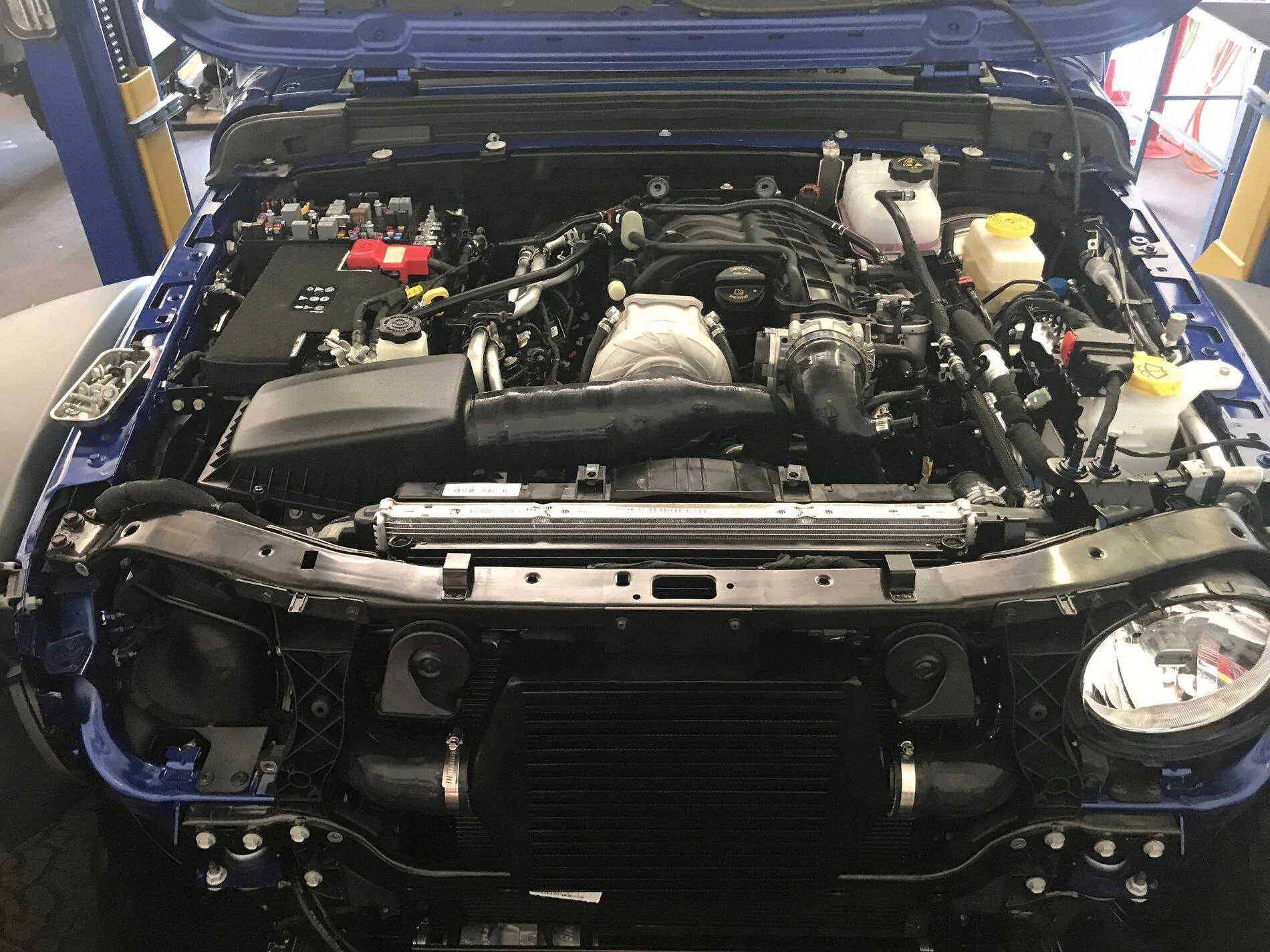

Hamburgers, with two completed so far. Excellent system.
