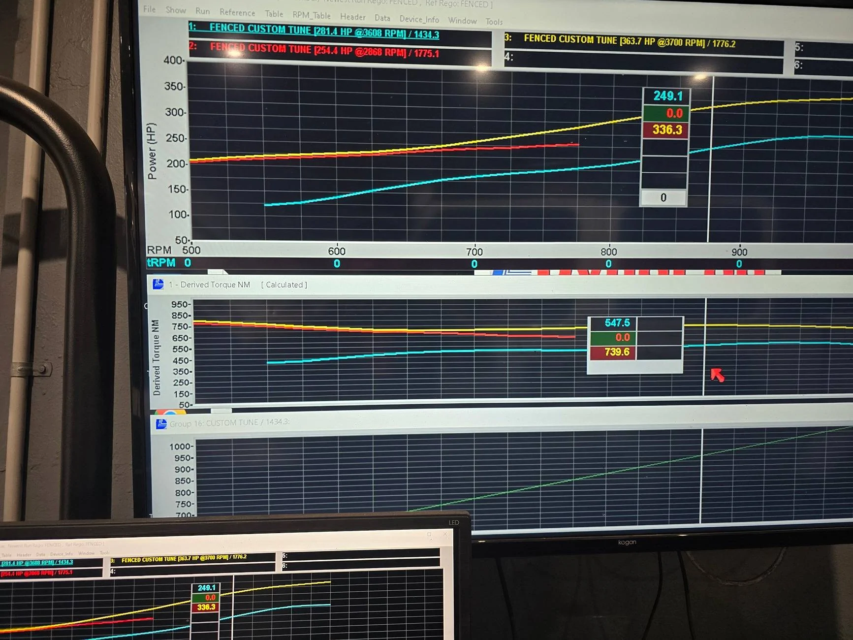

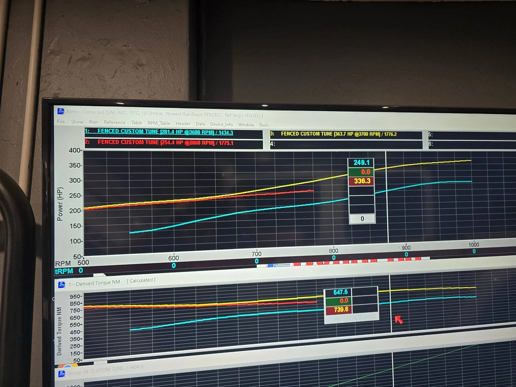

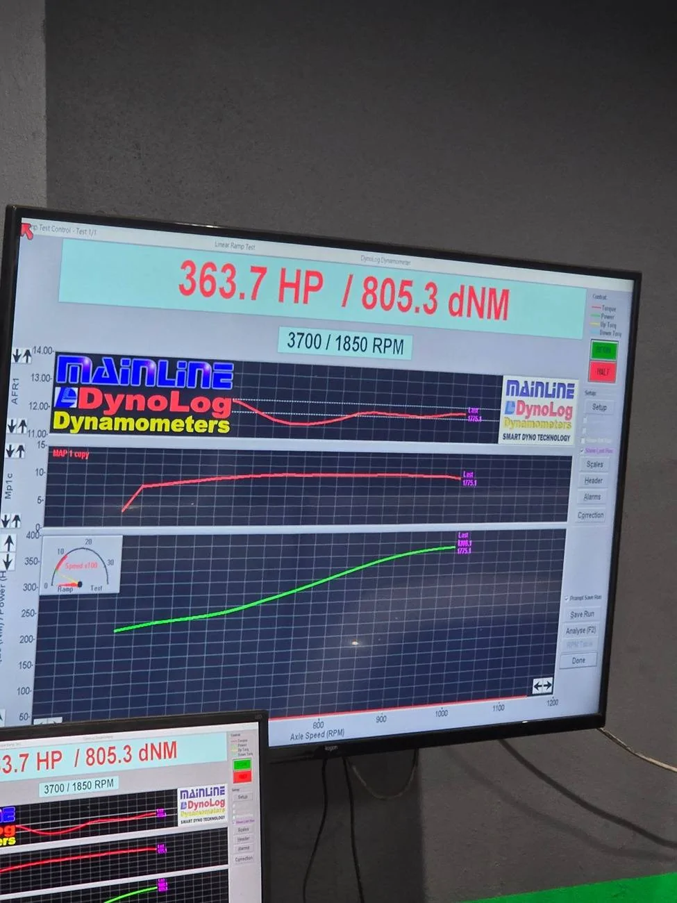

So finally finished the forged fully built engine.
MMX Forged rods and pistons.
Prodigy ARP Head studs.
Balanced Rotating Assembly
Forced Induction Interchiller with custom reservoir system now holds 8.5 Litres.
Dorman Oil Cooler.
Baxter Performance Remote Oil Filter.
Mishimoto Catch Can (small due to running out of room).
DBA Slotted Brake Discs all round.
Air intake temps are now around 18 to 22 on a 23degC day with running cabin AC also. Without running cabin i.e. 100% interchiller AIT down to around 10degC.
Timing now gone from -5 to +12.
Pretty happy with the results. Lot more torque.
