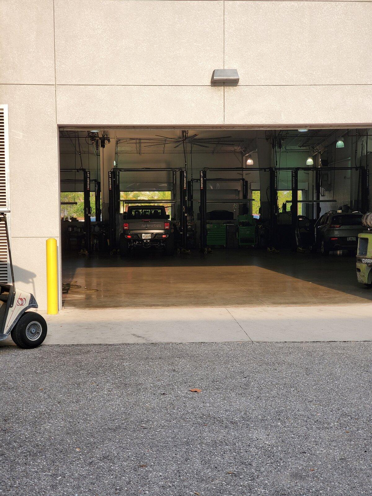

I still have my free oil changes to use, I am actually sitting at the dealership getting one now, I will for sure ask them what it costs for you, and I just got the tires on yesterday. They're going to recalibrate for the 37s since I don't have the Tazer yet so I'll keep you posted on that. I'm not going to Jeep Beach I'm leaving for Texas then Mexico on Monday so I will be able to dial in my MPGs on the trip. I will be at jeep fest in August though.

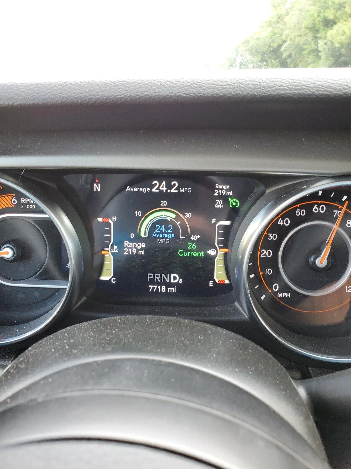

My 60 mile trip after resetting my trip computer and tire size calibration. Cruise set at 70mph on interstate 75. Holds 8th gear fine and plenty of torque off the line and passing.

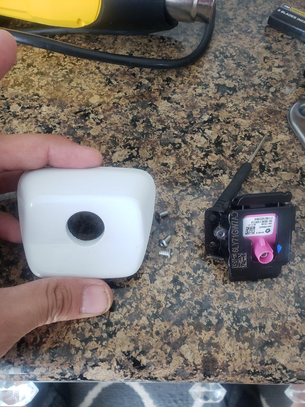

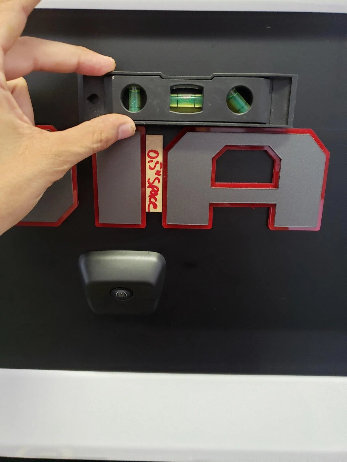

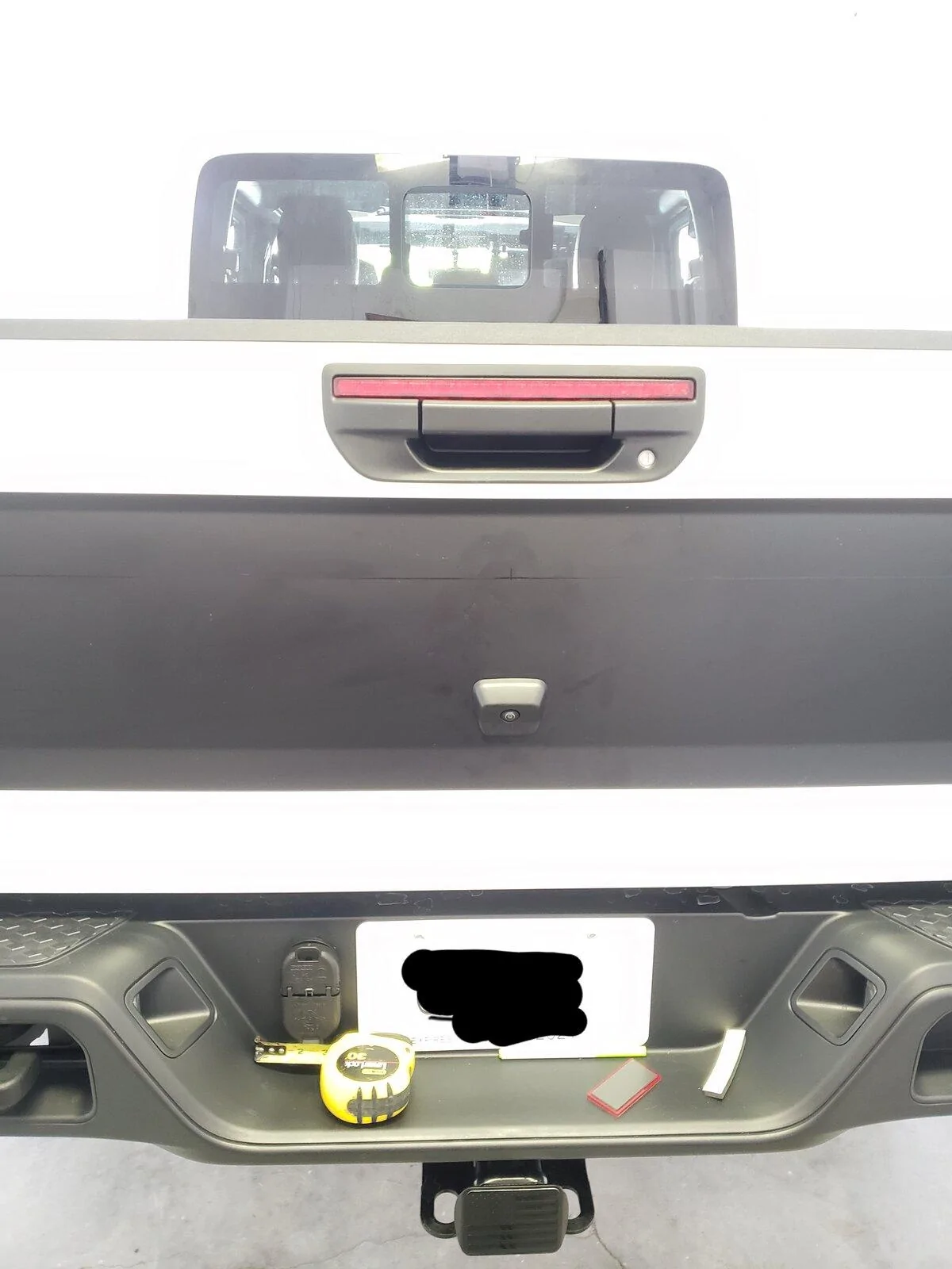

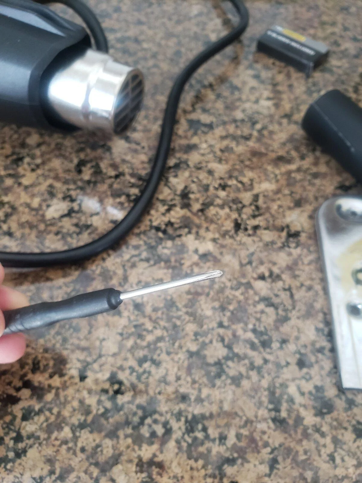

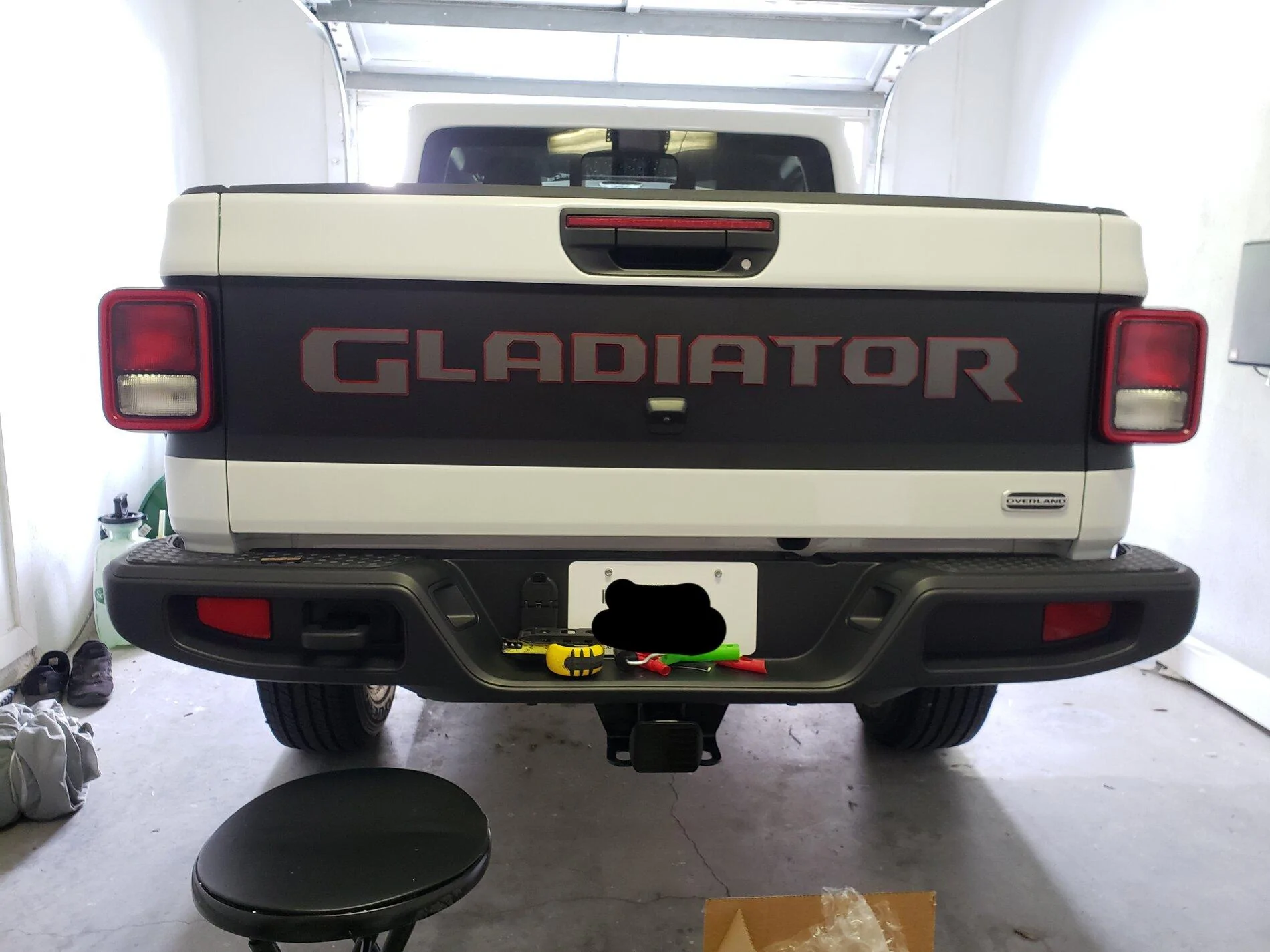

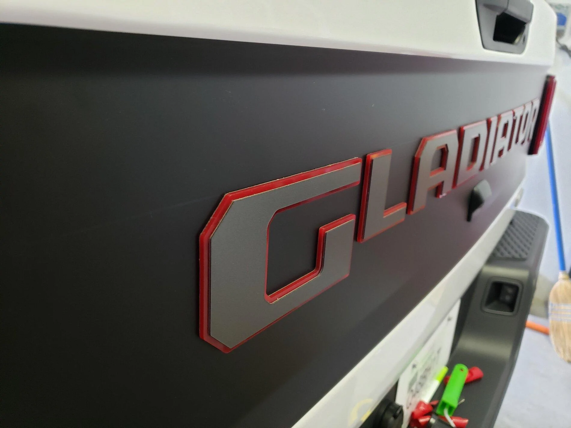

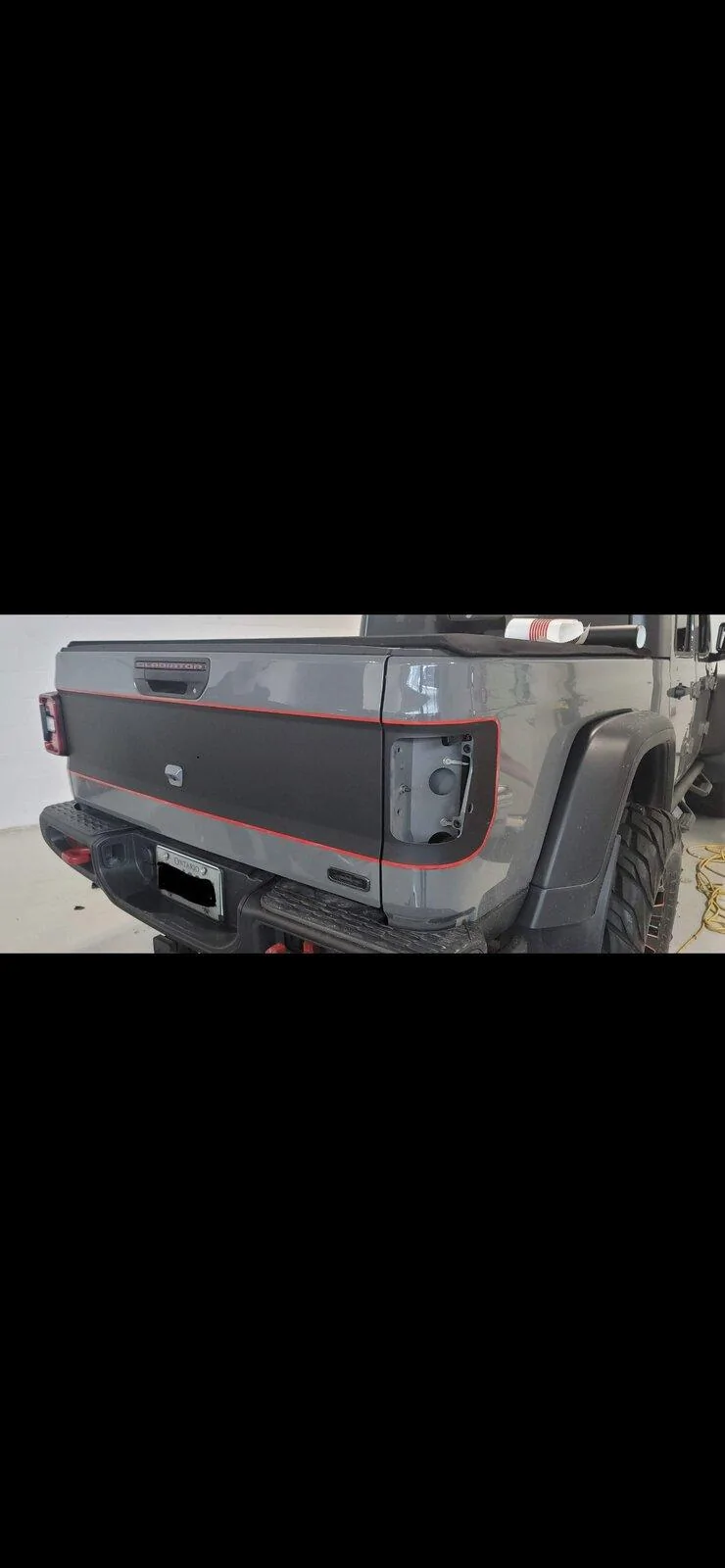

Got mine done today and boy the letters are top notch. Also, I managed to remove the camera from the bezel. I used a screw driver meant for glasses from my local dollar store and it required a little extra pressure but came out pretty easy. It made wrapping the bezel much easier but clipping the bezel back onto the tailgate a little tricky because of the extra layer of vinyl. When installing the badge I used a washable marker, from my kids collection, to mark a line with a level 3 3/4 inches above the camera bezel. Then placed the first letter, I , in the center and leveled that. Then placed the next letter with the spacer included and leveled that with the first letter and did the same with the rest. Even though I think the cardboard cutout method would be easier for most , this option only took 30 min once I decided how to proceed.

Looks good. As a baseline, what is your measurement from the bottom of the I to the top of the camera bezel?
Garemlin
Nov 4, 2017
295
350
Ford F150
I ended up going with 3/4"
Thanks. I'm thinking about using the "I" as a starting point and going out in each direction. Using painters tape doubled up for a top line and the 1/2 spacer. The only snafu I see is with the A and O on either side of the T.

FYI because of the shape of the tailgate my letters didn't land exactly on the line but leveling with one another made sure I had a straight line. Also, use your spacer on the left and right arm of the T to get the correct spacing with the A and O.

It may have already been mentioned but if you wrap the tailgate do you remove the vinyl before installing the letters? Or just place them on top of the vinyl?
