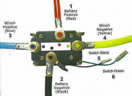

Shockingly fast shipping, as they said it might be delayed. Delivered by a winsome wench! Great instructions. Hope it works, so far quite happy.

Installation looks to be pretty straight forward.
Nice instructions.
Green Wire Six should go to the under hood accessory lead, I'm thinking switch three.
As there is no ground coming from the accessory switch, I'm thinking the Black Number Five wire would simply go to chassis ground.
What say you?
Once again thanks for your help with my wench!

Overlord what exactly are you trying to do? This thread is getting lost cause of poor spelling and beer I assume, but do not switch your negative/ground lead to winch it does nothing to help and adds four failure points to your wiring, the two contacts and two connections instead of just running the negative to battery direct. Also your wiring directions might be great but your switch circuit has two switch leads and also a ground connection to the ground of solenoid. Please for the love of God bench test this wiring. I never trust cheap stuff or instructions with poor English. You should have a single break solenoid as you already have the winch solenoid that is on your winch and your plan was to interrupt the power to the winch solenoid so there is no power there all the time….right?
Or is this thread about beer and wenches?…..Jack

Yup apparently my poor spelling I misspelled it winch! Just hot wire that wench however ya think will spin the wench the right way! Ha……Jack

What the heck - that thing breaks both ground AND power to the wench, uh, sorry, winch?
Seriously?
Your winch will be grounded not only by the black negative cable from the winch to the top of the IBS on the crank battery, but believe it or not, at lease in my case, the winch is still grounded through the winch plate to the frame to the body even when I pull that black cable off the battery.
I only break the power cable going out to the winch.
OK, if you run that via a switch and it's a "solenoid" (more properly a damn heavy relay) then you need power to the relay coil - from the switch, and the other side of the relay coil goes to a good ground on the body/chassis.
So that beast looks like a DPST relay - double pole (one for pos, one for neg) single throw (meaning off or on, no other connection)
When the coil is powered it closes the contacts.
You need switched power to the relay coil, and ground to the other side of the relay coil.
In this image, the relay coil is on the far left.

Bill, not sure about that , there are two switch leads, and you can see the small ground lug on the ground connection, this is a universal WINCH contactor, not just a on /off solenoid which should be reversing with in and out control. I'm not really too comfortable with the wiring diagram. He really needs to prove that digram with a meter before putting 400 amps potential through it.....Jack
