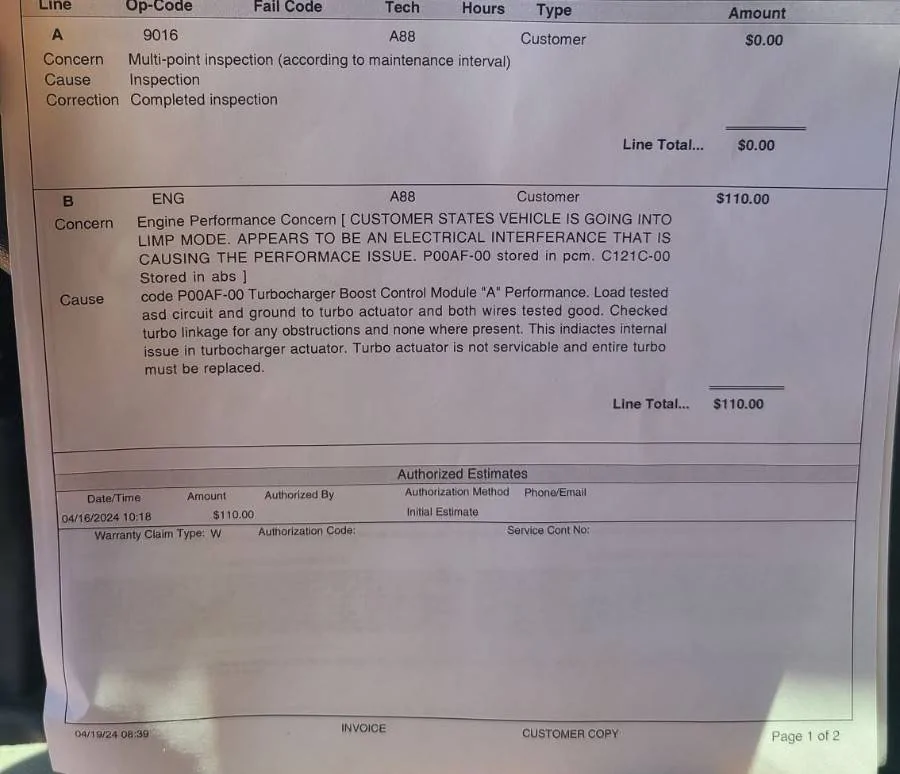

Said I would post exact what there service provider said a couple days ago sorry just getting to it.
Jeep cares said they are going to open a case but they are slow moving I get one message a day from them so will see how it goes. But it clearly says turbo needs to be replaced so it should be covered.

UPDATE:
JeepCares just called me. Dont have high hopes. She tried to say the emissions warranty is no longer valid since I am over 70k and I asked her to explain to me why If a turbo has to be replaced and it clearly states in the powertrain the turbo is covered why is it not falling under that.
She put me on hold and came back and said it could be a few things. It could be a certain part and not the actual turbo itself, or it could be from an outside influence. I asked what is an outside influence supposed to mean.
She said they would have to schedule a service appointment to determine that. I told her that has already been done they stated clearly on their paperwork the entire turbo must be replaced and there was no outside influence mentioned in the work done. She said "oh" like she didn't know it had already been for service and that she would call them and get back to me in the next 2 business days.
She was trying to offer me some copay or something for the part and work.
Not feeling too confident. So far they seem incompetent and the fact they can't clearly explain to me why an item clearly stated in the powertrain isn't being covered for some reason with a clear valid reason is very annoying.

@AXISJT, I would suggest taking it to a different dealership. Without a question, the turbo falls under the 5 year/100,000-mile powertrain. Your dealer is either too incompetent to submit the warranty claim to the area warranty manager for approval or the area manager denied warranty until the dealer tech follows diagnostic procedures.
Another dealership might be more competent.
Spoke to my service manager this morning for an unrelated issue and asked about the turbo warranty, they stated it's 100% covered under the powertrain warranty. It's not considered an emissions component.
100% agree with Biodiesel, find another dealership. This one likely just does not want to do the work or has no idea what they're talking about.

Frankly I'd not want them working on it anyway if they are trying that hard to make the customer go away or pay extra. It's sounding more like one of those times where a shop will make it so difficult that a customer leaves - because they don't know how or don't want to work on a diesel engine.
