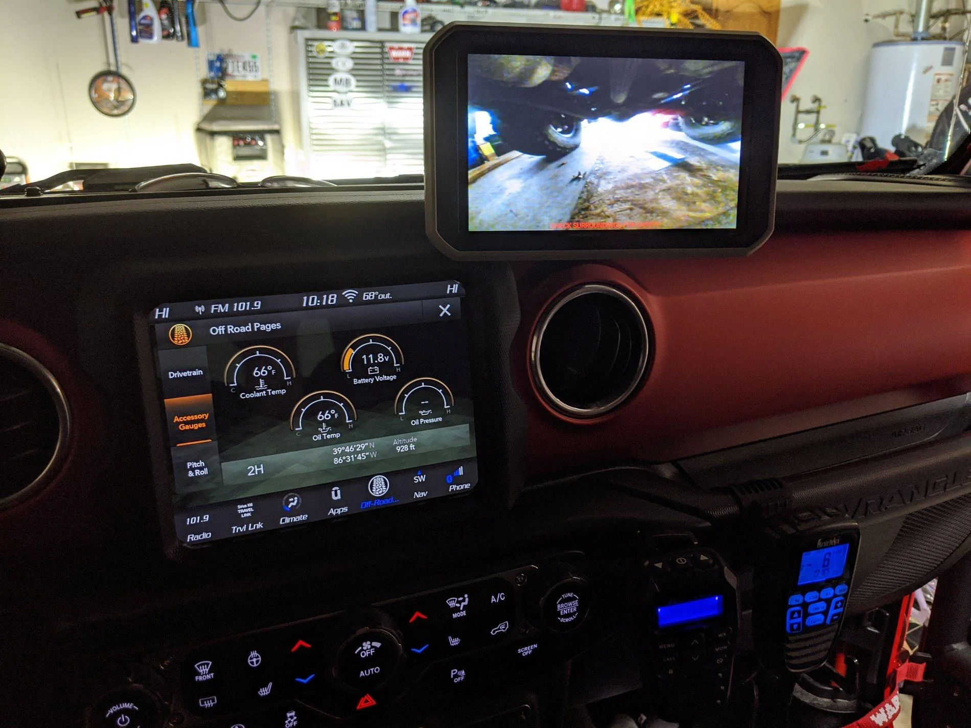

Garmin BC 35. I found it at $138 on Ebay. This is the view it had before I clobbered it. Ultimately, I'll do another down there but will figure out a way to get it up and more out of harm's way. I was able to place the tires very precisely with this view. It isn't a substitute for a good spotter, but is VERY helpful when no spotter is available.
Also, the wires for the camera are very small guage. So I used plastic protectors on them. I may try and do something more to shore them up a bit. Not sure why Garmin went so fragile with them, other than the fact the power draw on this camera is almost nothing.

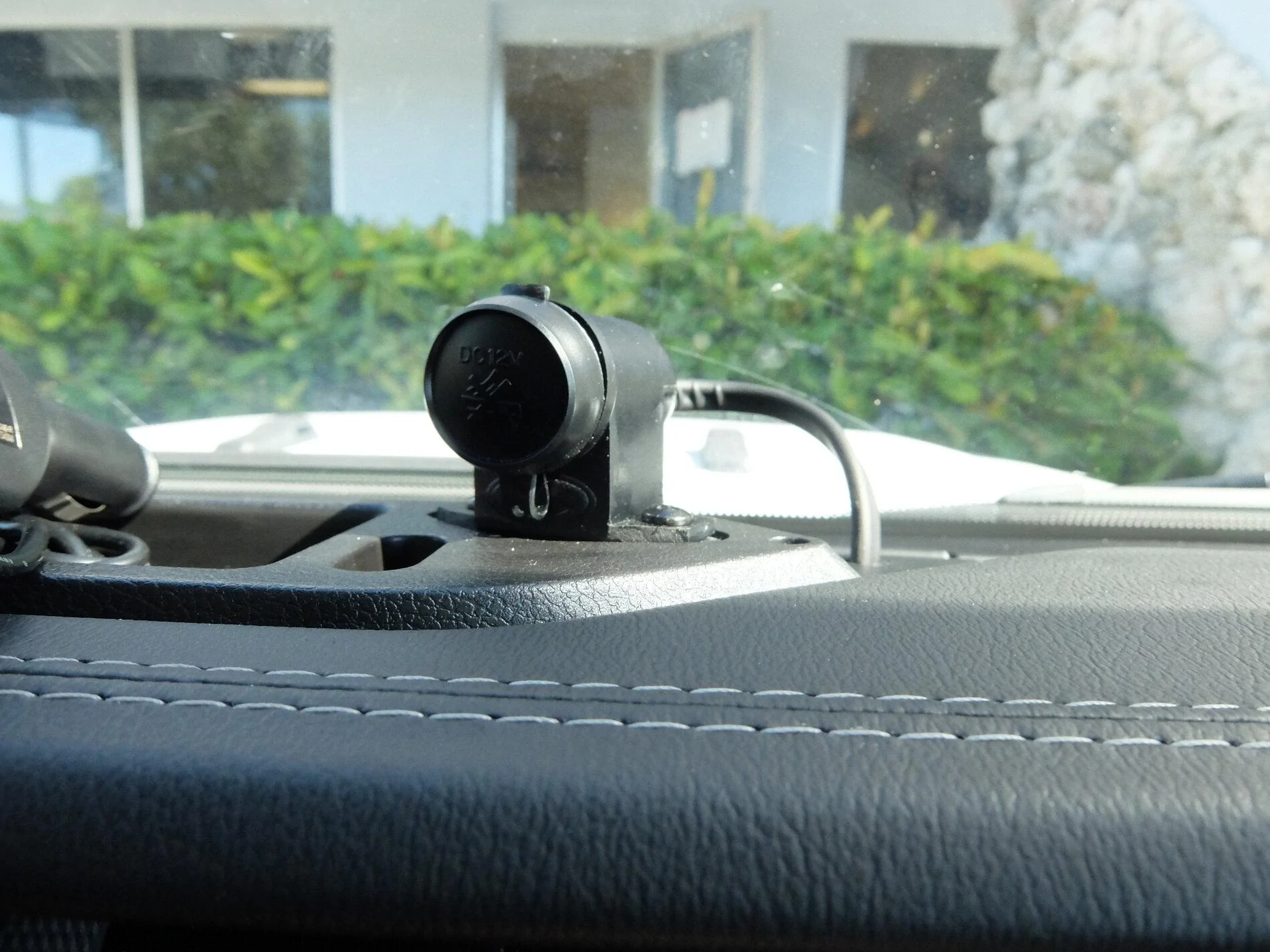

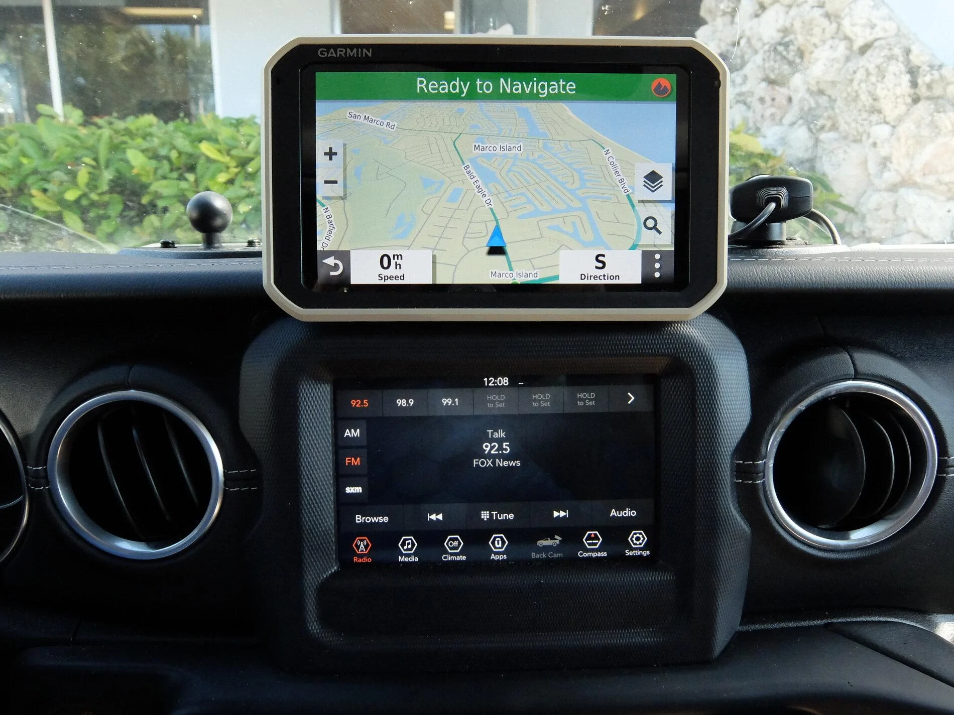

I bought this, and like a lot of Jeep aftermarket, it is overpriced, but nevertheless I'm glad I got it, as it looks like it is an original part of the dash. It has three different places to attach the RAM mount; I chose the center. This places the 7" Overlander screen immediately above the 7" radio screen.
I also mounted a 12v receptacle on the Voswitch, with hidden wiring down to the the bundles below on passenger side. So I don't have the Garmin power cord running down to the 12v receptacle below the A/C controls.
With the Garmin magnetic mount, it is simple to pop it off and stick it in the center console.

Nice setup! Cleaning up the wiring is on my short list of things to do soon!

Cord management is big for me also, can’t stand exposed wires. Did you drill into the dash or run it along the glads to the side and then down?
This proved easier than expected. There are two triangular plastic pieces on the dash on either side of the tray. On my JT, the one on the left has a small dome that probably does something. The one on the right is plain. I found with a sharp small flat screwdriver I could gently pry it up. Part of the defrost vent comes with it.
So I drilled a hole in the flat part. Underneath there is what looks like a plug-in connector in the plastic, but unused. I drilled right through the center of that. Then it was easy to use a stiff fish wire to get my conductors down below. Came out right behind the glove box. I connected to the 10 amp battery wire (not one of, but bundled with, the aux switch circuits).
