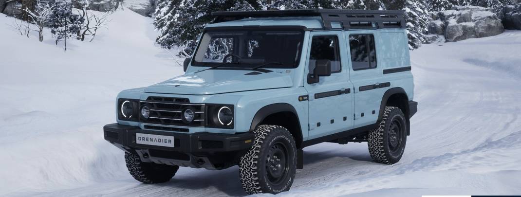

I was in this camp too, if the 4xe came out I was going to trade my gladiator. But now a few things have changed and I placed an order for a different rig all together. So fingers crossed that the new rig lives up to the hype.
You’re living my dream! Please, please, PLEASE post a report with many pics when you get it!??????

I will, it’s at least 18 months out, but it suits my job better so hopefully it’s as good as they say it is.
