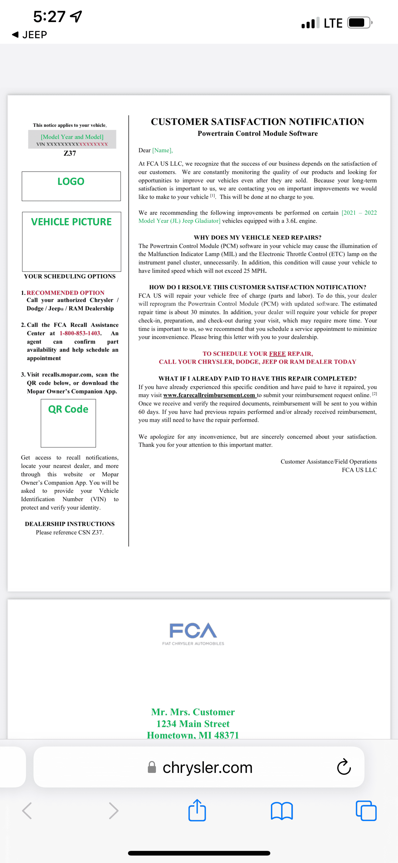

Has anybody seen the throttle body recall for 21-22 gladiators. It says it effects the throttle position sensor and can cause a check engine light that will cap your speed at 25. Has anybody ever had this experience? I’ve never seen it

Yea it’s a “Customer Service Recall”
Jeep Gladiator Throttle body recall for 21-22 gladiators C8AD5D10-F955-466F-A298-320B0BB7F29C

That does closely match the TSB description even though the TSB calls it limp mode - this is aimed directly at customers so they won't use limp mode, they'll just say it's going to limit your speed.
Apparently they have found the issue and are contacting those with the impacted VIN directly.
I'd bet it's an RTT.
Symptom/Vehicle Issue: The customer’s complaint may include a MIL or check
engine lamp-on condition. The customer may also complain of a lack of power (vehicle
potentially in limp-mode). Upon further investigation, a fault code for P2100 -
ELECTRONIC THROTTLE CONTROL MOTOR CIRCUIT along with other fault codes
may be set in the PCM.
Customer Complaint/Technician Observation:
Check for any additional codes that accompany the P2100.
If P2101, P2110, and/or P2118 are also present, follow the published diagnostic
service procedure for P2100.
If none of the faults mentioned above (P2101, P2110, P2118) are present with the
P2100, clear the P2100 and test drive vehicle for 10 minutes.
 If the P2100 does not reset, return the vehicle to the customer.
 If the P2100 reappears during test drive, follow the published diagnostic service
procedure for the fault.
Engineering is investigating an issue for an intermittent P2100

Mine was in the 32,000 group and I had it performed today.. I never experienced this in 10,000 miles. Have a great dealership took about an hour from arrival to exit..Gotta get in line to get in the shop.

Had an appointment yesterday for my oil change and the recall popped up the day before, so I went ahead and had them do it. It's just a reporgram/flash, they did it while they were changing my oil, I didn't notice any difference in the way it drove on the way home. From what I saw it was causing some Jeeps to lose power on the interstate, which I never had a problem with before.

You shouldn't notice any difference at all unless you had the problem. It doesn't do anything but prevent the problem from what I've seen - and it doesn't appear to be widespread but it would be frustrating has @#$%!# if it did happen while in the middle of traffic on a busy interstate.
